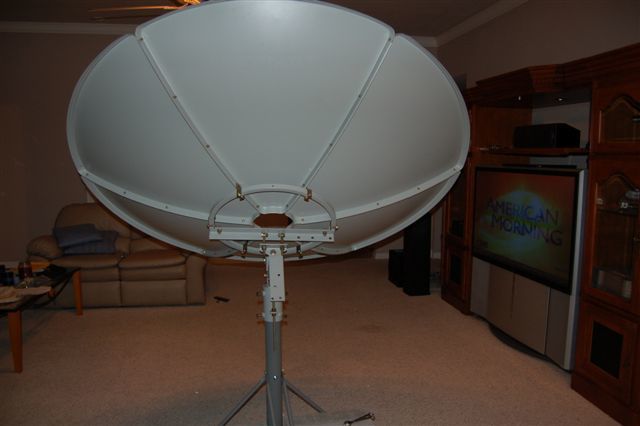

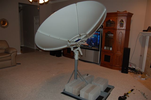

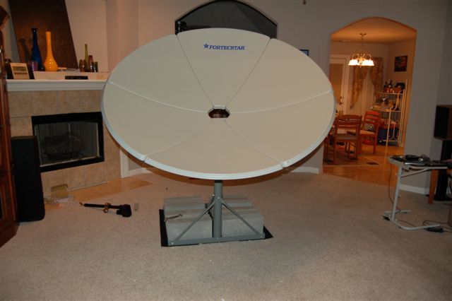

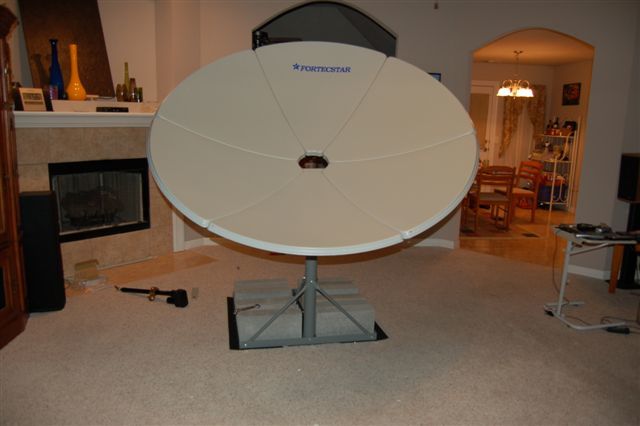

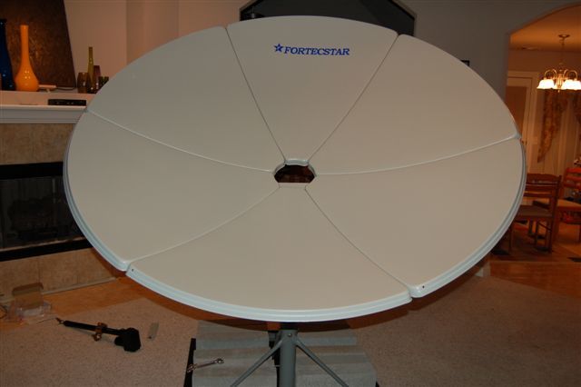

After fighting for hours with the lack of instructions that came with my new fortec 6ft dish polarmount.They have the worse instructions i have ever seen.I finally got a rough draft of what it should look like once assembled.Let me know what you guys think?

Stats8 said:
Very nice! How about a photo of the polar mount side?:)

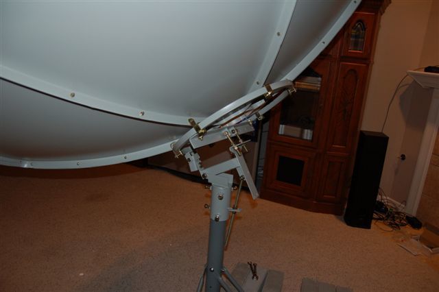

Here are some from the back

cool :)
quite interesting that you have a non penatrating mount (and concrete blocks) in your living room :D
Now ya gotta move all them blocks up to the roof!! Good job on your setup.
My patience level lacks when it comes to projects that are frustrating with bad instructions. That is changed by my desire to scan the skies, so it's worth it to me. That's a nice looking dish.
Thanks for the pic's.
It looks like a solid polar mount, are you going to mount the dish on a pole, or keep the present stand?
Have you applied the string method to get the panels in exact aligment? if not, do it, otherwise it will not perform.

It will me mounted on the non pentrating stand on the ground but not on my roof.

I think that polar mount is part of the package for that dish.
Not sure if it is sold separate?
It is the same dish sold by Sadoun, but you will have to purchase a polar mount and adapt it to the dish, there is a bit of work involved.

Nice looking dish.
However, I believe I'd turn the dish around where it's weight is suspended over the ballast (concrete blocks). Otherwise, you're giving the wind the mechanical advantage by allowing it to use the uprights as a lever.
Harold
Nice looking dish.
