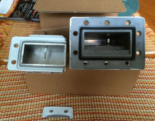

Could you take a photo of the 8115 and the Precision LNBs? The only thing that I can think of is that he tried to install the C-band LNB onto the KU waveguide?

Brian, I will get a pic of the 8115 and Precision LNB to show you. I know he didn't try to install the C-band in the Ku waveguide because he never got the Ku LNB off.

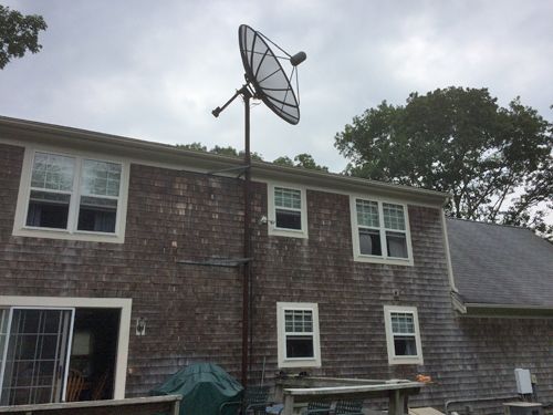

I know you probably already posted it up, is this the 7.5 KTI in your signature? How high up is it? Could you maybe post a picture of it?

A Raine...My dish is approx. 20 feet off the ground and I will be posting a picture of it soon.

Brian...here's the picture you requested. The newer Norsat is on the right.
A Raine...here's a pic of the dish and its location you requested.

It sounds like the elbow has been removed from the feedhorn at some time. Had it been in place it shouldn't have been a problem putting on the norsat.
Wow, that is up there! Thanks for the picture.
I'm not way far away from you [ northeastern CT] and was thinking I might be able to help you take it down to relocate it somewhere lower down, or help fix it, but that's a little high for me nowadays to spend any length of time up at. On good days I can get up and down a ladder fine, but going up and down that high would be pushing it a bit out of my comfort zone, nowadays.
Really stinks to get old and not be able to do what you use to always be able to do. I can always tell when my legs are going to act up and up one story, I can get down safely in time. Up two, probably not, I'd be sitting up there enjoying the view all day, or sitting halfway down the ladder, if they did act up. There's been a few times I've sat up on my roof enjoying the view most of the day because I've stayed too long working up there trying to get stuff done with my antennas and stuff. :(
If you do have a place that it can be put at lower down, maybe a couple of eye hooks into the eaves on either side of it toward the edges of the house with ropes going through them to the pole and then notch the front of the pole out with a saw a bit, remove the brackets holding the pole and lower it down part way, notch the pole a little higher and lower it a little more, so on, until it's low enough to handle? Probably would need a few fairly strong people for the ropes, or a few winches?

Have any friends who work with your local electric company? A bucket truck could hook a chain through the polar mount and lay the whole thing over in short order.Be much safer than trying to lay it over with support ropes.That dish doesn't weigh that much AT THE DISH.(I have one just like it) But the weight multiplies on a long pole once the tilt gets around 65 degrees and less.It's the Lever Principle in reverse.
