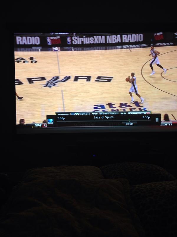

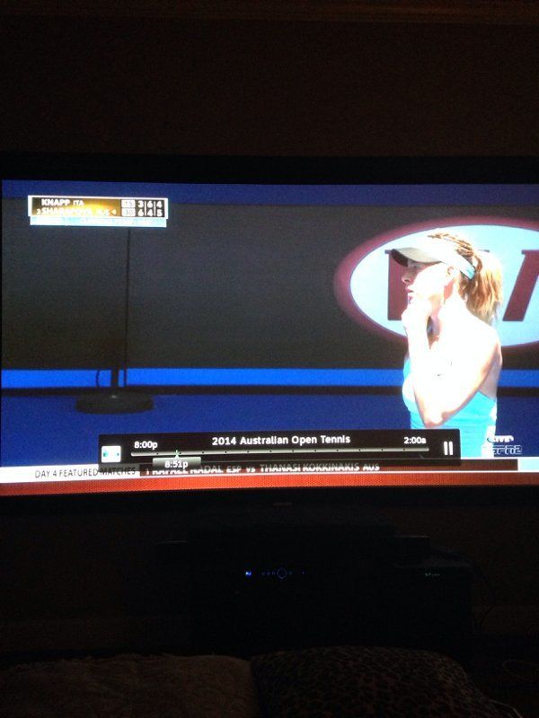

That's the good thing about the high power screen. Light from the projector goes to the screen then back to the projector. Little ambient light will not wash out the picture at all.
With lamp on the right and light from kitchen on the left. Can you see any ambient light:) image-2566619812.jpg
Thats def bright!
My only concern for light will be kitchen thats off to the right and behind us. When the wife cooks and the floods are on, its kinda bright, but to be honest, it washes out the plasma too and thats rare.
