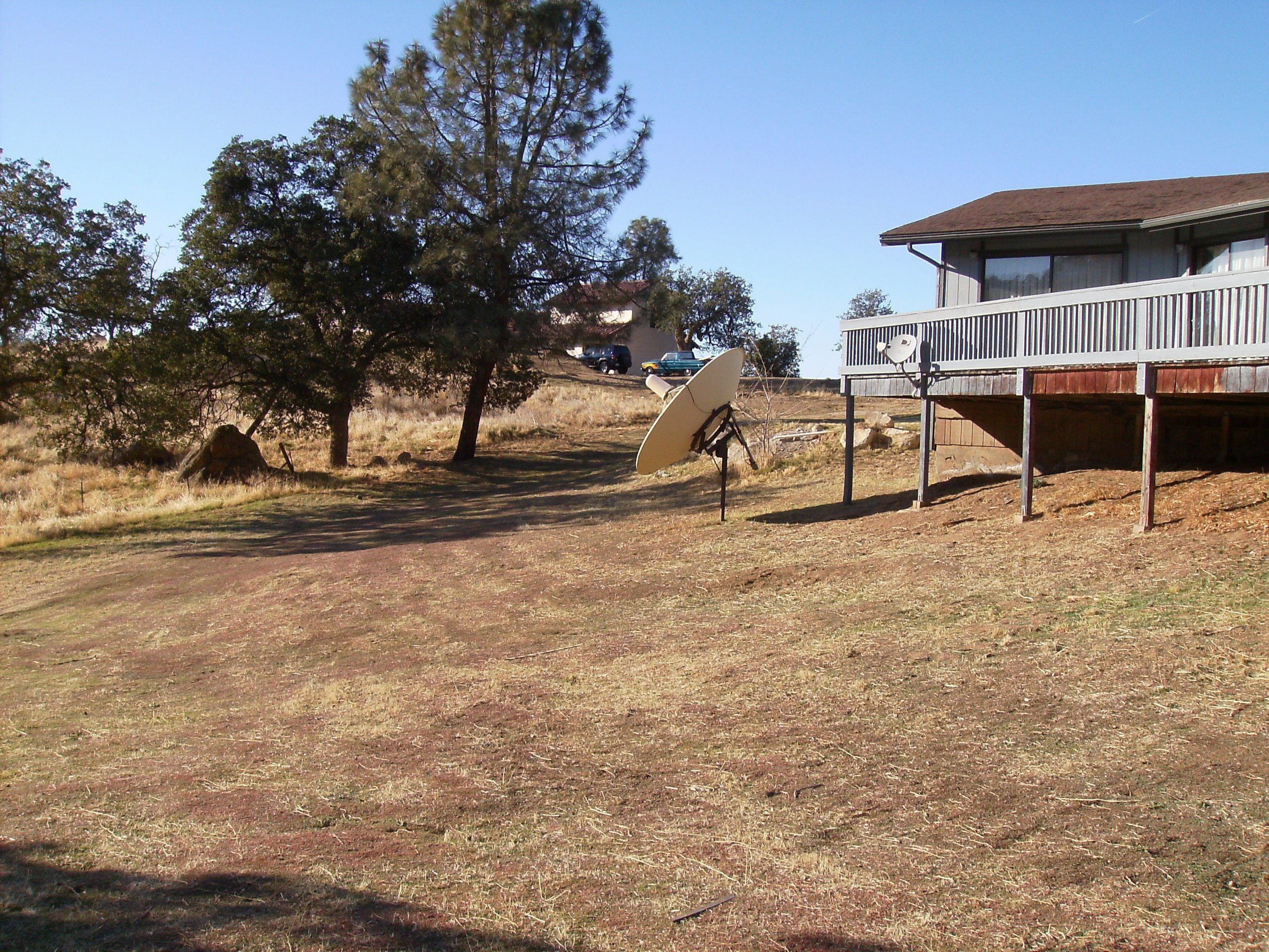

Yay!! I'm so excited to think about the possibilities of this dish. :D I have one pic here . Sorry it's kinda far away....what do you think? (click on the thumbnail and you can see it pretty good)

Thanks, Nikki - good picture.
Now, get us some more from various angles, the front, the back, etc.
Take a look at the hardware on the back side of the dish, and look for heavy rust.
Moderate rust is probably okay.
Look especially at the motor and get pictures of it. - that's what'll move the dish from east to west.
How large is the dish?
I'm guessing 6', but those should be 8' or 10', more often.
Eight feet would be dandy.
The cover on the feedhorn on the front side of the dish could be removed and more pictures taken.
But if you do, be warned there might be wasp nests inside, so proceed with caution.
Basically, I'd say you have a dandy dish there.
It can most likely be put back into service.
Which service and for what sorts of programming, well, that's up to you.
If you have a clue what sort of programming would appeal to you, please share.
- east coast network?
- religious programming?
- PBS ?
- sporting events (wild feeds) ?
- foreign language programming (often with news in English) ?
All the above can be had for free.
For HBO and such, then we'd direct you to a 4DTV receiver, and a subscription service.
As we get more info, the members here can guide you with more specific suggestions.

That looks from the pic to be a good dish. You may need a new actuator motor and you are going to need a positioner. A positioner can be an old analog C-band receiver or a V-box or G-box. If you buy your parts new you will pay a little more for them, but without subscription costs you will quickly get your money back if you are happy with FTA programming.

Congrats on the dish. You may need a new updated more modern Lnb and feedhorn (depending on what is on the dish) - get us some pics of what is under that feedhorn cover.
worst case scenerio (me guessing site unseen)
New actuator motor 140.00
New lnb (ebay) 30.00
New coax 40.00
New actuator wire (I use thermostat wire 4-conductor from lowe's or home depot)50.00
analog receiver (ebay)50.00
FTA receiver (ebay) 50.00
assuming the dish is good and the mount is still good,
that should get you going - rough guessing.

From looking at that photo I would say up in the mountains near Bakersfield. ;) The PhaseIII dish should be centered on 110°, so the BUD seems to be pointed way West. Assuming the tree on the left (shadow at the bottom of the photo) isn't blocking 101° for DirecTV I would guess the nets on 99° should be ok, though the PhaseIII is slightly higher and further back. Also the reflection in the sliding glass door shows nice LOS off to the Southwest, but a larger tree (presumably the shadow caster) to the South/Southeast. Since it is a Phase III it would have been working sometime after 2002. I don't know how fast those trees grow in 6 years.
I don't see any sign of an OTA antenna on the house or the neighbor's place, though the trees are blocking the outbuilding to the left of the neighbor's place. I'm guessing it is too remote for easy OTA reception. Unless it wasn't remote and rabbit ears worked. :)
Anyway, I would say take a compass along and get a some photos on specific magnetic headings like 120°, 166°, 210°, all from as close to the dish as possible.

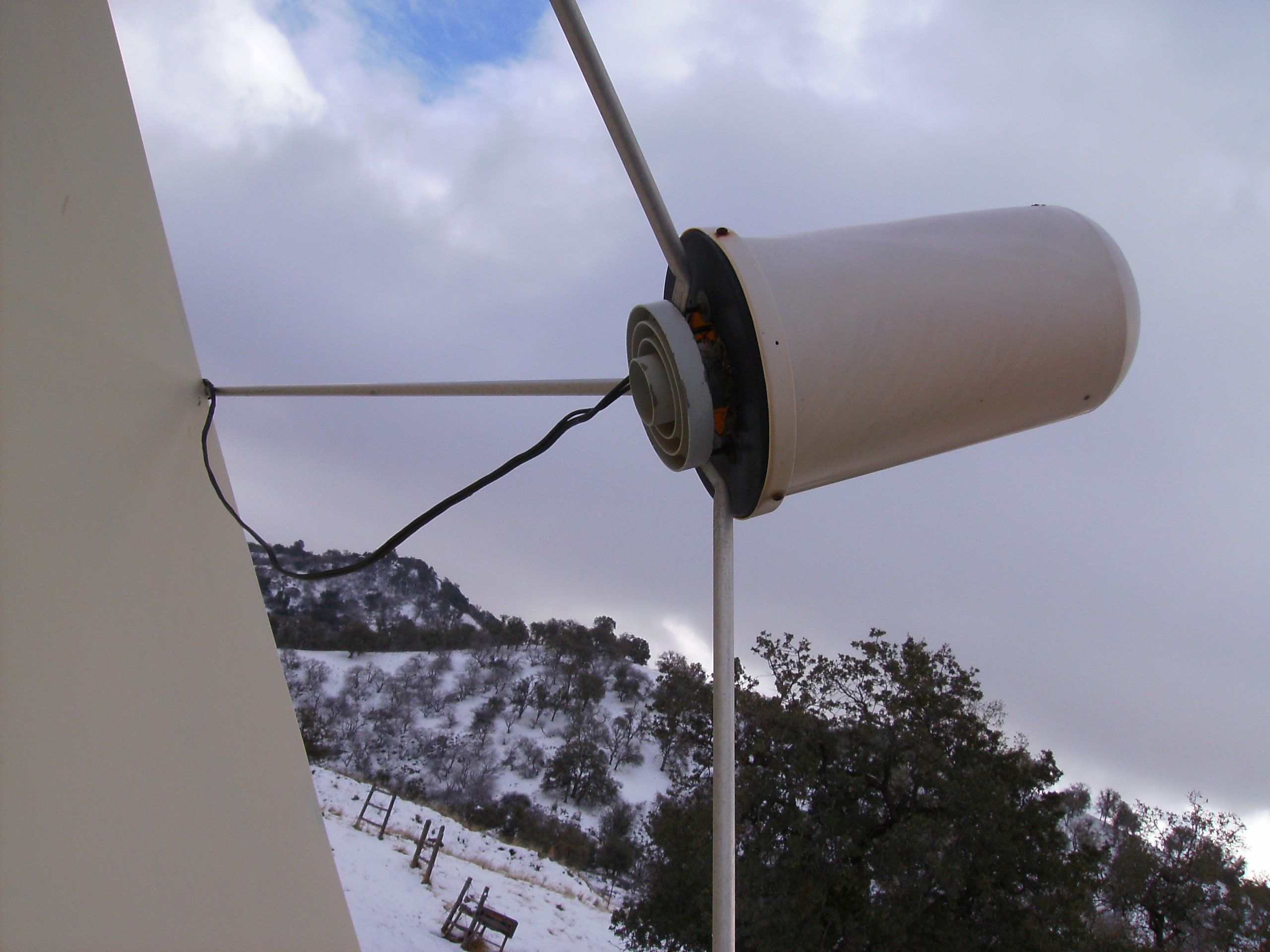

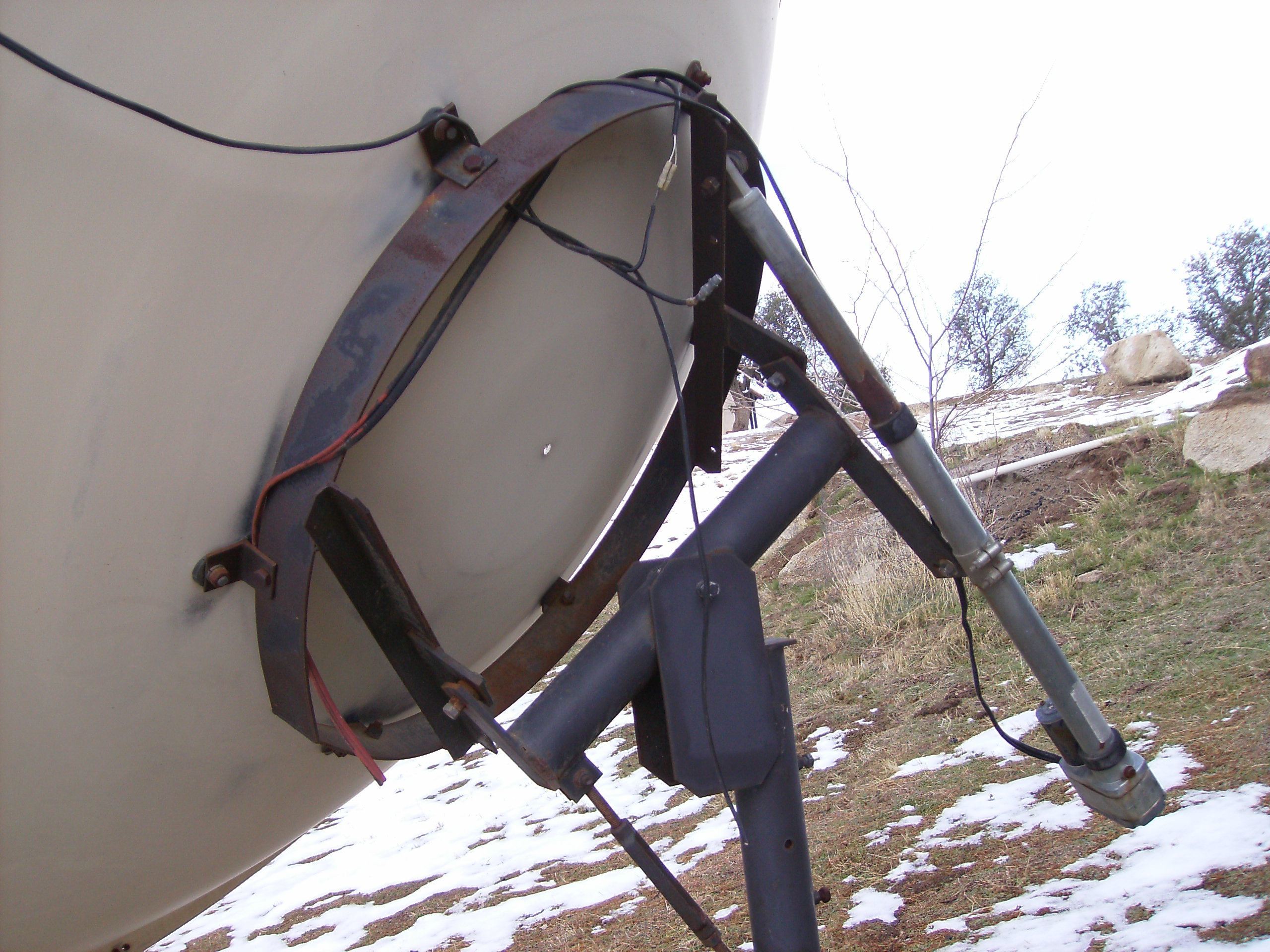

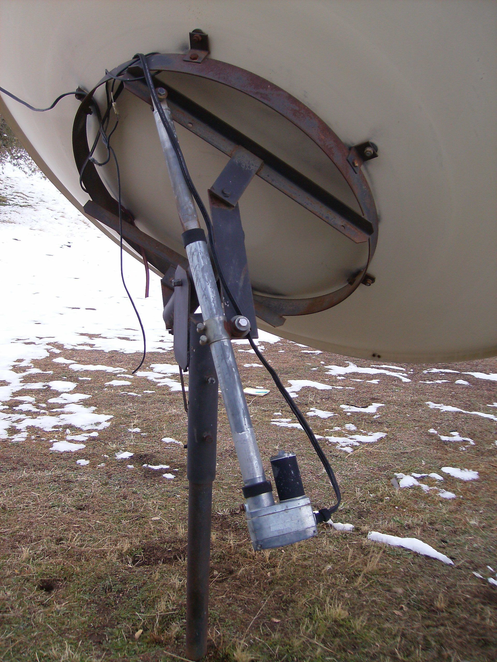

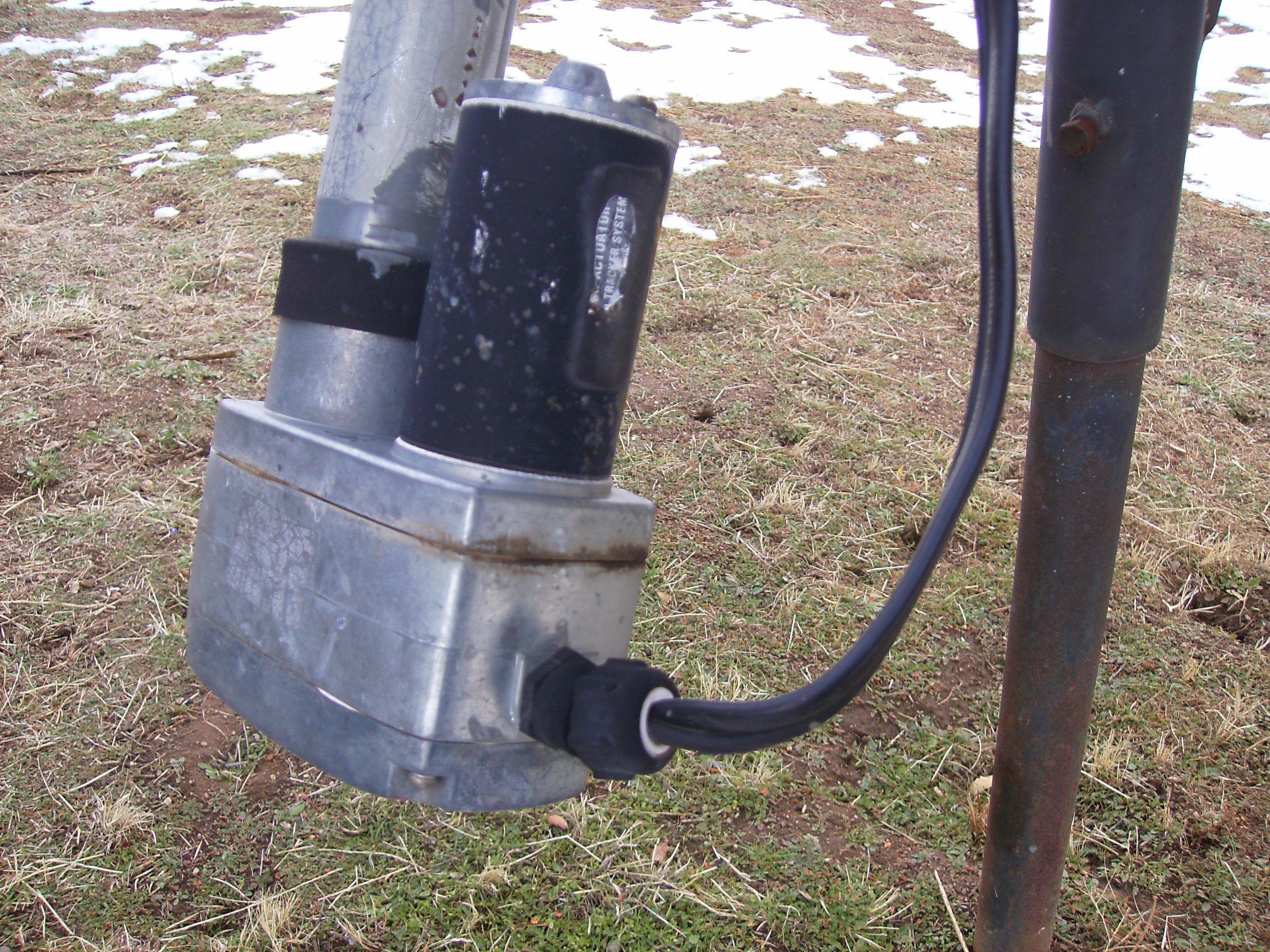

OK, I took more pictures....check them out. AND, I spoke to an old-timer at Radio Shak and told him about the dish. His words? "Don't waste a dime putting any money into that thing. NO, your picture won't be any better, you'll be wasting your time and money". I guess he used to install those kinds of satellite dishes. He told me it's made of fiberglass (?). I knocked on it, and it seemed like some kind of metal to me, but I have NO clue. Well...check out the pics and tell me what you think! :p
