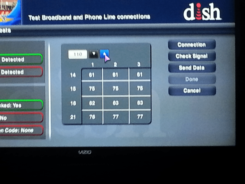

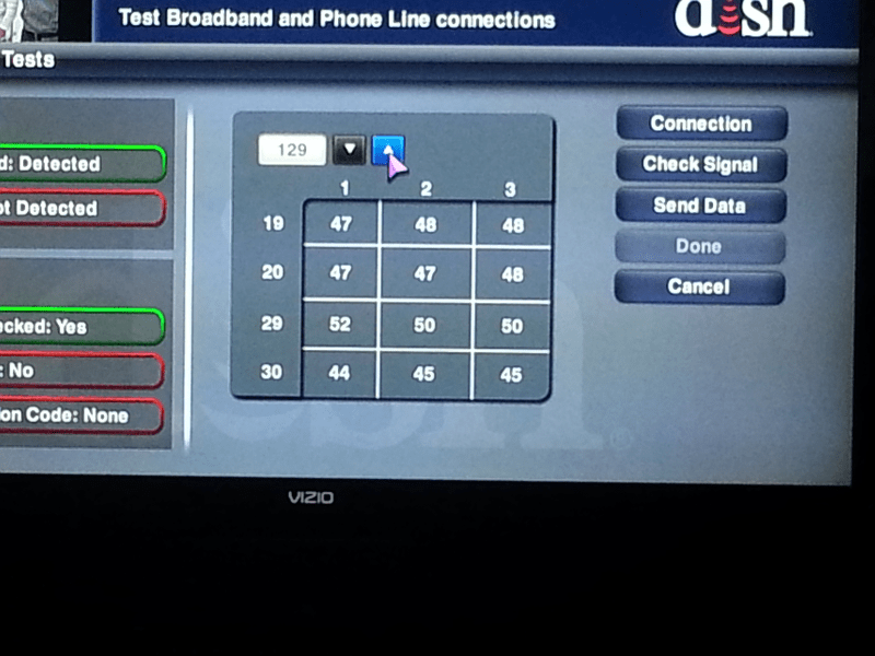

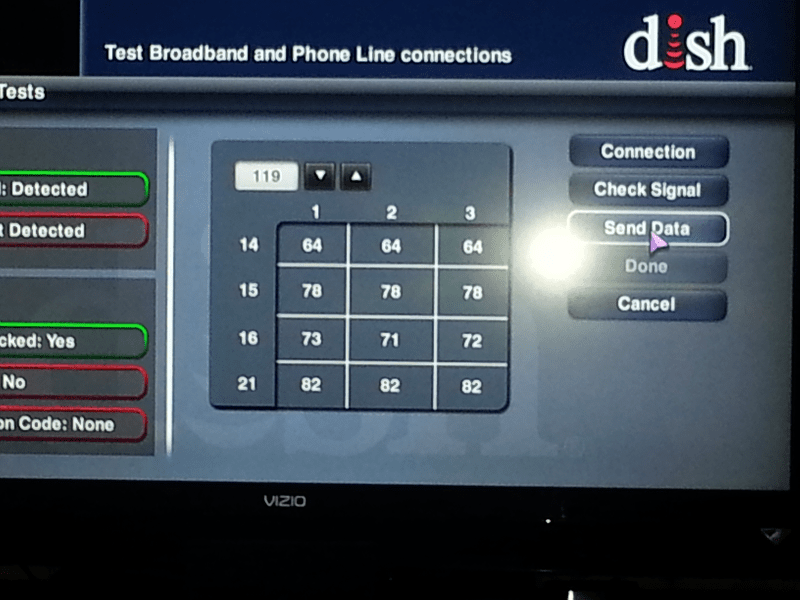

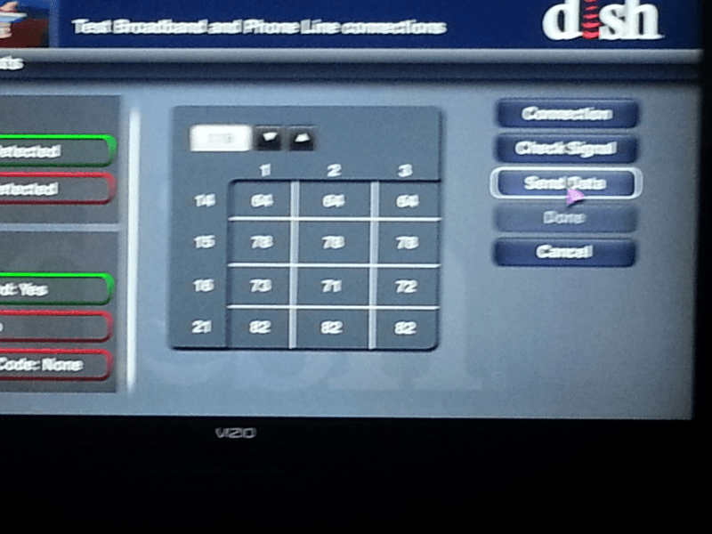

Do you get any error messages when you run a check switch test? What are your signal strengths?
I ran the check switch test and everything was fine and no error messages. I will try and post my signal strength below.
