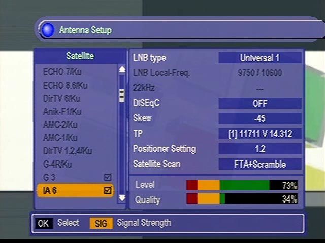

Check everything-screens like this have to be just right, except with the proper information for your setup of course.
