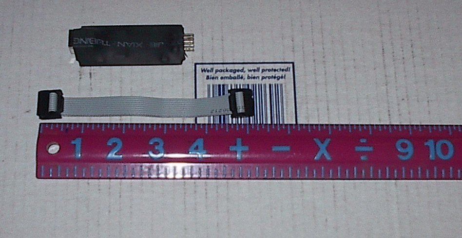

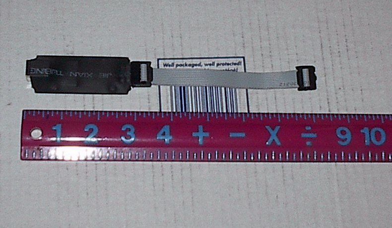

tvropro, when I click for a larger image, the BDM adapter looks like it has a 10 pin header cable plugged into it. Is that right? Meaning, does the cable unplug from the adapter?
The reason I ask is because the cable in the picture doesn't look long enough to reach outside of the case. If it is too short and if it unplugs, that would be no biggie because we could just use a longer header cable.
We have already discussed in the past that it would be best to not leave the adapter plugged in for normal operation. I believe it was you or Lonewolf that indicated routing to the slot behind the front cover. Is the included cable long enough, or do we need to look for a longer one?
Also, stargaze asked if the end user would be able to create/edit our own maps. I would be interested in knowing this as well. But I understand if it's too early to answer that one.
The cable included is too short and is a 10 pin cable. You would need a longer one to place it behind the TVPasscard door. See pictures attached, the stock cable is 5 inches long.

The alpha beta can combine maps that you set the parameters in in a text file & load. Will the first release allow that? maybe it depends if the end user can understand and edit right. Any wrong info fed into the 4D will cause a master reset so this is why our focus is creating a total set of custom maps with all that is in the sky that will be easy for most to use. We most likely will have an advanced options tab with more that are up to it. The thing is you have to learn by yourself. We can probably provide the basic instructions to follow and then you take it from there. It may be a good idea for me to create a 4D Map Master user forum at my website that all can discuss whatever once it's released.
