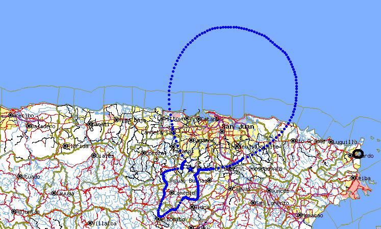

Nel I would like to get the new channels in my Fajardo apartment, I have a 100mile 35db gain directional antenna and I get the USVI CBS st.thomas now called this and ABC st.croix
the black bold circle represents the location of my apartment
just curious if I can get these new networks over there
It's going to be hard my friend!
if its not possible then I dont really mind, I am there only 2 days even sometimes 1 day a week,mostly I am in Bayamon and I need to work on a mount for the antenna
(I have it hanging with 2 cement blocks to hold the left and right side of it)

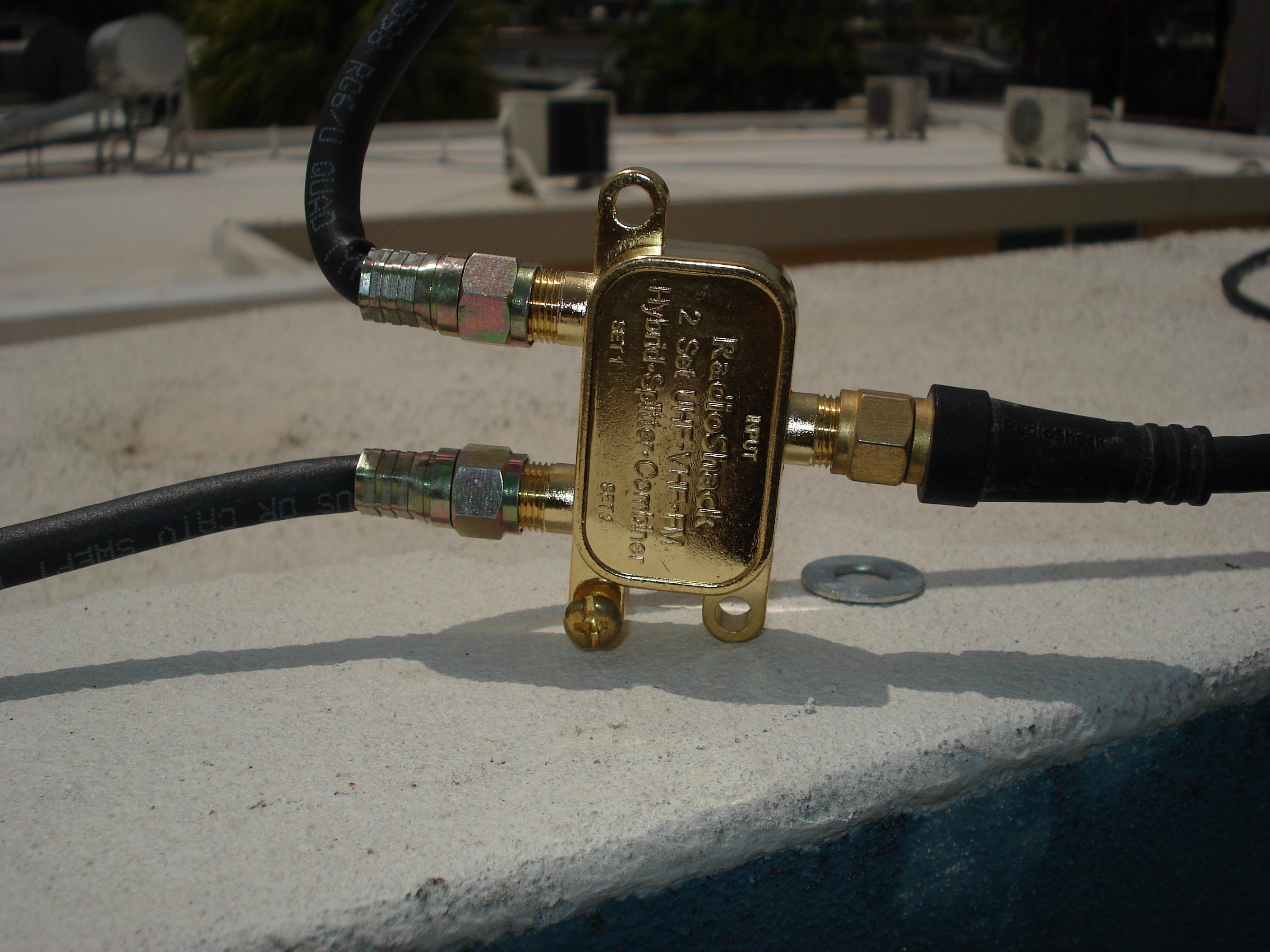

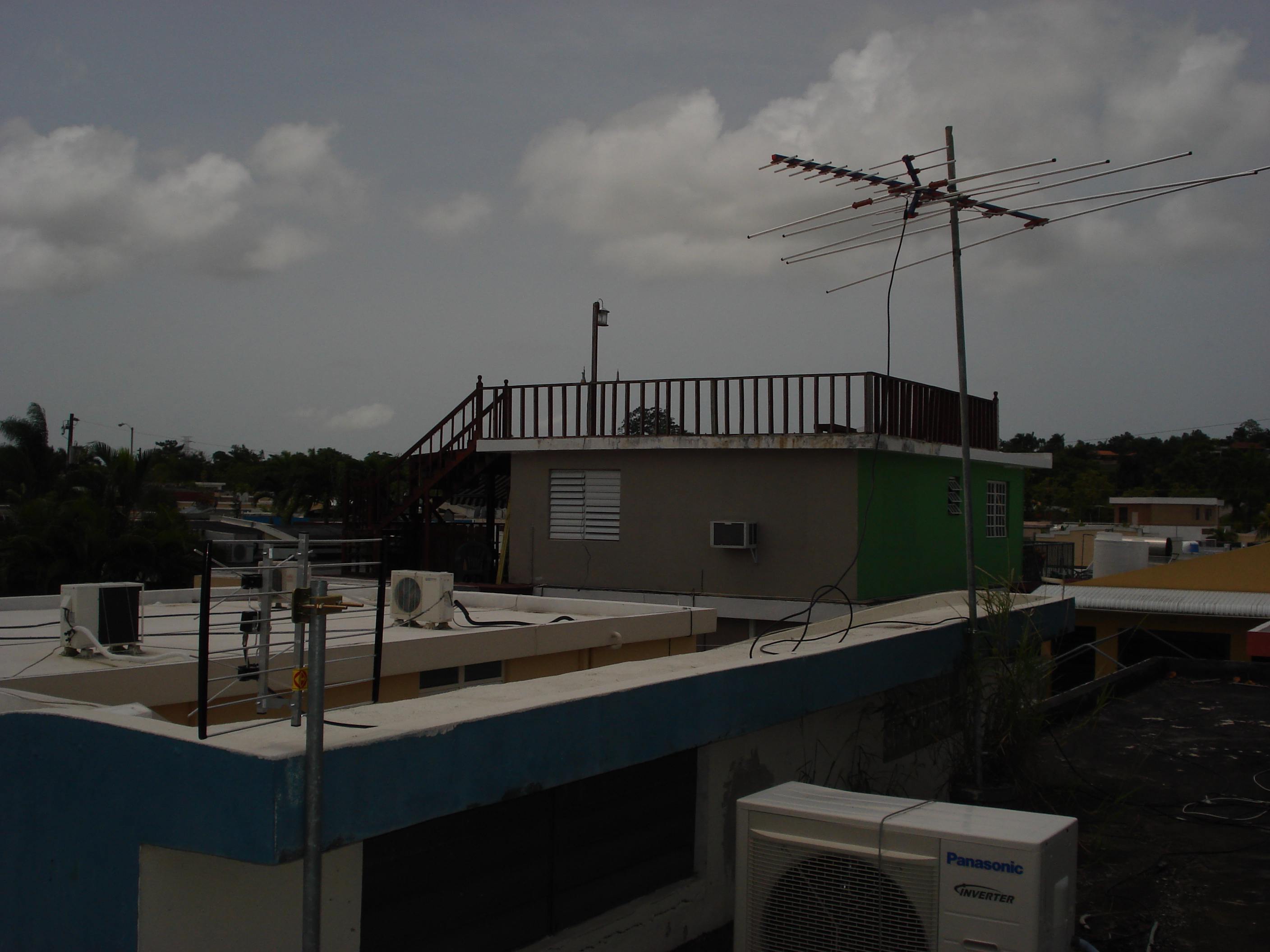

lj i think theres a way tu combine 2 antennas one towards the southwest or bayamon and one towards the south near aguas buenas can you check whats needed?
As far as I know, you need to separate the antennas so they don't interfere with each other reception. And you need to use a splitter, connected backwards. And a lot of luck. :)
These are two sites, somewhat technichal, with a LOT of detail:
Merging feedlines
Combining or Stacking Two TV Antennas - Stallions Satellite and Antenna
Hope this helps. If you do it, let us know. :)
okkkkkkk toooooo much trouble ill just leave it as it is im getting average of 75 on each channel and it works
Ok i went to the roof and tryed it and it works i get 75 % on abc and 87 on mayor chanels like 2 4 6 11. Noting, that the splitter makes the connection -3db plus a couple of diplexers o its way to the receiver wich takes a little more off the signal. but im very satisfied. note: you will have to tweak with the directions of the antennas to get it to work on is looking towards Aguas Buenas the other one to Bayamon
