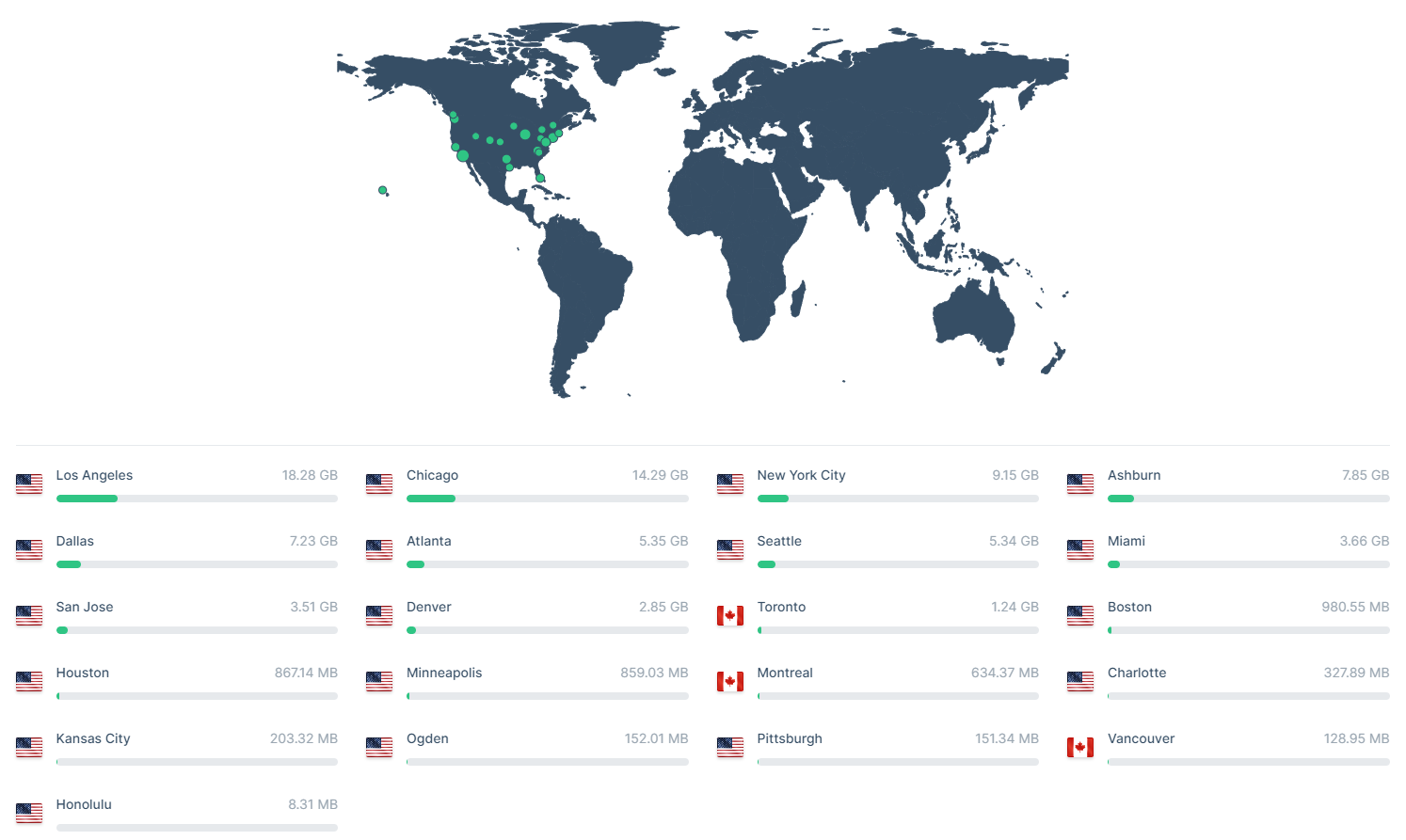

Here is all of our CDN servers and the amount of data they each used so far this month.
You can see how much it saved our main server from serving them to everyone, not to mention the speed benefits from getting the big data stuff from closer to where you are. :)
Data accurate as of 9:20 am ET this morning.

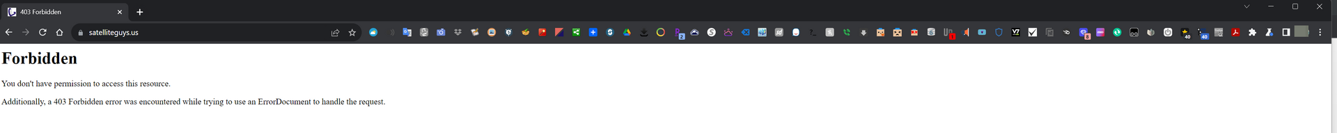

Is this what you are seeing? I am using an android phone. I tried both chrome and Firefox browsers. I cleared the cache and cookies for both and no change.
I am seeing this message on:
Dish Network Support Forum
DirectTV General forum
Cable and Fiber Providers
It has been showing this for at least an hour.
Yes, it is and then after a few refreshes, it will start showing permission denied and that I do not have permission for the resource whether if it was already in the dish forums or if it was satelliteguys.us for the URL
and basically the last time it happened, it was for 10+ hours or until I decide to clear the cache and cookies. The only reason I know this worked even with the old server was after the panic of potentially being banned, I wanted to see if it was any different in other browsers and it worked while the browser with the problem still had the problem until I cleared the cache and cookies for the site specifically so it seems that there is something in the cache and/or cookies for satelliteguys.us that is holding that data but once those are gone, I can access the site but just not logged in and browse and I can login and not have problems. I kept thinking no one else had the issue as no one mentioned it even after 3-4 months.

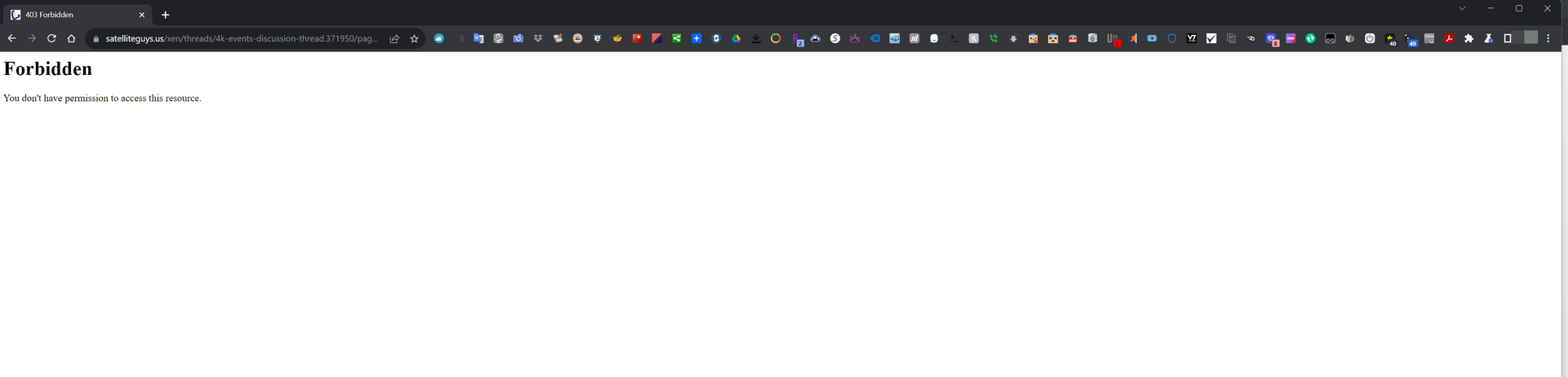

This is actually the issue I am seeing which I have just experienced.
At 2:53PM PDT (GMT -700) today on September 12, 2023 or 12 minutes ago, I was on the DISH Network Support Forum and then clicked on one of the threads with the URL:
and this is what it showed:
Going to satelliteguys.us shows:
Refreshing the page with Ctrl-F5 didn't make a difference. Had to clear the cookies and cache in Google Chrome before it would work again except ofcourse I had to login again.
After I posted this message, it seems like for the next 8 minutes or do, the site was timing out even when I closed and reopened the browser tab.

It appears to be the firewall blocking you but why is the question. I will try to look at the logs when I get a chance and see if I see anything.
That's the one I seem to experience once periodically with the new server which is probably like the 3rd or 4th time so far. Seems to only blocked if I am logged in as logged out, it will show the forums fine and ofcourse it will work correctly after I login again.
