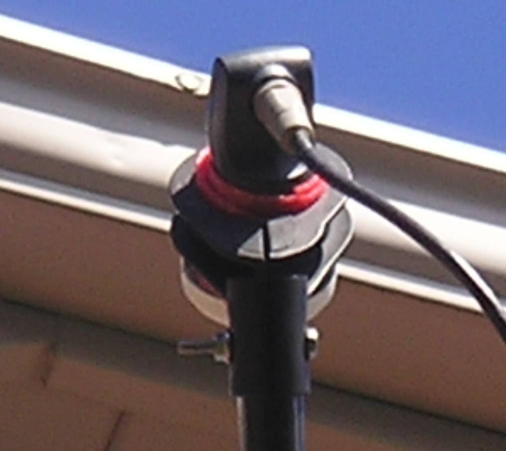

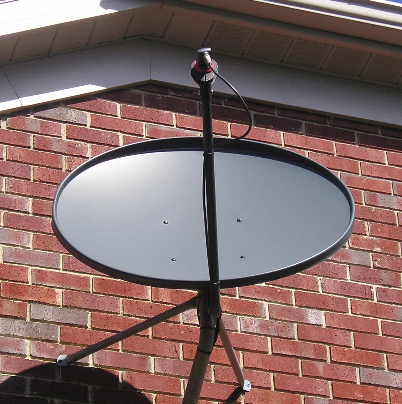

i just installed a new LNB but my signal quality is still the same at 30% for 11965 i skewed but the most i got is 30% what is the signal quality for 11965? Is 30% the best on it? i get about 50% signal quality on the rest. how do upload an image? it keeps saying that it is an invalid image but it is a jpeg 1296x1302 and 354kb.

I guess you have also tried moving the LNBF closer and and further away from the dish to adjust the focal distance (While watching the signal quality)
Looks like an old BJUP dish :) (Or DTV International?)
These are VERY prone to warping in my experience!
From behind the dish pull on both sides gently to see if your signal quality changes, if not do the same top and bottom!
Every one of these dish I have installed has been warped, they used to come with two support arm, using them made it worse!!!!!!!!!
Also make sure that you have not overtightened the four bolts holding the dish reflector in place! Hand tight then half a turn with a wrench is MORE then enough!

my current dish is an elliptical dish would that affect the signal quality?
The dish you have WILL work fine, it just needs "un-warped" as per my instructions above! Its a good big dish!
It maybe an idea to remove the reflector and place it face down on a flat surface like a table to see if its warped!
I would try my above suggestions BEFORE buying another dish, but its your money :)
I will also suggest that the dish that you have should be able to be easily fixed. No need to buy a dish at this point. I would not recommend a Winegard 2076 for reception of 11966 as this transponder is experiencing low quality issues at this time that are being most noticed on smaller or misaligned dishes.
The eliptical horizontal orientation of your dish actually should help with rejecting signals from nearby satellites.

I would also try another LNBF if you have one, also try running a new temporary RG6 cable between the LNBF and receiver if that helps snip off all the old cable ends and replace.
