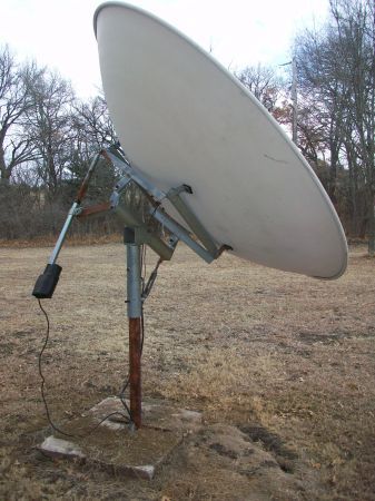

why 4 dishes? can i not put 2+ boxes on 1 dish - and can i get c /ku on 1 dish or is it optimal to separate c from ku -- whats ka band?
due to hoa restrictions i might be using a 1.2m dish -- not sure how it will work , hoa dont like b.u.d.'s mesh.jpg180cm.jpg
this is a 180cm i found with 2 boxes and all acces. for a bill. i found a site(vendor) with one of these that had 5/6 lnbs on it ??????
i also noticed that most " ch list " state dvb - mpeg2 -mpeg 4 and di-cipher and 1 other ?? does microhd support them??

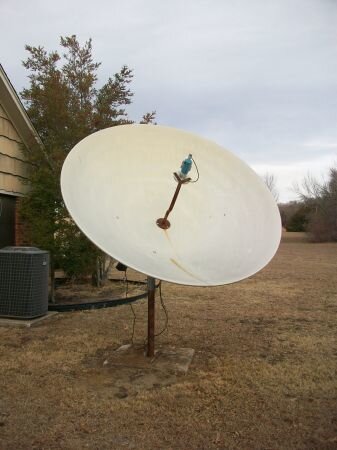

There are many reasons why one might want multiple dish setups. A dedicated Ku-Band dish will receive Ku better than a BUD with a dual band LNBF. C-Band on a 1.2 meter dish is very hit and miss. You will get only the strongest transponders, but if you're in a HOA, you probably don't have a choice. A dual band LNBF will not work well if at all on a 1.2 meter dish.
The microHD will tune all DVB signals including S2. It will not tune Digicipher 2, as those are proprietary to Motorola.

would a 6' work ok if mounted low (ground level ) to keep it at or below fence line? i plan on motorizing a 6' (if i can mount low) and a 180 cm (ku). food for thought.
Sure. Raising it 40 ft does little in getting it closer to a satellite. (LOL) Mounted low may cause line of sight issues with satellites close to the horizon. Pick your location with this, and it's visual 'footprint' in mind.
>>180 cm (ku)<< A 6ft Ku offset dish is a bit of overkill. A 1 meter tracking accurately usually suffices and is protected from HOA's by OTARD. If this is a consumer grade prime focus dish, a 1 meter offset will probably perform just as well, if not better-IMHO. It's all about 'surface accuracy'. 1/8 inch 'out' has little effect on C band whereas @ ku it's a 'bunch'. Commercial dishes are built more accurately.
Keep the 6ft BUD low, and out of site from the street, maybe a camouflage paint scheme and hopefully(fingers crossed) no-one complains.

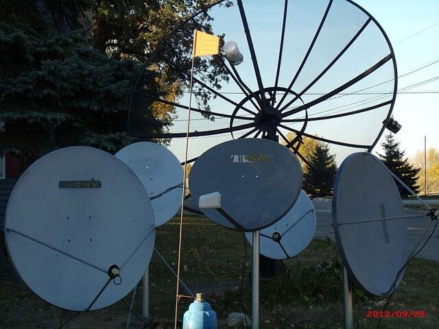

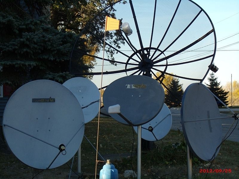

Thankfully, I don't have to hide my dishes. Right out front on the corner just off the sidewalk.
