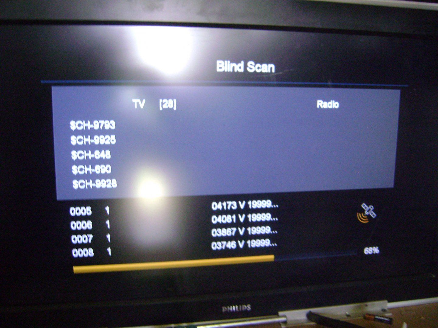

Impatiently awaiting my c band lnbf, but I'm still a little confused. I've found half a dozen sats so far. I can't figure out what all these numbers mean tho. For instance, when doing a scan what the numbers mean and what sat and channel they are on. By the time I've mulled through half a dozen FTA sites to figure what transponder or channel they're on. These numbers are greek to me. Is there a site that can tell me exactly what I'm watching by the numbers in the image I uploaded? For instance, when I do a blind scan, I find some channels are very weak. My assumption is these are actually other satellite feeds. Some numbers in the lower right start with 4 digits while others are 5 digits. I'm thinking the numbers in the lower right tell me what transponder it is in the 5 digits to the right.
