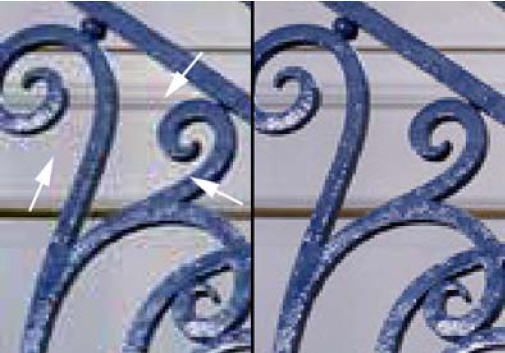

This may answer your question about what Mosquito noise is. I've also added a photo. Click on it to enlarge.
Definition of mosquito noise:
A distortion that appears near crisp edges of objects in MPEG and other video frames that are compressed with the discrete cosine transform (DCT). It occurs at decompression when the decoding engine has to approximate the discarded data by inverting the transform model. The mosquito noise appears as random aliasing in these areas and requires sophisticated detection circuits to eliminate it. As TVs get larger, mosquito noise and other artifacts become more noticeable.
Good thing about mosquito noise is that there are Tv's now that through processing can eliminate this issue. It may at times soften the picture a little bit though. When it comes to OTA I thought the same as you do until I saw 2 of my OTA channels that do major compression resulting in terrible macroblocking. The main ones like ABC,NBC,CBS and FOX I prefer OTA.
