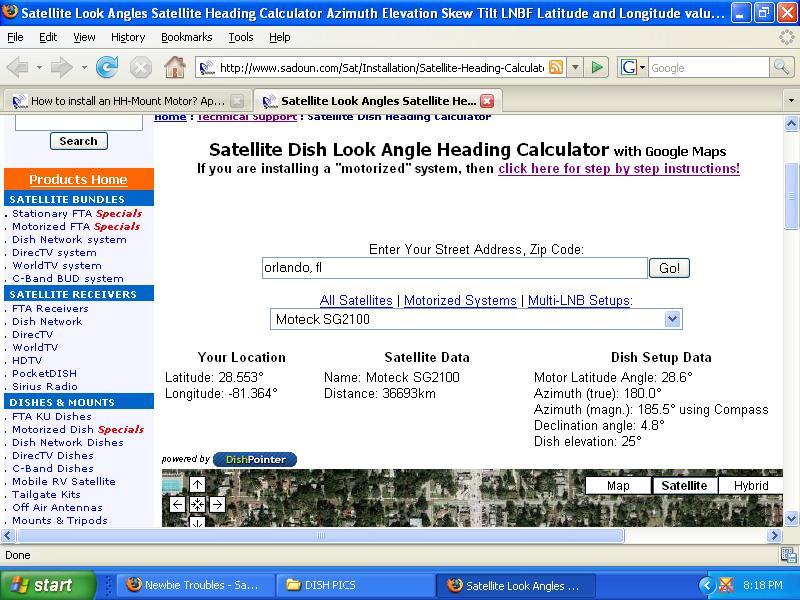

when I checked your info on Sadoun's site I get
motor latitude 28.6
decline of dish 4.8
dish elevation 25
see below pic

Excuse me but you did say you think your latitude should be 28.6 degrees. That sounds odd. Do you really know what your lat and lon are?
he's near Orlando, FL which puts his lat/long correct
So looking at his picture, it looks as if the edge of the metal is to line up with the markings (as opposed to the center of the bolt) if that is true then no problem setting the dish at 24°. So should work as pictured.
