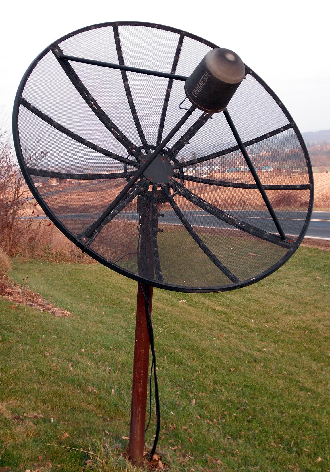

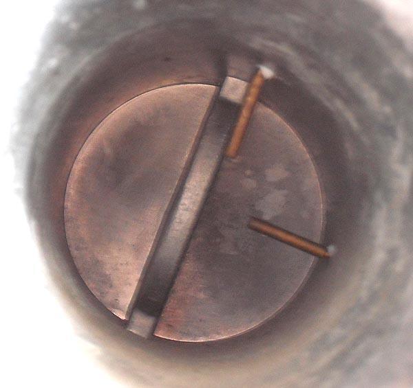

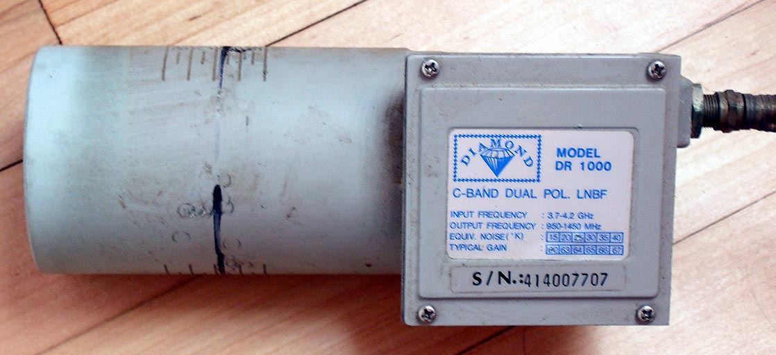

I picked up a Unimesh 5 footer today. The LNBF was missing its protective cap, will it being exposed to the elements for some time have done any damage? Attached are some pics.
Also, what kind of picture quality do you see on NHK?

You should be fine. My motorized 6 foot dish is pointing right at 58 West through a tree and with only 10% Q I get ZERO pixelization.
