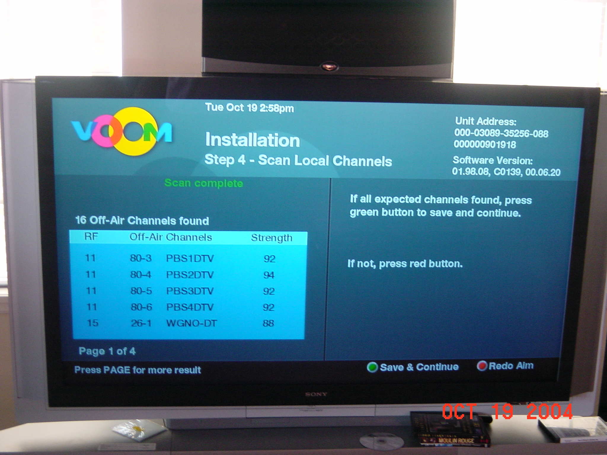

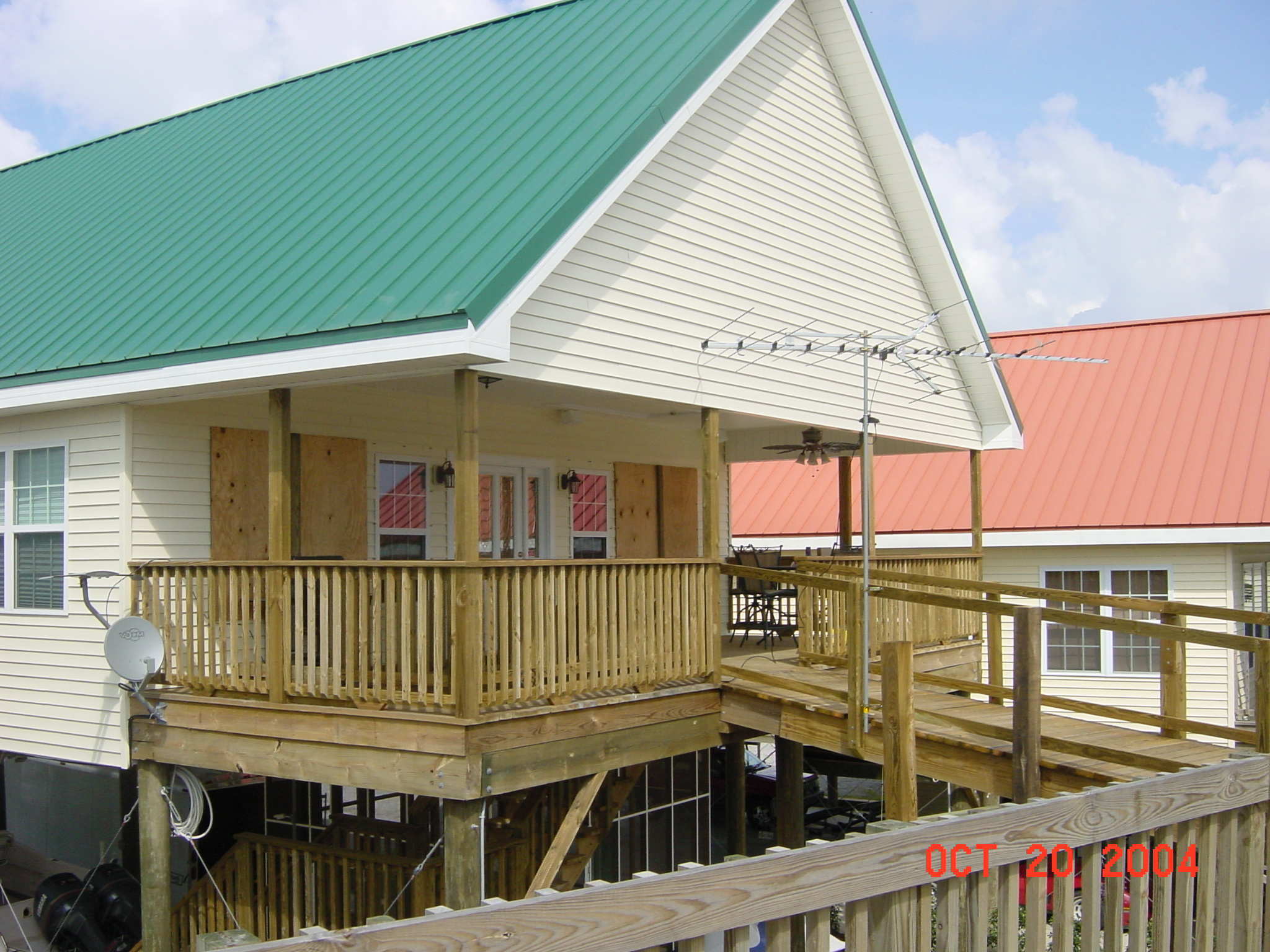

With regard to the OTA, yesterday I purchased a Winegard HD7084P (~ $130) and a Winegard AP-8275 pre-amp (~$80). I temporarily installed this antenna and pre-amp off the walkway to my deck. I hooked it up and did a scan. I now receive 16 OTA channels (some are .2, .3. etc.) from New Orleans.
It took pictures of the OTA scan and am going to e-mail them to the Installs manager of customer service (along with the invoice for the antenna and pre-amp). I am going to ask him to reimburse me for them.

1.) It's easy to install (just be careful around power lines, etc. per the instructions). No special tools needed and you can use the Voom installer menu OTA Aim function to properly aim it).
2.) I just disconnected the RG-6 from the Sensar II and connected it to the pre-amp. I have 3 Voom boxes so I left the diplexes connected behind each box. In my case the multiswitch did not pass voltage to the Sensar II antenna so I already had a Winegard pre-amp power supply connected between the Sensar II and the UHF/VHF input on the multiswitch .
3.) Not sure about this one. It wasn't a problem for me since the multiswitch Voom installed did not pass the power anyway.
4.) The pre-amp installs on the mast just under the antenna. You install a short RG-6 jumper from the antenna to the pre-amp "ant" input and connect the RG-6 that you disconnect from the Sensar II to the pre-amp "Power Supply" connector. Install the power supply inside (it requires 120 volts). The power supply has two connectors, one to the antenna and the other to your UHF/VHF input on the multiswitch.
