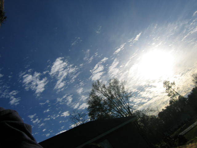

No I have a single LNB arm I swapped it out with....just using one now...I snapped a couple of pics...the sun is in the way but here it is...I centered the camera in the dish and snapped this....this is about the best one...
Turbosat ( and me) think I might have a tree problem. :mad:
