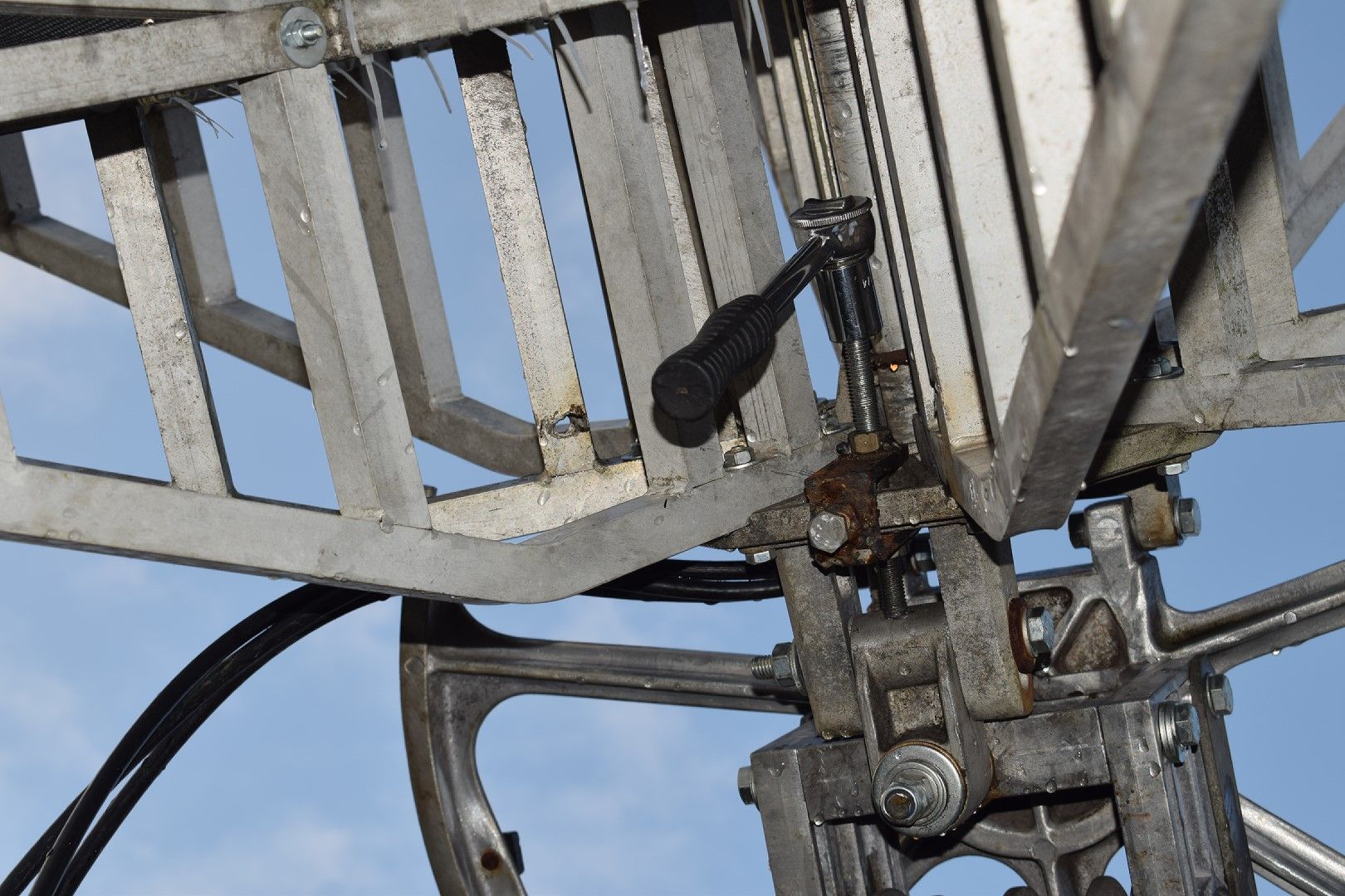

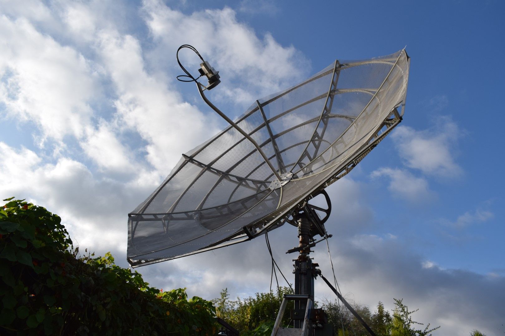

Hi ive just restored one Paraclipse 3.8 on H to H mount restoration/installation i love this antenna its been a pleasure to work on, i am just fine tuning the arc at the moment then i will be making new arms i do like the button hook but it wont support the weight i will be putting on it.

I must agree ive always loved the look of this dish how lucky i am to find one in the UK, i replaced the clips with uv resistant tie wraps still a pain to install about 700.
4 lengths of guy wire and turnbuckles will do wonders to center and support that button hook. Just set up the guy wires to go from the end of a strong rib, and use the turnbuckles to tension them in perfect balance all around.
Many thanks I have read about this option but its not for me, I would still need to do modifications on the button hook as I will be installing three feedhorns with Norsat lnbs, its not a long job to make and install new arms I already have some 22mm box section for the job, but many thanks for the heads up :).
