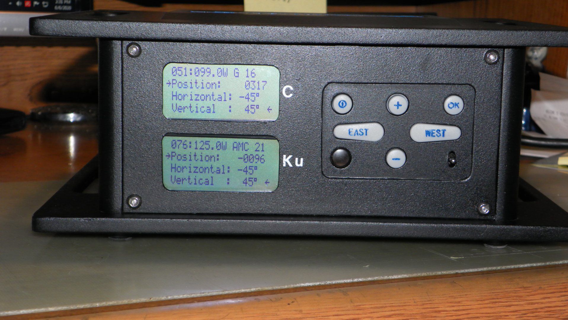

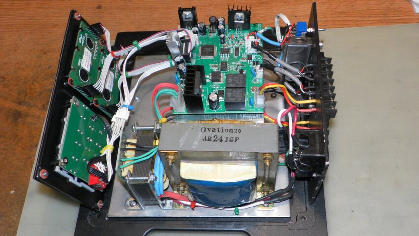

Of course if you're weird like me and want both controllers in the same box, more fun to be had. ;) I just finished redoing the ASC1 Siamese Twin I built. Decided the mainboards needed to be clocked 90° to the right to make the wiring easier. I went to my favorite metal store yesterday and they cut me a piece of stainless steel for a new mounting plate. $1 cheap :) But the computer was down so they gave it to me.
