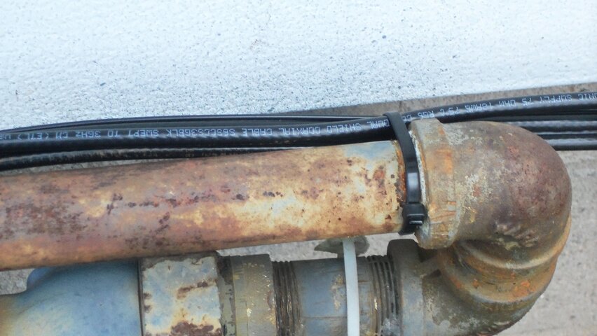

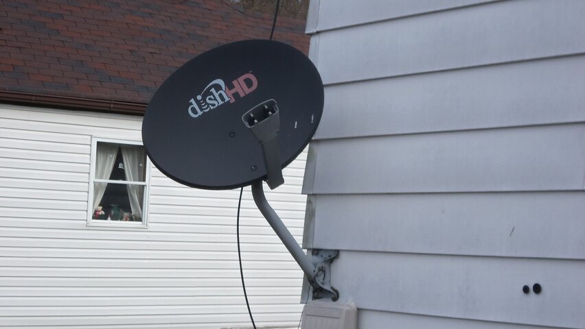

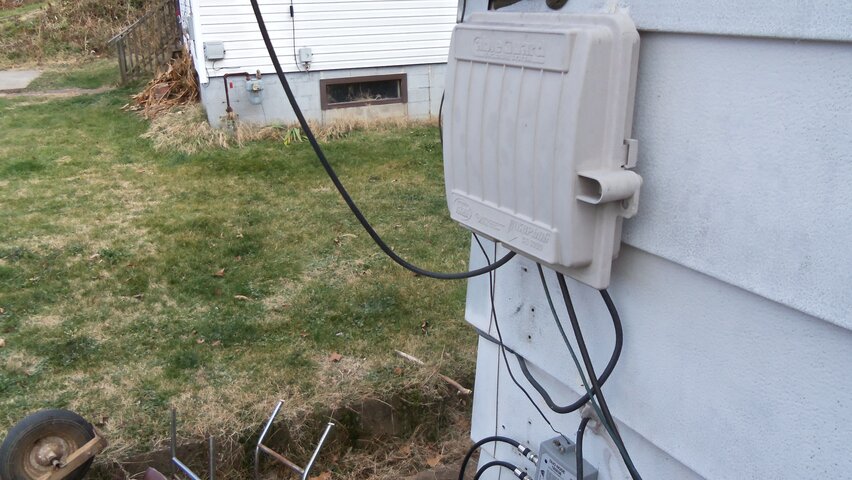

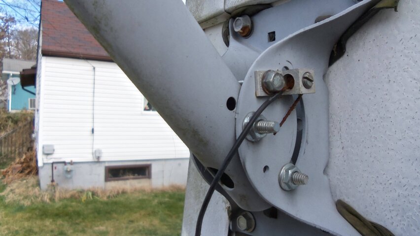

I finally got a chance to really look over my install. Just to start off the installer left my old dish on the house, and left the WA LNB. (I removed the LNB today) Then I noticed I had the cables running from my new LNB attached to my gas line. Then I noticed that the duo node was still grounded to my old dish. I'm thinking that this install isn't right and I should have paid more attention before signing off but I already called the company that did the install. (also the installer reported that he advised my EA install wasn't possible and didn't do the install, according to the CSR at the regional contractor office, red flag) and they'll be out later but here are some pictures.

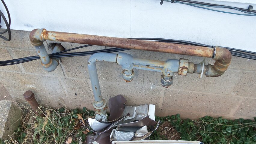

new dish on the roof, the cables from the LNB drop down, go under the stairs and then are connected to the gas line, pictures below.
There is actually no gas service, but doesn't the gas still come to the point to where it's capped off ?

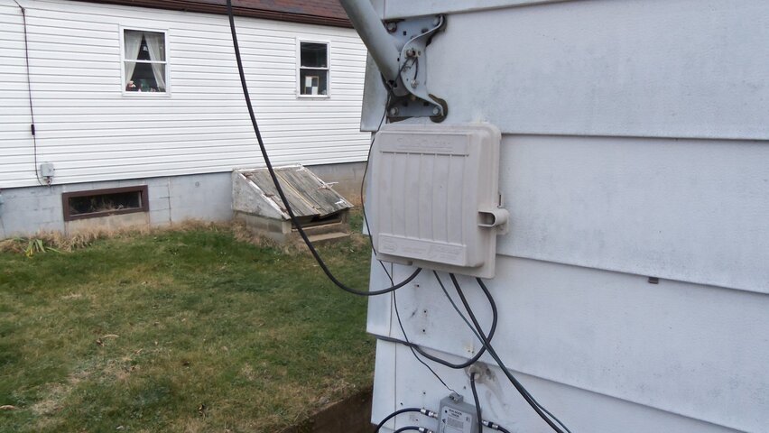

Anyways then I noticed that my old dish was still grounded to the node.
The guy told me how he was going to do the install. Wires dropped down from the roof, under the stairs, I figured he was going to use fasteners to attach the cable to the bottom of the siding like the previous installs, and that the "wiring" would include the ground wire. I should have taken a closer look before I signed the paperwork but it I was also doing with computer issues and doing a full reinstall of windows and holding my dog at the same time (to keep her away from the installer)
Alright so by chance lightening did hit my dish voltage running down to that wouldn't matter or be even possible to happen in the first place ? I just don't want the house to you know, blow up and I really know nothing other than what the installer that connected my Hopper system told me about never connecting anything to gas lines. (this was prior to being connected to the eastern arc)
There isn't anything particularly dangerous that I can see, however if the goal of the tech was to do a sloppy job. He definitely achieved that.
If lightning hits your house, the coax won't make a difference one way or another.
For peace of mind and so it wouldn't look so messy, I'd probably just cut that plastic wire tie off of the gas pipe and tack it up under the siding myself, remove the old dish and run the ground wire to the new one. A bag of plastic cable clamps is cheap and it wouldn't take much time, no sense in losing any sleep over it.
I agree with Stardust3, doesn't look particularly dangerous from what can be seen, definitely looks sloppy though.
Never put any wires on a gas line. The curb may not be off and or valves leaking. It is not a safe practice.

Last tech could of removed the dish and mast but left the footplate. I would have since it is at standing level.
Was the tech specifically asked to take the old dish down?
That doesn't account for the other stuff, but if they were not asked I would not assume that they would do it.
