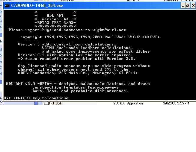

Software Calculations
1. How did you arrive at the values (other than the diameter of the lnbf)?
2. :confused:WHy did you use 5.150 GHz? The frequencies of the waves are mostly between 3.7-4.2 GHz aren't they??
There is a software program that you can find on the internet that will do the design for you. You must be a licensed HAM to use this without infringement of copyright. (See Screen Shot) This will do Rectangular and Conical design. If you have difficulty reading the screen shot save and open iin my pictures on you PC you will be able to enlarge it. I also used "Cone Layout V2.0.4"
The program asks you to input frequency, gain and LNBF diameter and calculates aperature diameter and axis length.
Try 4 Ghz. Won't be signficant.

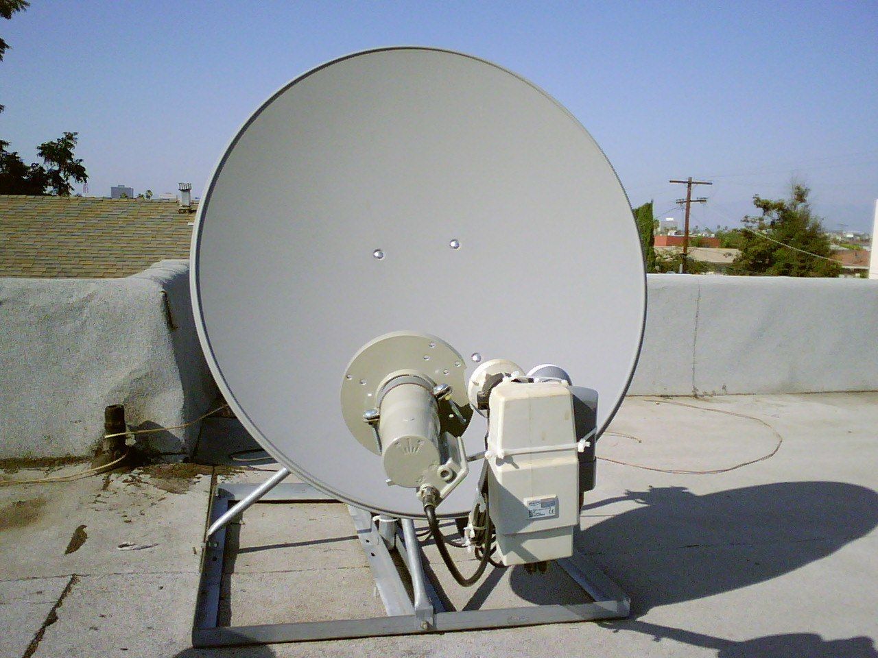

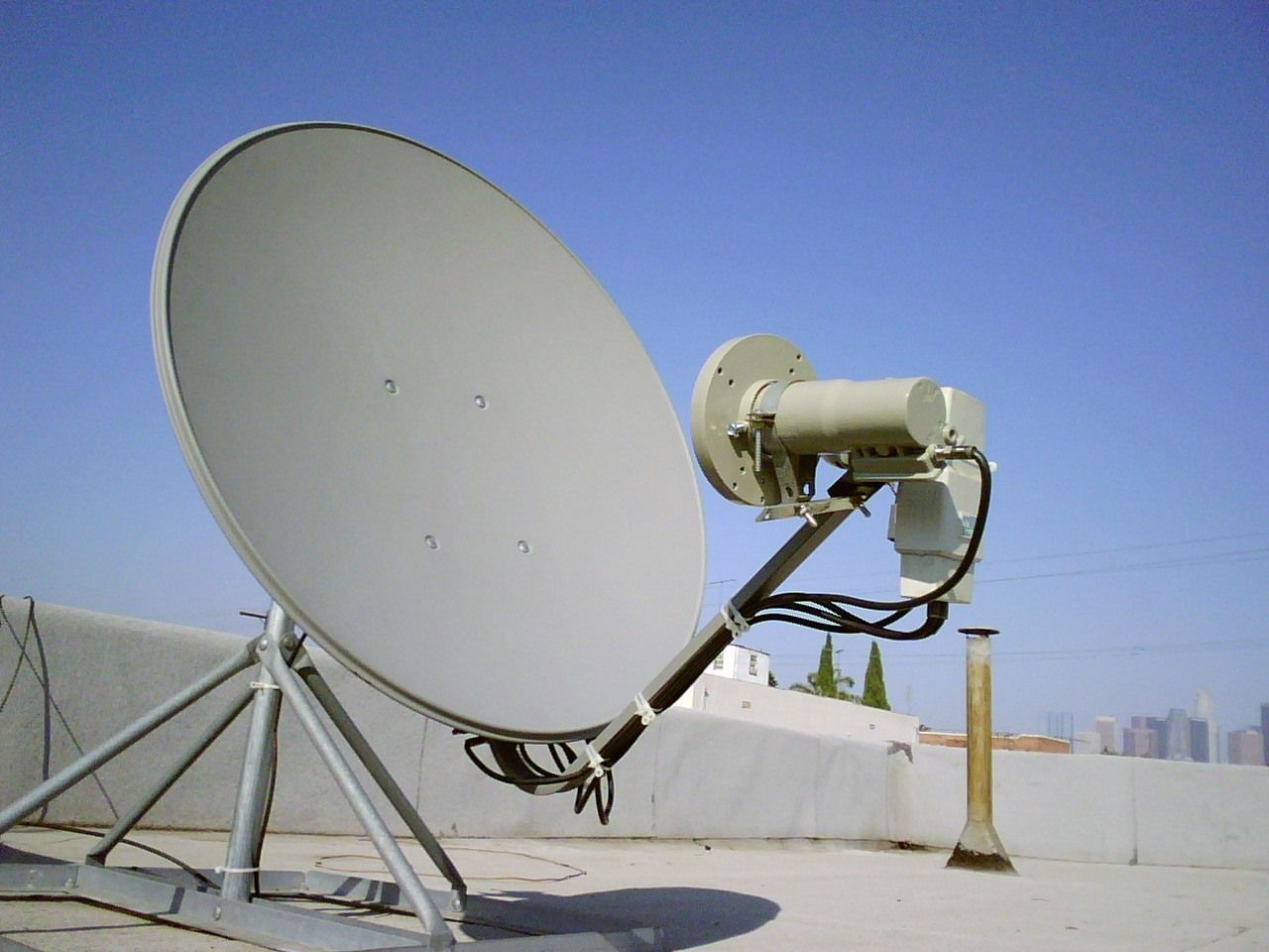

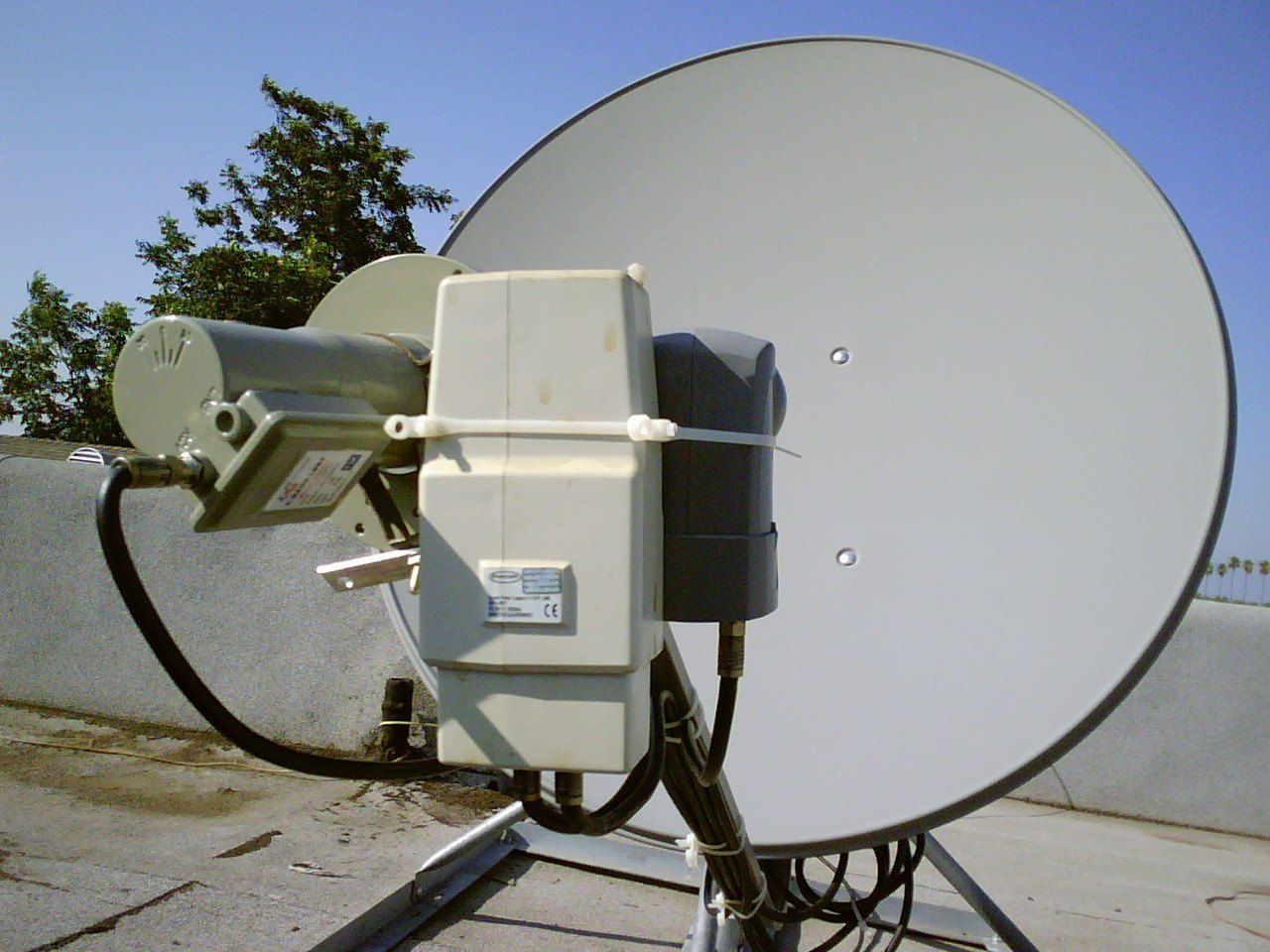

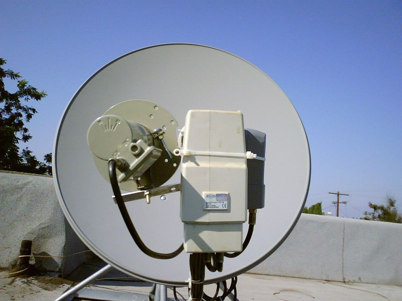

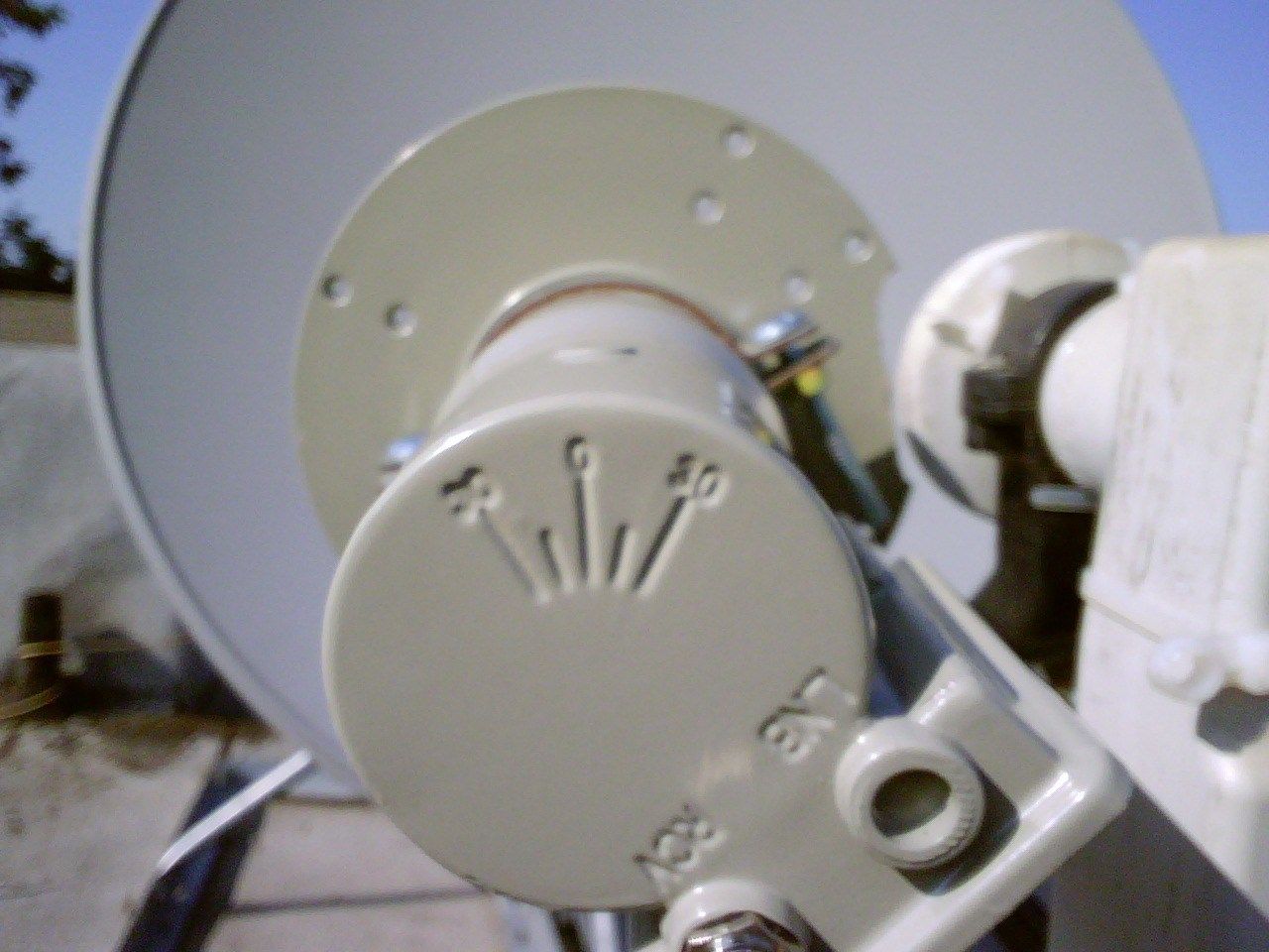

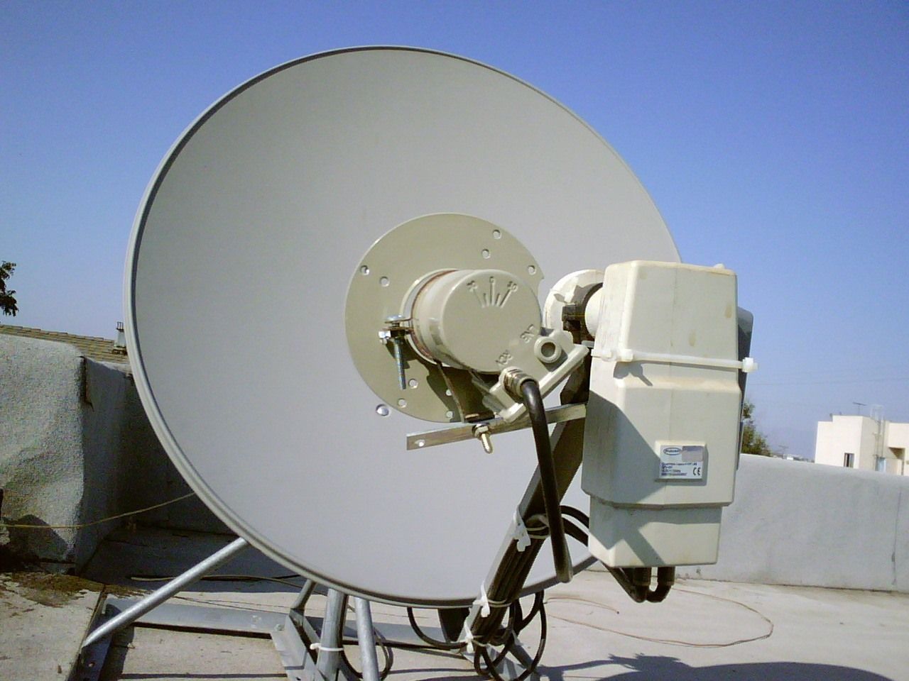

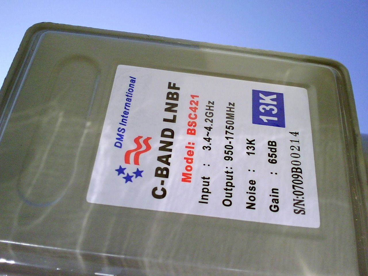

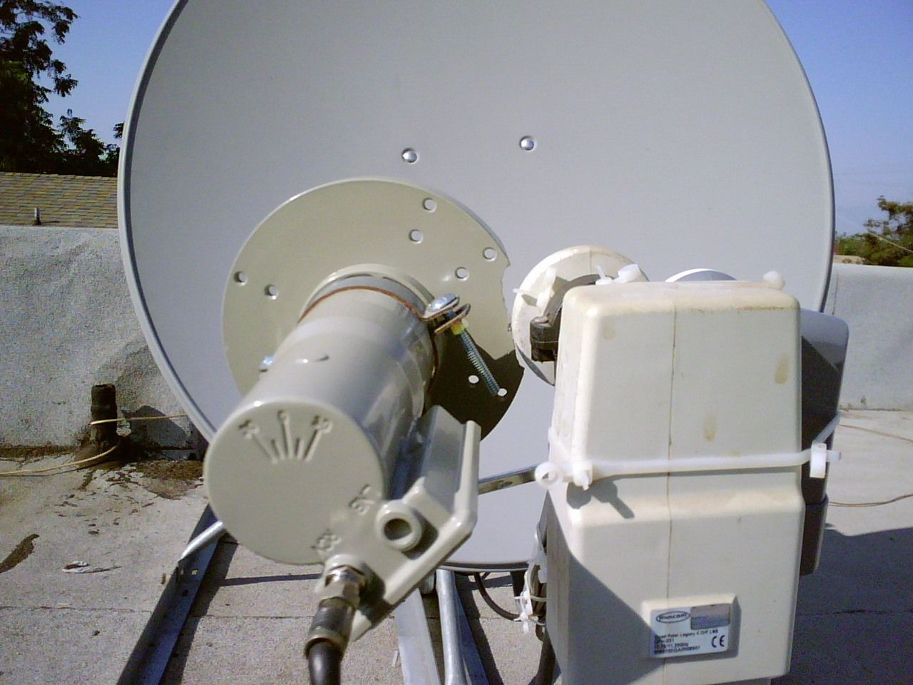

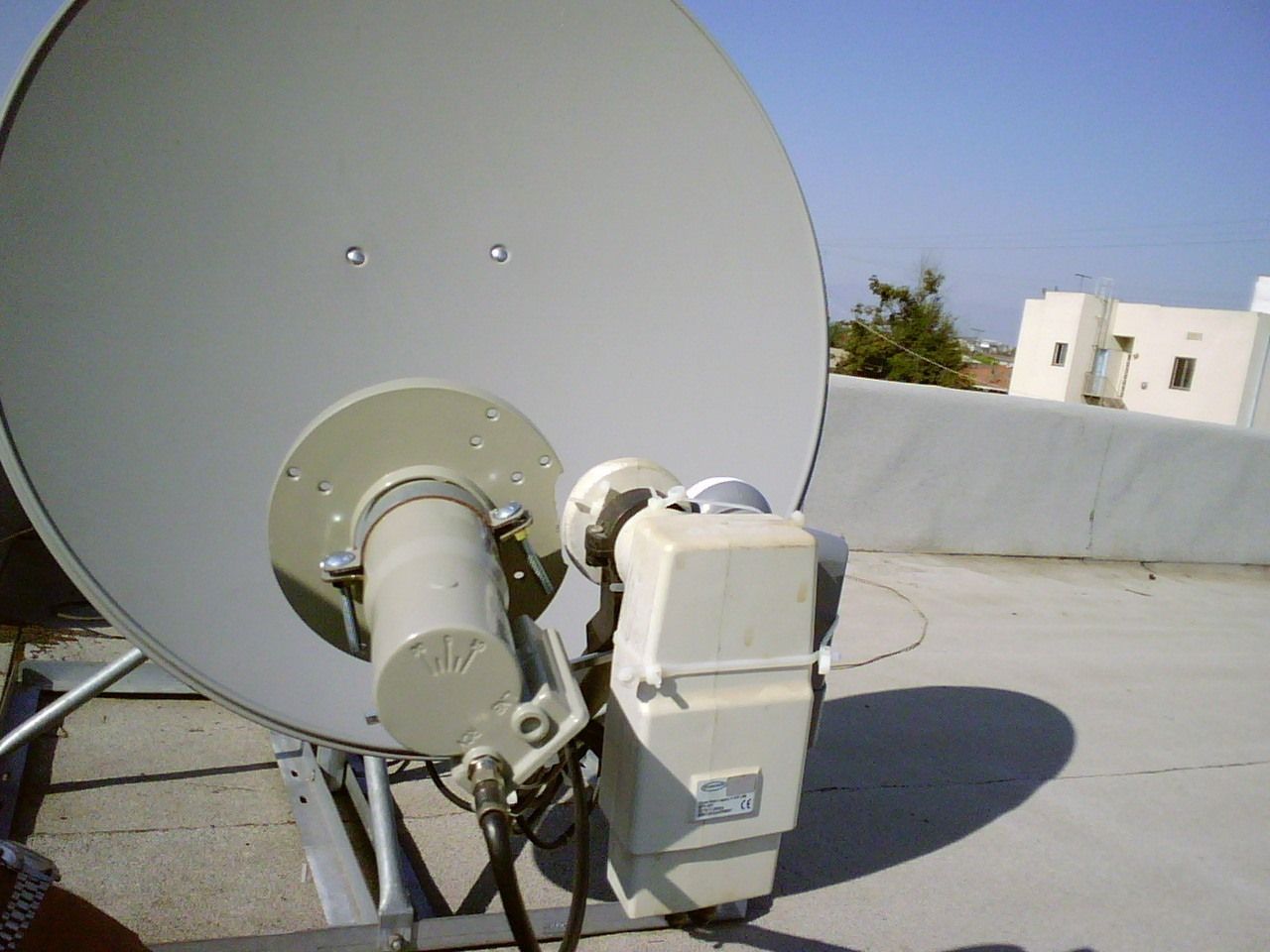

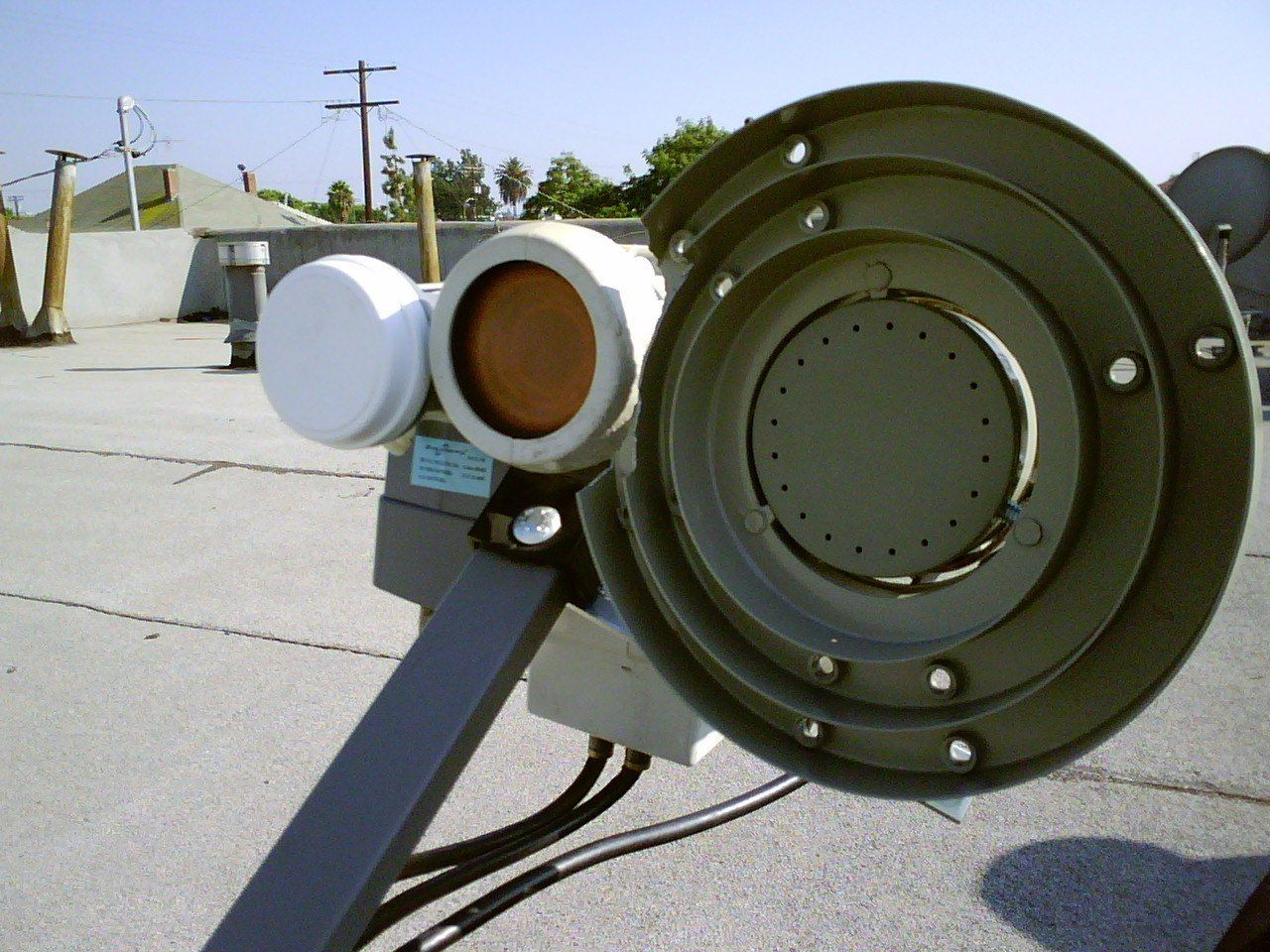

I changed my lnbf to a BSC421.
Added new updated pics enjoy:cool:
BSC421
DREAMFOX1-
Most Excellent! :up:up:up:up
Your setup is a really professional looking.:cool:
I'm waiting for your comparison to the Panorama LNBF which was DOA for me twice. :mad:
I would guess that the BSC421 will give better performance then the BSC621 LNBF. I just got a BSC321S and it works much better then the price would suggest. :D I'm very pleased with it and will order more. I took the lower plastic housing off and it fits perfectly into the P*E LNBF arm.
I hope that your success spurs others to emulate your work. I would like comparitive information.

The BSC421 is way better then the Panorama.
Improvement in signal quality 8% increase.
Great Specs.
13K and 65 db gain - Blazing!
Excuse me while I order one. :D
8% SQ improvement That should set some solid video on your Plazma:bow

I noticed that at night my signal quality is double in strength.
Must be a heat issue caused by heat rising from the roof during the day.
Is there anyway to block the lower part of the dish arm?
and
What material should I use?
and
The thermals rising between the arm and dish won't have much effect.
The solar radiation would most of the time be too small to notice. During a Solar Flare episode solar flares do effect all communications of e/m.
My guess is that with all the weight you have on the arm, when the arm gets hot it sags.
Just to eliminate that as a possibility, put a tent over your installation, like one of those patio tents that you see blowing around on AFV.
