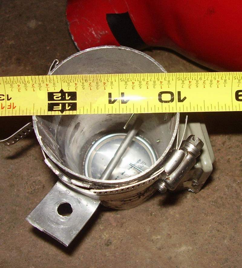

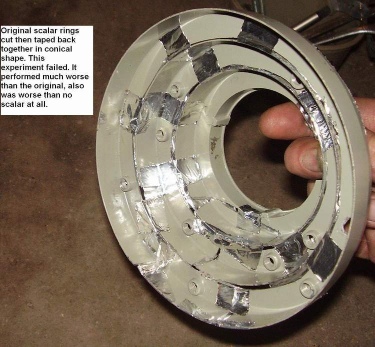

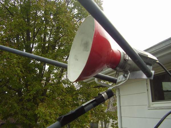

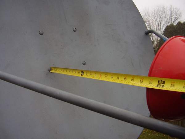

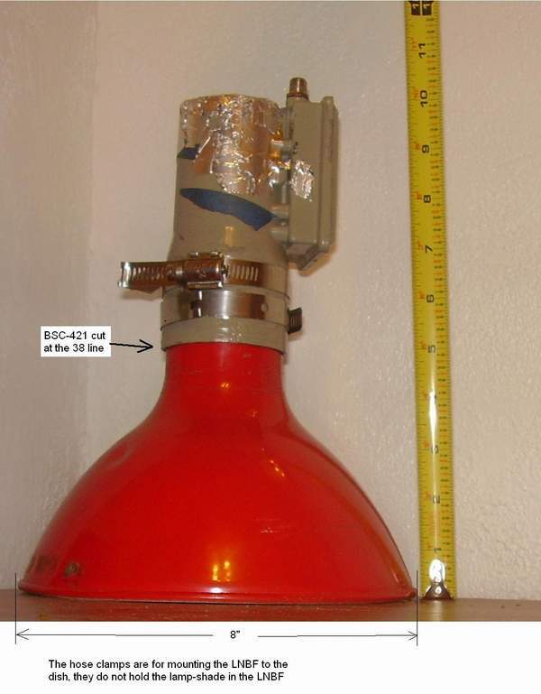

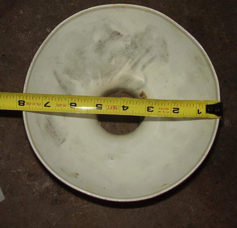

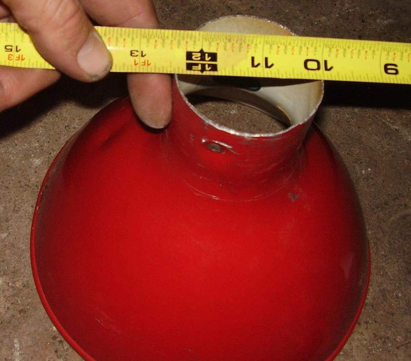

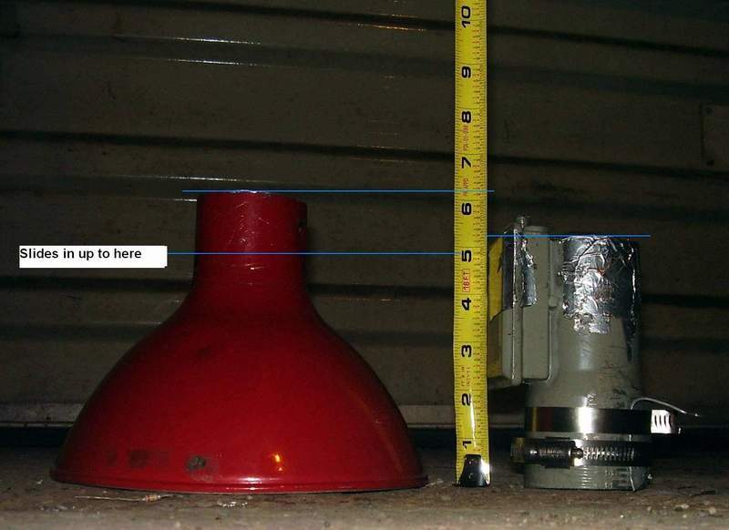

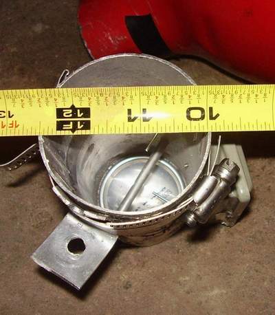

Could you give me the measurements for your lamp shade? Depth, and circumference? I have a bunch of aluminum coil stock I'll make one out of. :)
I never considered hacking the end off the Panorama. I'm usually pretty nervous about frankensteining anything I'm not sure I understand yet. But, I suppose, with the new LNB coming, I could try it with this and see where I get. Then if I have the same results as you, I'll do it to the new one too.
I started a new thread yesterday asking about scalar ring positioning but haven't had any responses yet. I guess the lines on the side of the LNB are to set the scalar ring at the dish focal depth. My dish has a f/d of .59 so I wondered (and I guess I'll just do it to find out) if it would work any better setting the ring to an imaginary 60 line and see what it does, except that I got my fingers so numb from the cold doing it I'd rather know before freezing my a$$ off again.
Ok I uploaded some more pictures above, hopefully this will help. I included another failed attempt at make-your-own conical scalar. Also I tried adding a ring or 2 to the metal lampshade, those made it worse too. I'm starting to think you need a scalar that is all one molded piece, you can't just tape some pieces together and hope it will work. I was using metal duct tape too, the kind that has something like aluminum foil on the back of it. That didn't help either.

I appear to have the same primestar dish that you do Dale, and I've also got a C-band LNB but I have apparently misplaced my scalar ring. I never got C-Band to work on it before anyway, but am intrigued by your approach.
So are you saying that the metal lampshade, did or did not give you enough signal to watch DVB on C-Band?
:hungry:

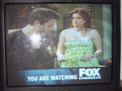

I'm saying that the metal lampshade helps somewhat, not a lot. I could get some stations with a stock scalar ring, but I couldn't quite get the networks from the Caribbean Islands, but now I can. Still even with the lampshade the dish has to be dead-on, no room for error. Also note that before I screwed up the back end of my BSC-421, I actually could get the Caribbean stations with the BSC-421, no cuts or modifications and the regular scalar ring. But again the dish had to be dead-on. I really wish I had not cut the back off like that, maybe I could get a few more stations. If you look at the picture you can see how I patched it with the bottom of a pop can. I might have to break down and spend the $30 on a new one, put the lampshade on it and see what happens.
If you could not get C-band with your LNB, you didn't say what brand it is but that can make a big difference. Before I got my BSC-421 I tried an old Chaparral feedhorn with a precision LNB. That thing might have worked OK on a BUD, but on the primestar it was useless. I could barely detect even a strong signal. The BSC-421 blows that thing away, lampshade or no lampshade.
