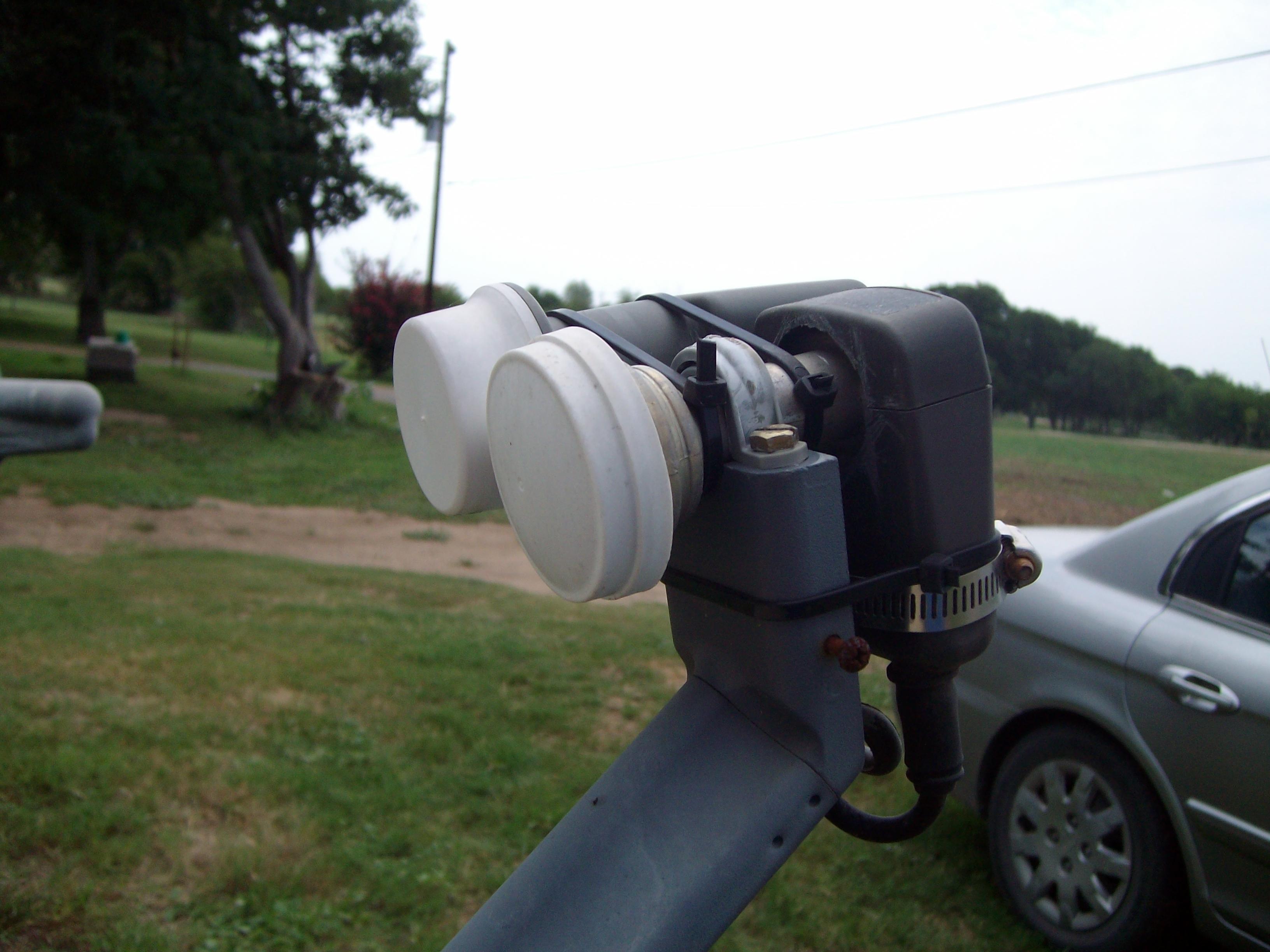

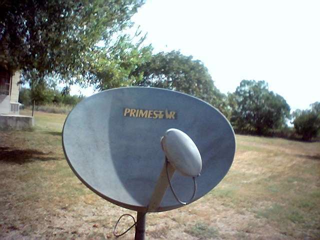

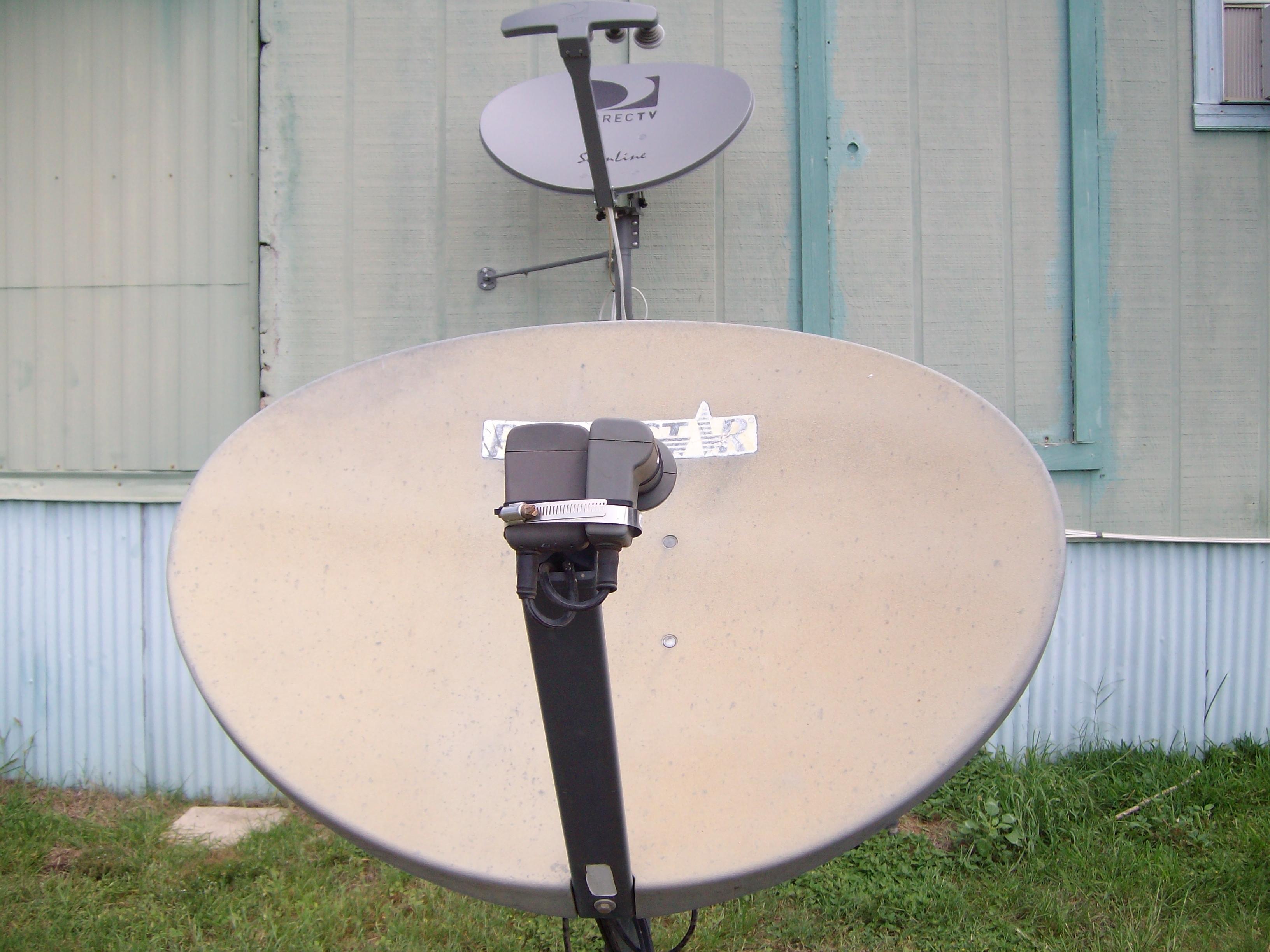

I would pick up all the Primestar dishes I could. Especially if they are free. I actually have 5 Primestar dishes LOL I forgot about one of them when I said I had 4.
Here is 2 of my Primestar dishes in operation

The primestar dishes are real nice to use. I picked up 3 more last weekend to accompany the 2 I already have :)
The LNB's work real well and are easy to skew. Just unscrew those 4 little screws behind the feedhorn and twist :)

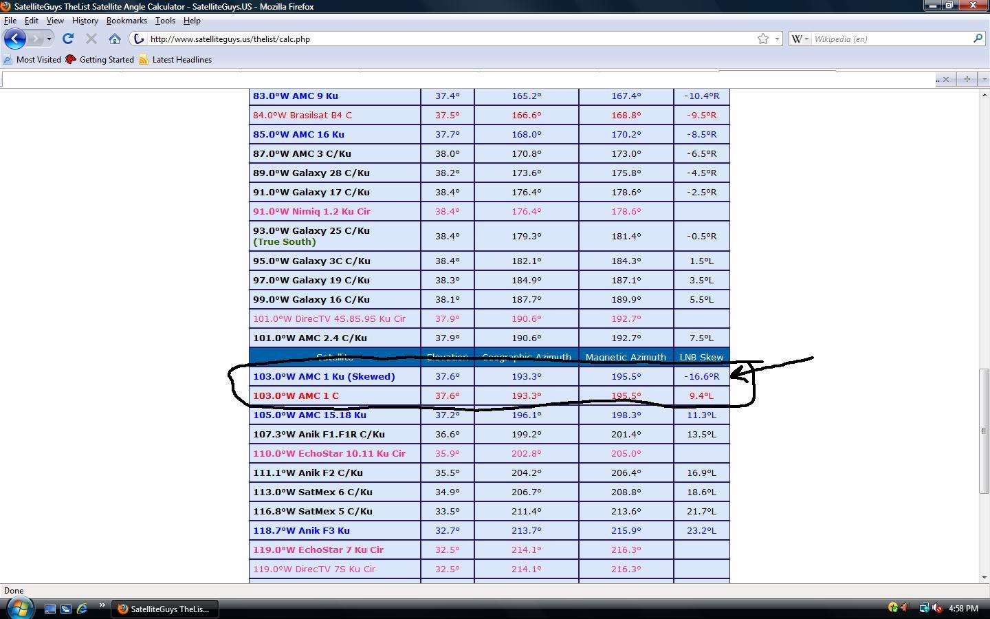

AMC1 would be Pentagon Channel
12100 V 20000
then tweak off that for the NBC news feeds. Remember the crazy skew on AMC1 ;)
Thank You Iceburg
Thank you Ice for that information as I wasn't aware of any skew issues with AMC 1. Thanks for the TP information as well that will give me something to try Tuesday if the Weather allows. Cold here today and rainy and I haven't felt the best so I have neglected my hobby as for working. However I have enjoyed the watching!
The best thing to do is go to thelist up top and put in your zip or city/state. Qwert1515 (who runs thelist) put in the correct skew for AMC1 KU so it shows properly (weird...but properly)
see mine below

What size oval is that, 40x48?

Thanks Ice for the information concerning the skew. I tried Saturday using the list and zip code to set up on another sat. My readings was off by about 2 to 3 degrees or more. Like I said I should've worn my glasses!
