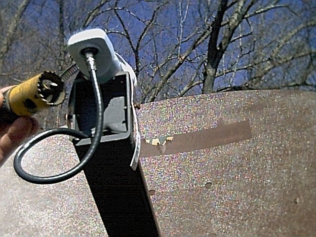

I just took a hole drill to a piece of wood then clamped to the primestar I just shaved about half of the aluminum away, (took the pilot drill out). The LNB is being held with a duct clamp cut and I used a nail to punch the slot to allow the screws to hold the LNB. Worked for me.

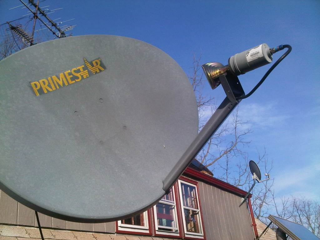

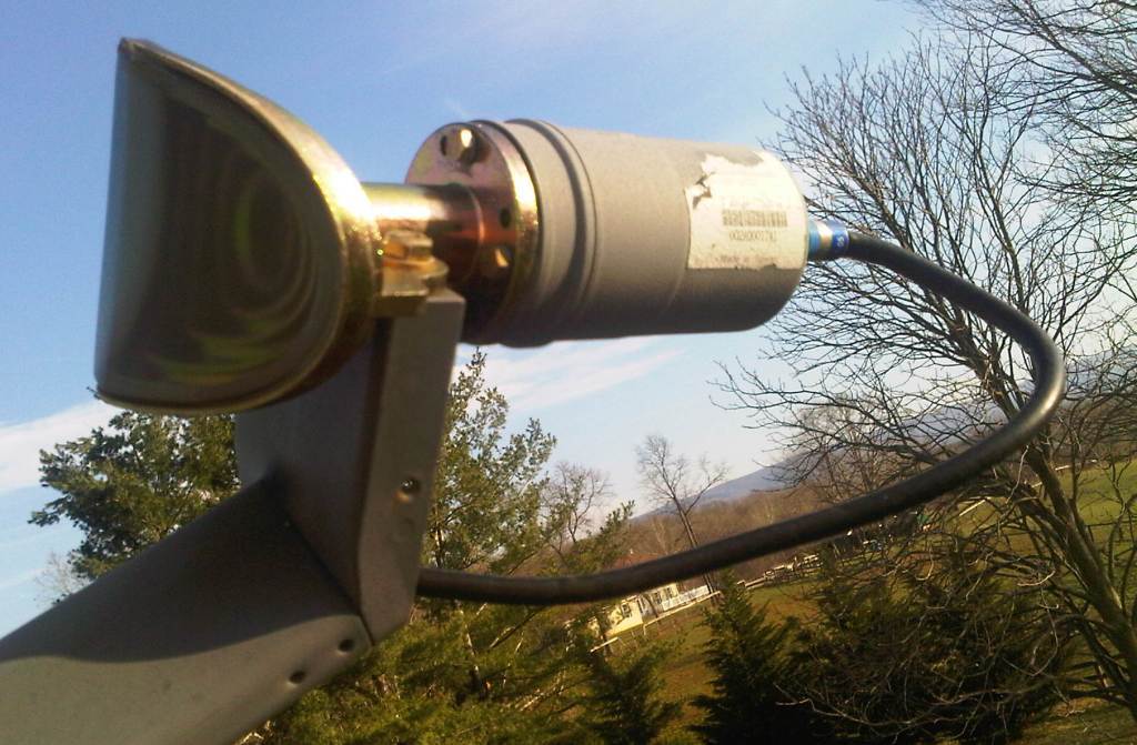

This is the LNB I use with PrimeStar 75E
I have found this Hughes LNB works very well with my PrimeStar 75E.
It has a larger feedhorn than others I have seen - - - and works very well. :up
