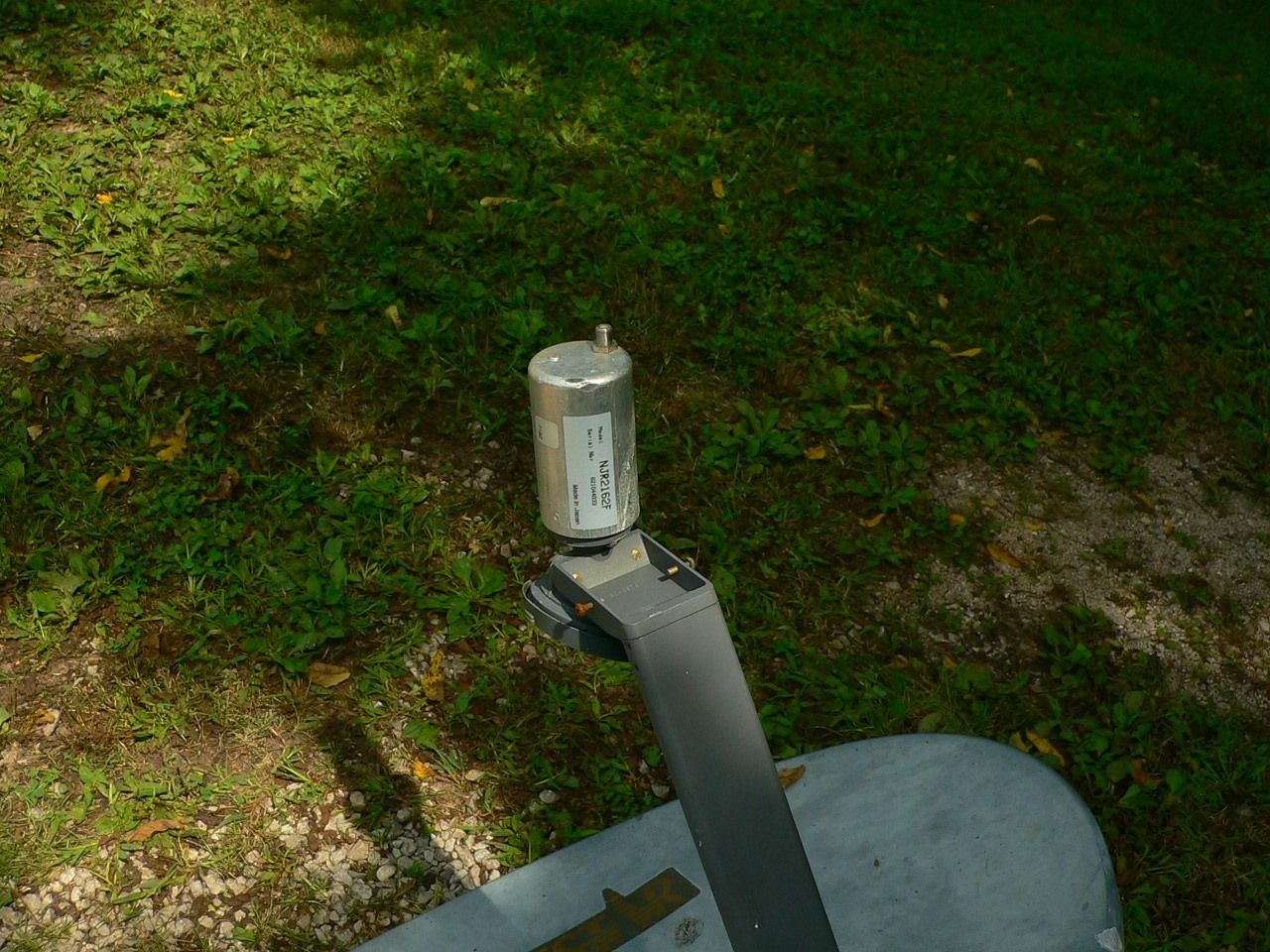

I picked up another P* (.90 x.63) this weekend and the LNBF only has one output on it.
I have 2 other P* ellipticals, same size as this one. One has the "soapbar" LNBF, and the other has the "beer can" LNBF, both of those have separate H & V outputs.
Does this single-out LNBF switch polarity on 13V/18V input?
here's a pic of the new one:

Some Primestar newer lnbf's were 13V/18V. Great find :)
Good news there, thanks!

Google: LNB NJR2162F
I was going to look up the part number on the side of it, and give you a link to the factory specs.
But, look what I found instead, on the Sadoun web site! - :cool:

Thanks for the link, Anole, I remember seeing that on the Sadoun site in the past but didn't make the connection until now.
I'm going to see if the feedhorn on the 2-output "beercan" is compatible with the single-output, I would think they should be.

I got one of them 'equivalent part' ones Anole linked - my 75e REALLY liked it, even though I think it was made for the bigger dish.
I two 75e dishes, one with the proper feedhorn (it was originally a VSAT dish) mated to a Invacom QPF and the other had the feedhorn for the 40x30 dish paired with the LNB similar to the one the OP found.
The performance is VERY close on these.
The Primestar "beer can" LNBF's...
NJR2162F which is a single output with a internal 13/18v switch-harder to find but not impossible, newest version.
NJR2119F which is a dual output requiring an external 13/18v switch-fairly common.
NJR2112F which is also a dual output requiring an external 13/18v switch-older model that uses more current
