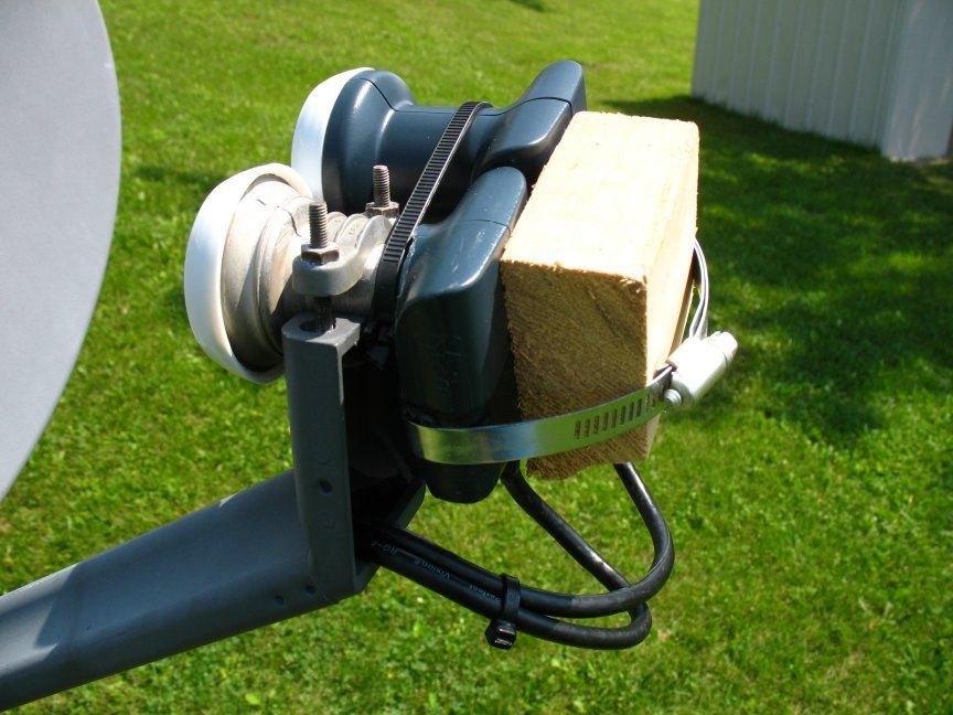

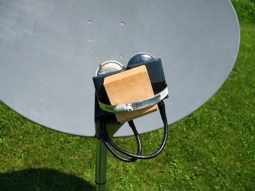

I got lucky with my IA5/AMC4. My lnbs are placed flush next to each other and I have 86% on AMC4 (KUIL). No fuss no muss! But, with G10/IA7, it took a bit of moving the lnb around to get it just right.
