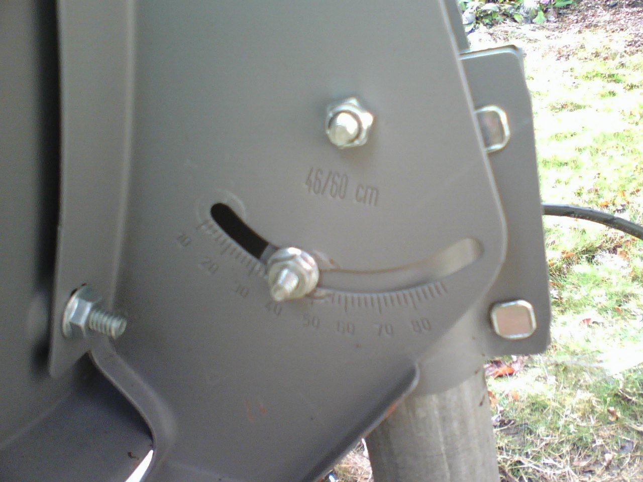

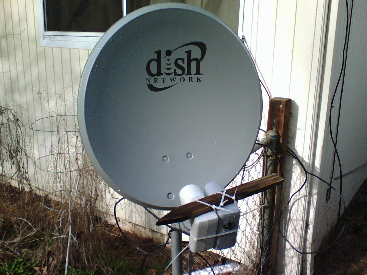

I picked one up for fun from a neighbor last December.
It's a d-tube polar mount that's non-skewable. Imprint indicates that they use the same polar mount for a Dish 300 and this dish with a larger reflector. Reflector measures 24 inches wide by 26 inches tall.
Pics attached.
It's pointed at 119W and I added 110W yesterday to watch Pirate TV ITC for kicks. My LOS is frustratingly split here...:mad:
DN was using them here for the HD stuff on 129W before C2.
Any ways this is the dish that I used for 97W when I was reviewing out the DVR-1100c. I got about half of the transponders. I remember watching MHz Worldwide, Russia Today (borderline), Press TV, and listening to American Liberty Radio. My Coolsat hardly had a day that it would work except for MHz Worldwide.
For the linear lnb bracket I used the one I got with my red Techsat Tracker II+
Took some messing with screws, nuts and washers to get something to get it to stay but I had it working for over a month semi-reliably. A good rain cloud and I lost most everything on it 'til it passed.
