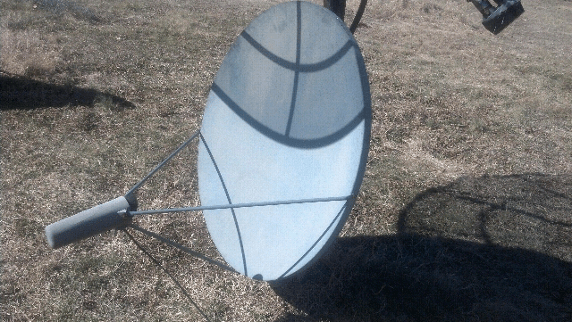

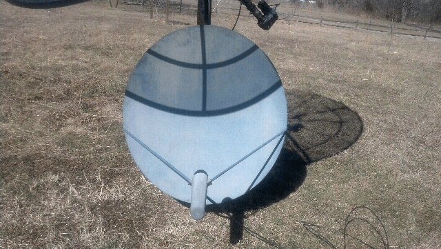

I have been eyeing a dish on our local pharmacy for about a month. Went yesterday and asked about it, got in touch w/ owner today. They let me have it for free :) ,providing I took away the base and the concrete block holding it down. No problem there! Although I didn't know until I went on the roof to get it, that it was fiberglass. It measures 40" wide by 43 1/2" tall. It doesnt have any markings for a name, other than on the lnbf. Question is, how well will it work being fiberglass? And will the lnbf work w/ my MicroHD, providing lnbf isn't fried? Pictures posted in a thread below. I have it leaned up against my BUD, thats the shadow on it. Thanks.

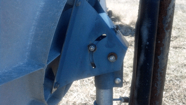

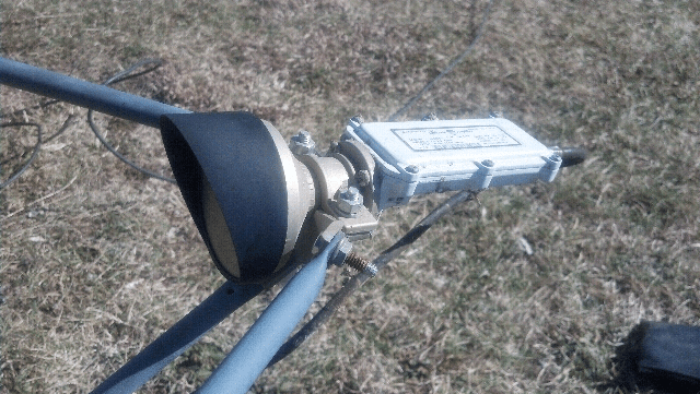

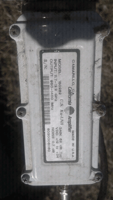

Sorry about the pictures. Went on the mobile site this time and tried loading. Thanks.

That's the weirdest Prodelin setup I've ever seen.
The wagon wheel spokes on the rear of the dish identify it.
Might be a dual polarity LNB.
Very nice fixed mount.
Hook it up. Should work as is.

Nice find! Single polarity LNB. Stick a normal FTA lnb on it. But keep that LNB/feed. Could put a C-120 flange style LNB (Invacom QPF) on the feed. Or onto an orthomode waveguide w/ 2 LNB's and a multiswitch. There's always options.

@ FatAir. I believe you are correct about it being single polarity tho. Its showing TPs being vertical, but they are the same #s as the horizontal #s. Would a normal FTA lnb work at the same focal depth? Or would I need to modify lnb hanger to maximize Quality?

How do I go about mating lnb to existing feedhorn? The good thind here is, I can be my own machinist :). I am a welder/pipefitter by trade, so I have access to the tools to make my anything I need ;).
1st choice: SatAV PLL lnbf
2nd choice: find/buy an LNB or ortho that'll bolt right on to your feedhorn.

Very true! The existing feedhorn is very important as it is matched to the dish. I have tried replacing the lnb with a regular lnb and could never get the same strength signal as with the original feedhorn.
remake the bracket that holds the lnb to fit a 40mm throat but make the part that bolts to the arms slotted instead of a hole so you can make adjustments.
your feed looks like a 75 wr flange and the Invacom QPF LNB with C-120 flange style will not match up for the best performance.

Thanks all. Just an update. Had to set my LO to 11250 and I got sound on 97w. Still only pulling in horizontal tho. Will have to work on making that new bracket.
Now that just don't make sense.[??????????] All that should do is make it display the transponder frequencies 500Mhz different than actual. L.O. has nothing to do with sound PIDs. :confused:
But then again, I've heard, and used, the 'whatever works' once and a while.
Lol yea that's kinda what I was thinking, but that is the only thing I did different was change the LO and it pulled in sound. Also tuned 125w today on 11250 LO, and it worked fine (horizontals). My son enjoyed the cartoons on PBS :)
that same flange that youy can bolt up to can reuse a an old superdish lnb to it. I reused a an old prodlein dish look up the thread "need info on this dish"
