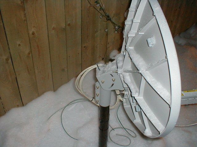

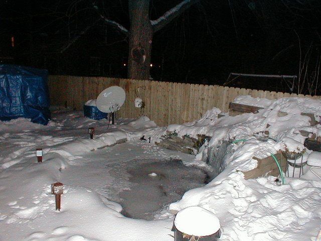

If your using a metal pole, the key is to dig the hole as deep as you can and then get a sledge hammer and pound the pole into the ground so your past the 42 inch frost line.
Get a hack saw and cut off the top of the pole and then fill the hole in with Cement.
I did this using a 2 3/8 gas line to mount a starband Dish. Got the hole down about 36 inches and then got the sledge hammer and pushed the pipe down another 24 inches for a total of 5 feet!!!!!
Once I got it installed, I was never able to move it!!!!
Finally I had a house fire and when I rebuilt the house I added an addition and had it removed with a backhoe...
