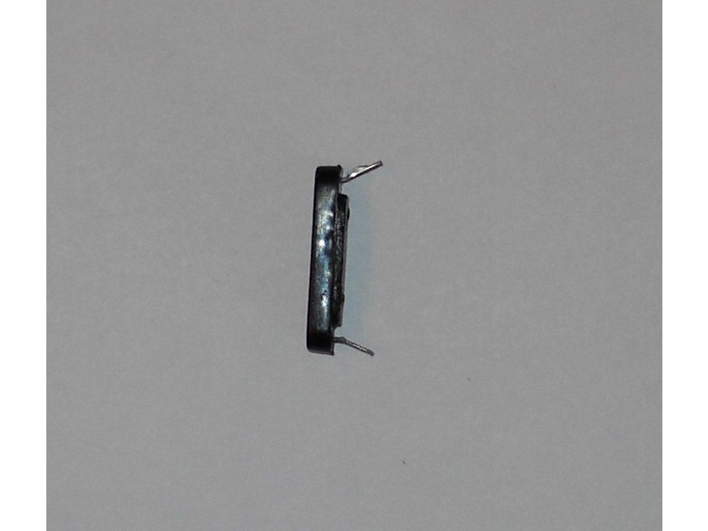

Just received my new ASC1 and have been having same issues I've had with other controllers. After some trouble shooting, I have come to the conclusion that the issue is one of two things:
1. sticking reed switch
2. magnet is either to weak or to strong
Fixing to go looking for a replacement reed switch.
This has been an intermittent issue, as it will work some times and others not.
Anyone, have any other thoughts?

Cheapy Superjack. Have had wheel and reed switch out. Appears to be normally open and will respond to the wheel when out. I have since seen a photo on the internet of same name actuator, that shows the reed switch installed rotated 90 degrees from the way mine is. Will try that in the daylight tomorrow, as from some technical data found it does appear the position may have an effect on how well a reed switch works.
When installed, the switch seems to stay closed about 99.9% of the time (Except for when it is working.). Started inside and when I didn't see a bobble with my analog meter and it indicated a dead short or connectivity if you will, I moved out to the actuator and found that the reed was closed and not opening.
Maybe daylight and a 90 degree rotate may make a difference.
Are you saying that the switch is stuck closed when the magnet is removed? While this is a sign of an aging or failing reed, have had the same problem with Superjacks new out of box. A good thump with a screwdriver handle often gets them operational again (until a new Venture Maxi is delivered) :D
Problem got identified this morning. Got lucky and caught the intermittent problem when it was being a problem. The reed was sticking closed. Had it inside and hooked up to the meter and pulled the magnet away and it stayed closed. I happened to have a couple of NO reed switches in parts drawer from a Jameco grab bag years ago. One of them is currently duct taped in place, until I get a correct replacement.

Here is a picture of the reed switch. I took the leads off to hook up the temporary replacement.
Sorry, I forgot about this but yup, that's the same one I have here. I think they are still available as I purchased one a couple of years back but can't remember where.
