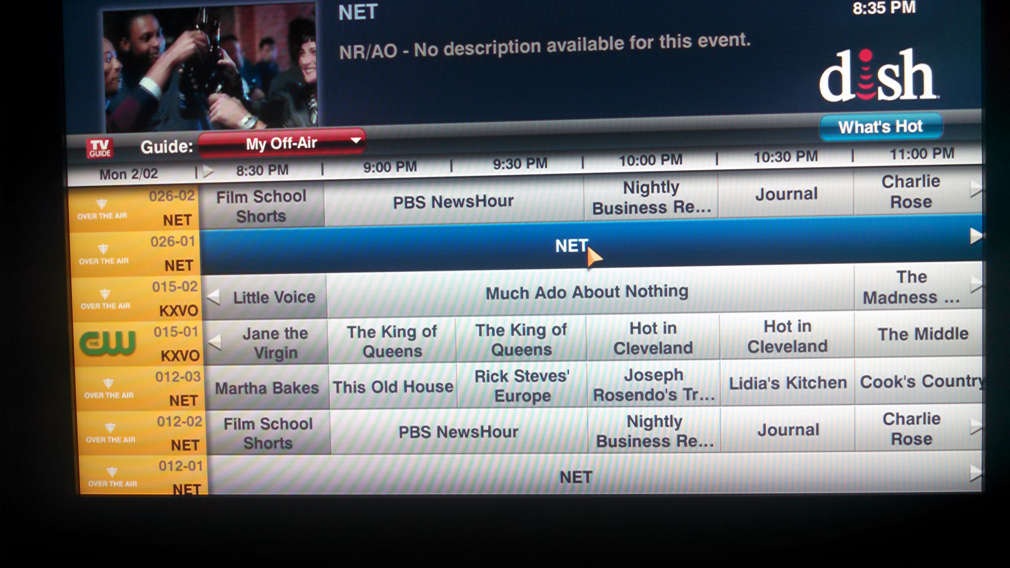

Omaha and Lincoln DMAs, Hopper/Sling x 2 and original Joey. Dish is looking at EA.
NET (KUON PBS) 12.1 guide data = "NET", remaining 12.2 and 12.3 guide data is correct.
NET (KYNE PBS) 26.1 guide data = "NET", remaining 26.2 and 26.3 guide data is correct.
What makes this strange is that I used to get the correct 12.1 and 26.1 guide data up until a couple years ago. I have friends with the Hopper with Sling/Joeys that look to the WA and they do not have the guide data issue I have.
Reactions: foghorn2
Strange that the WA/EA would make a difference

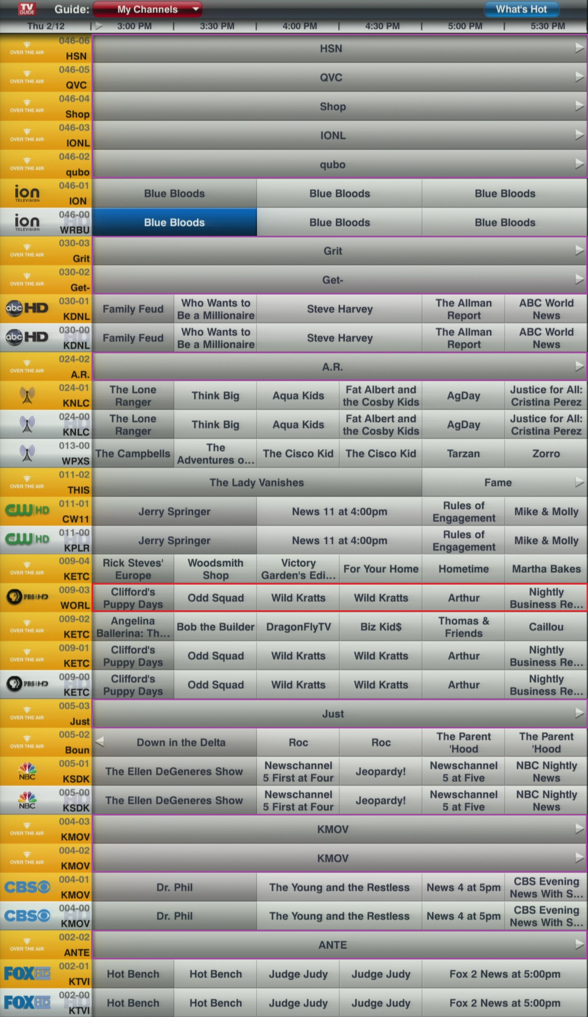

Here is the guide listing from a Thursday afternoon for the St. Louis DMA:
Channel 2.2 (Antenna TV) has no guide data, and shows ANTE in the guide.
4.2 (Me-TV) and 4.3 (My Network TV) are both missing guide data, and display only the call sign of the CBS station, KMOV.
Channel 5.3 (Justice) has no data, but shows the channel name (Just).
Channel 9.3 is the only one that displays incorrect data. It copies the 9.1 listings, however it should be data for PBS World.
Channel 11 seems to be correct on both channels.
Channel 13 is the only local that Dish provides that I don't get over-the-air.
24 is an independent local channel. 24.2 (A.R.E.) has something to do with Renewable Energy, and I'm not sure if they even have a guide. Shows A.R.
30.2 (Get-TV) and 30.3 (Grit TV) are missing guide data, but show channel name.
None of Channel 46 (ION Television)'s six sub-channels have guide data. All show the channel name (qubo, IONL, Shop, QVC, HSN).
There are some other local area channels that Dish does not provide, but I am unable to receive them over-the-air. So I cannot verify if Dish has data for them or not.
For 4.2/4.3 and 30.2/30.3, try deleting them and then rescan to add them back. That may fix the channel name error. It will NOT magically make guide data show up though.
