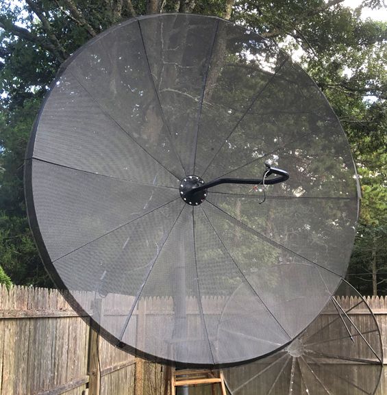

Hi All,
It is done...
Now the fun part...tightening the bolts in a set pattern as required in the manual to pull it perfectly together, hooking up the arm and then finding satellites.
Its nice to see this dish up again after sitting idle for 20 years.
A special thanks to those who offered support, ideas and said that this mount conversion was possible in the first place. :hail

Hi All,
Today I'm going to attempt to straighten the curve in my dish.
I'm going to loosen some of the arms and bolts holding the panels to the arms on the right side of my dish.
Then if I can get ahold of my friends 12 foot step ladder, do a string test. I'm thinking I'll have to remove the button hook which will be a pain in the ass to do as I had fished all the wiring through it and will have to undo that tedious work.
My wife isn't a fan of my dish hobby. Although she does understand my compassion for it, told me yesterday maybe you should consider buying a new one. I never expected to hear her say that...talk about a bolt out of the blue. I will stick with working on the RS dish a while longer, then maybe take her up on her offer. Cooler weather is moving in and I want satellite reception before the freezing temps and snow move in.
John
