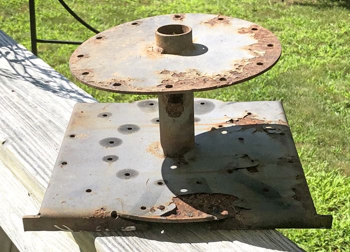

Hi All,
I took another look at my Radio Shack mount yesterday.
After also looking at rodrigocn's RS dish restoration, I'm thinking I may be able to use part of the RS mount by separating the hub from the actual mount and attaching it to the KTI mount....see arrows.
Something to ponder as its raining now.
John
Sounds like a plan. :) Looks good from here. You might have to use some spacers but it could be simple. Drill a few holes and bolt it together. :)
Reactions: JFOK
Magic,
Sure would make the dish assembly go faster and be more secure.
At least that part of my Radio Shack mount is salvageable.
Keeping fingers crossed.
John
Hi All,
Been stuck inside today unable to start the disassembly of my KTI dish due to rain.
Was studying the picture of the restored RS "hub" that rodrigocn did.
I was thinking I could cut across (see picture) on both sides of it with a dremel and get rid of the excess metal I don't need.
Hopefully mine will look as good as his when I restore it.
John

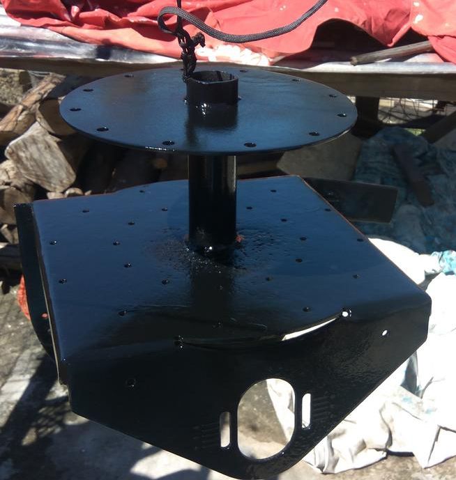

Hi All,
Success with step one...see pic.
I was able to cut unneeded metal from both sides of the RS hub.
All fingers and toes accounted for. ;)
Now the clean up and repaint begins.
Thanks again to those who chimed in with helpful suggestions.
John

Hi All,
Today I thoroughly sanded and painted my Radio Shack hub.
It doesn't look as good as rodrigocn's finished product due to pitting of the metal, but its a lot better off now.
I painted bare and surface rusted areas with Rustoleum Rust Reformer paint...great stuff. I used it when I repainted my dish tripod and its still rust free 3 years later. I then sprayed three coats of Rustoleum gloss black, which shows the surface imperfections, but still looks great overall.
I will also paint the mount the same way as soon as I get the dish off the mount. The dish is hanging on by one stubborn bolt which is soaking overnight with PB Blaster.
John
