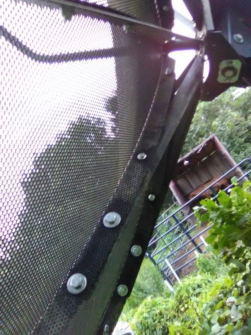

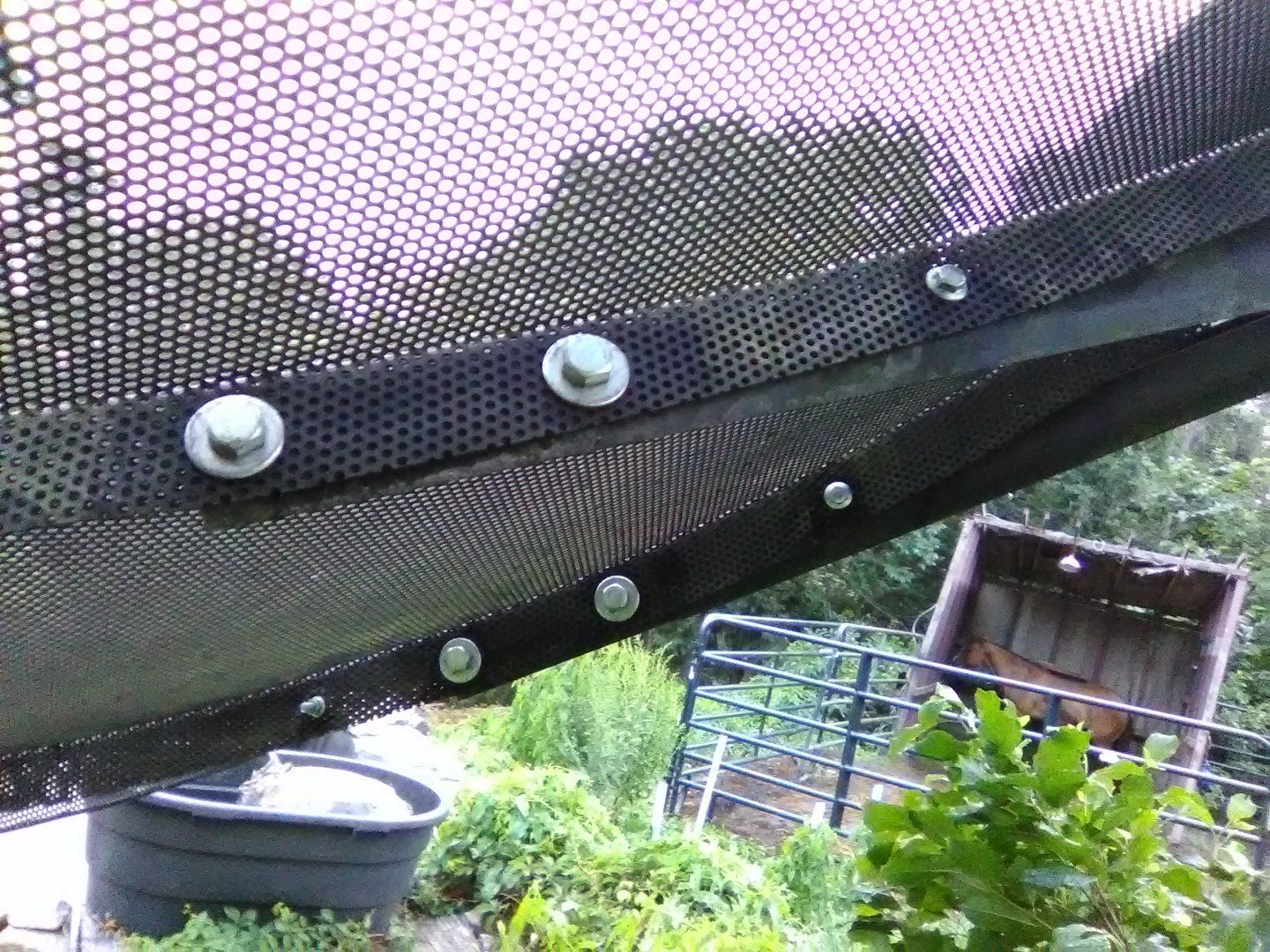

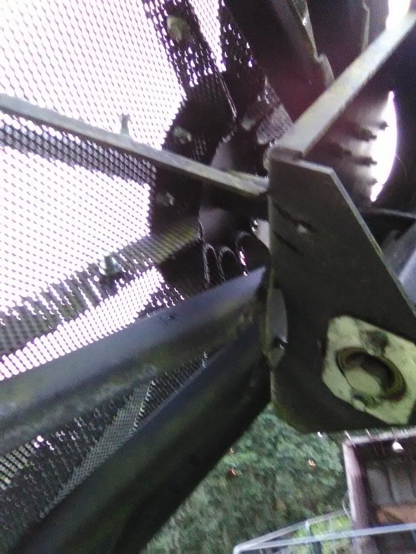

These are the arms on my dish, are yours the same?
Andy

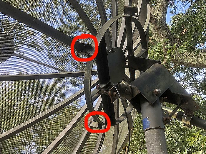

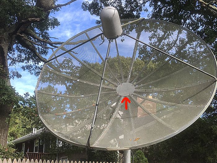

I'm attaching several pictures of my KTI mount that I hope to be able to use for this conversion.
I was thinking I could attach the mesh to the tabs I circled in the first picture. There are 4 tabs with this mount.
I'm also wondering if I did use the arms, whether or not I could attach some of them them to the KTI hub I highlighted in the second picture.
Thanks for any input Andy. Others are also welcome to offer suggestions.
John

Hey John,
I mounted my 12' conifer dish onto a mount that looks very similar to that one and it worked out good, but my conifer has square aluminum tubing framing each panel and I bolted to that tubing.
I think on your RS dish, I would try seeing if four of the arms would line up with the tabs on the mount and bolt to the arms rather than directly to the mesh, you may have to drill holes through the arms. I'd probably put on the other arms too after, even if they can't be connected to the mount, just to give it some strength.
The mesh on the RS dish is much heavier than other dishes I've seen but with a snow load on it in the winter and only four bolts points directly to the mesh, my feelings are that it could bend or tear.
Or, I'd cut the top plate off the RS mount and weld tabs on it to match up to the Kti mount, then just assemble the RS dish onto it, that would probably be best.
