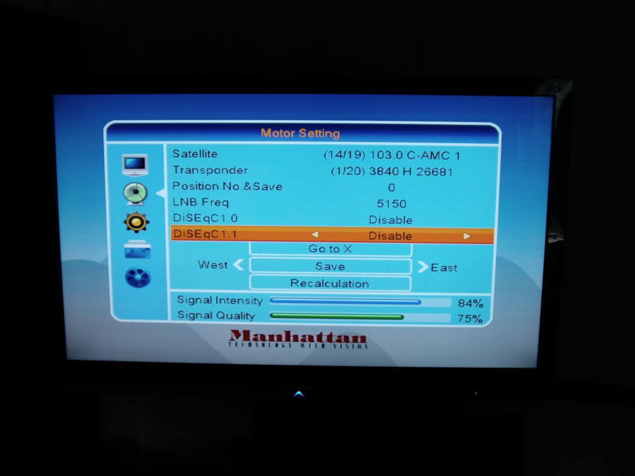

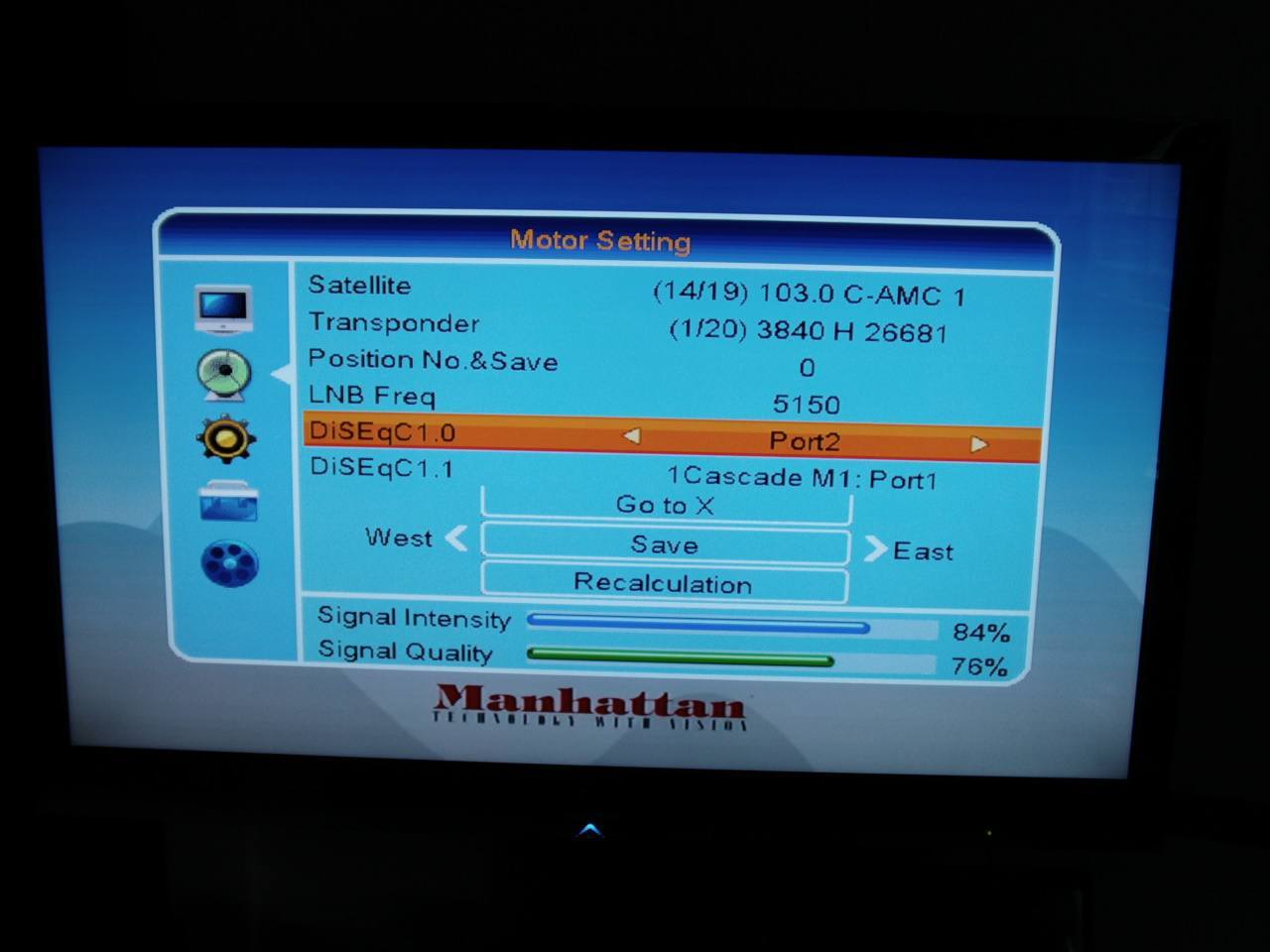

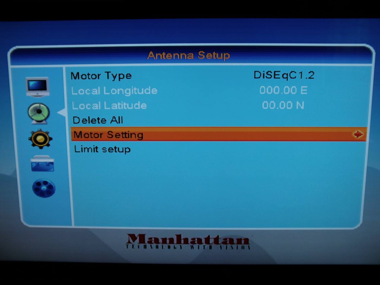

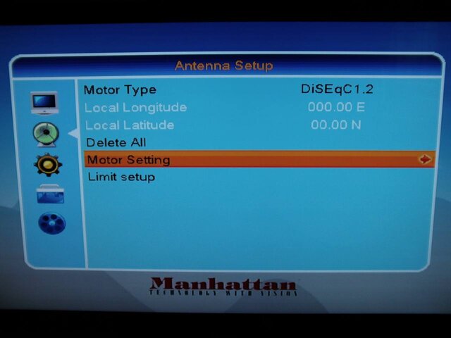

The settings are there............. How about trying that again.....Flip through those options and then tell if the receiver "don't have" them............. The receiver was set to motor, then ant setup, then motor settings.... In there you will find the diseqc 1.0 and 1.1 settings.... What is so hard about that????? Maybe someone here can eliminate my confusion......
Looks fine, but it's not what I see on MY screen, when I go to those menues. When we get the latest, we might be quite happy .. :)
