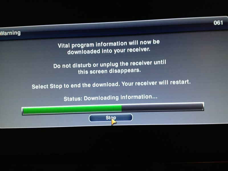

Just woke up to this... Of course, I don't want this software but it appears my HwS is on the beta testing list... Going back to sleep, hope the software isn't as bad as it seems according to this thread... We'll find out later today...
Sent from my iPhone 4S using Forum Runner
