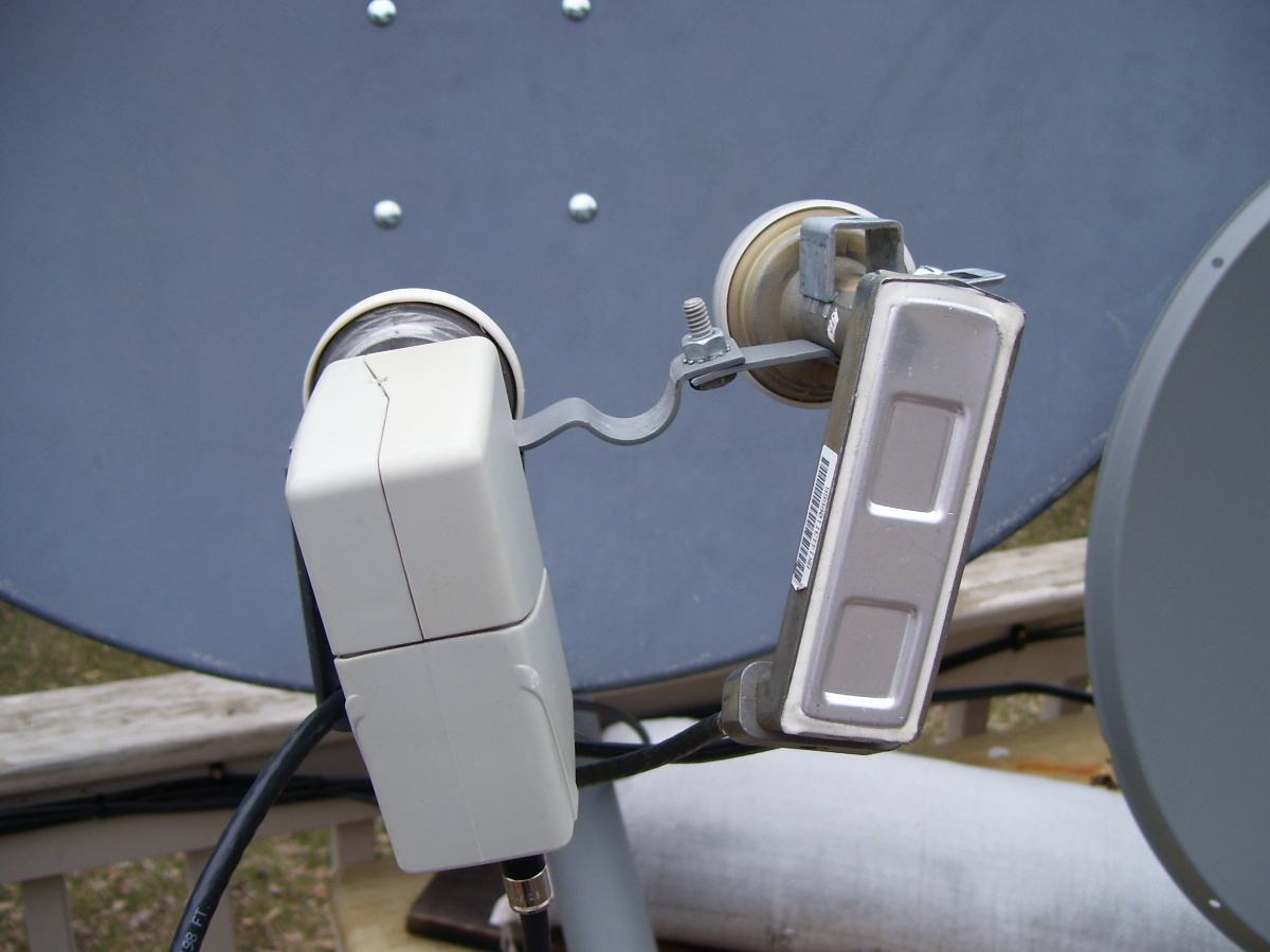

are you sure you're on the correct side of the 123 LNB?
Here is an example...below pic the LEFT LNB was on 107.3 (for my Starchoice subscription)
The LNB to the RIGHT is 119
when working with multiple LNB's they go opposite their spot in the clarke belt (due to the bounce off the dish)
