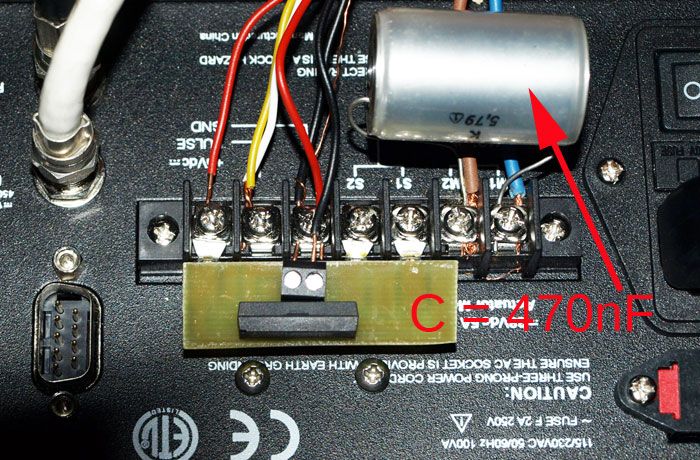

install an additional capacitor of approximately 470 nF to the motor terminals. Still glitches in the ACS 1 also takes the motor feeder. With this installation the motor runs on excessive the selected Satpositionen 100%.

Hallo
Kondensator ist direkt am Motor und einen zweiten zu der ACS 1. Es ist sehr stabil.

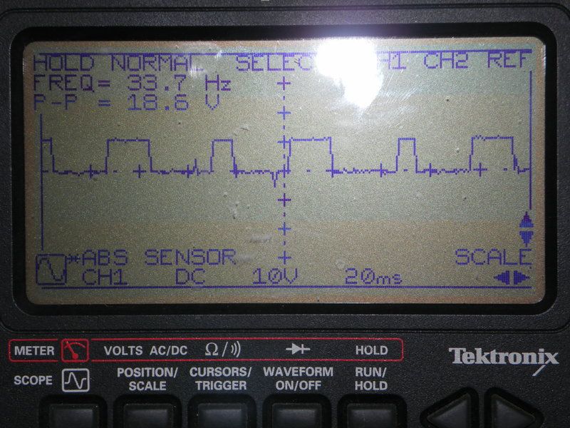

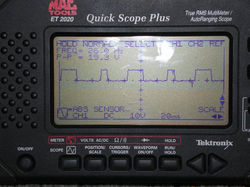

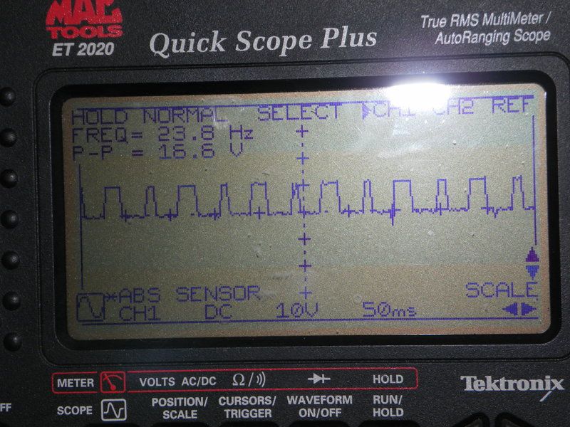

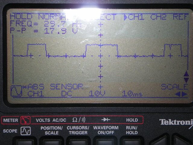

Update: I tried a couple of things. I pulled the motor armature and cleaned the commutator. I noticed the brushes were not cut straight and were barely worn in. Very low surface contact with the commutator. I dressed the brushes and now they make full contact straight on. I tried twisting the power wires and moving the .1uF closer to the motor. This was actually noisier than before. Very noticeable during Ramp up and Ramp down, start and stop. I pulled the motor again and installed the three capacitor noise filter method. The caps are about three inches from where the motor wires go into the housing. So far it appears to be working. The scope pictures are very clean compared to the others.
Reactions: Titanium and pdiddy
View attachment 99142 View attachment 99143 View attachment 99144 View attachment 99145 View attachment 99146
:( Nope that wasn't the fix, but might be part of a solution. Ponny's relay is next.

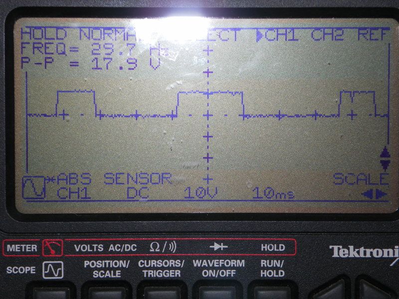

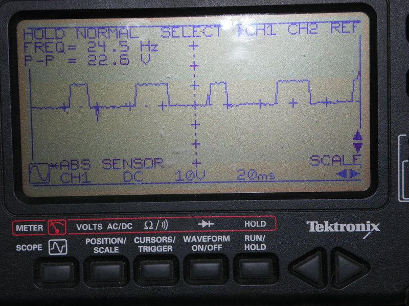

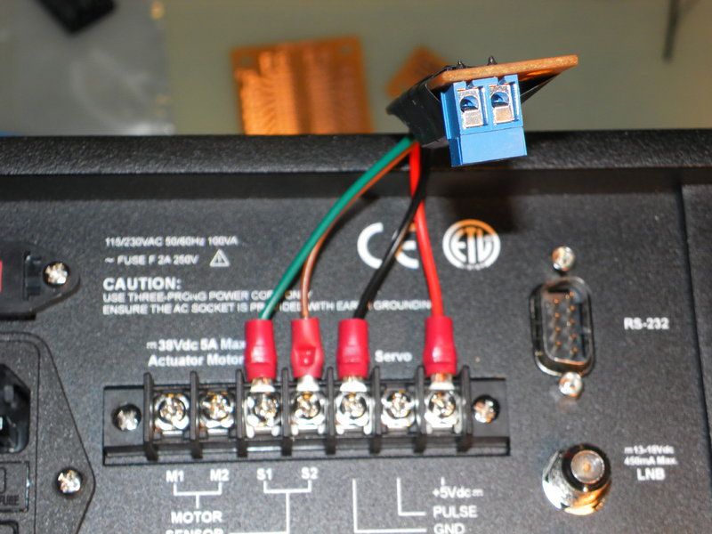

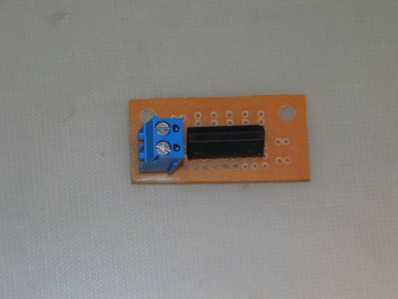

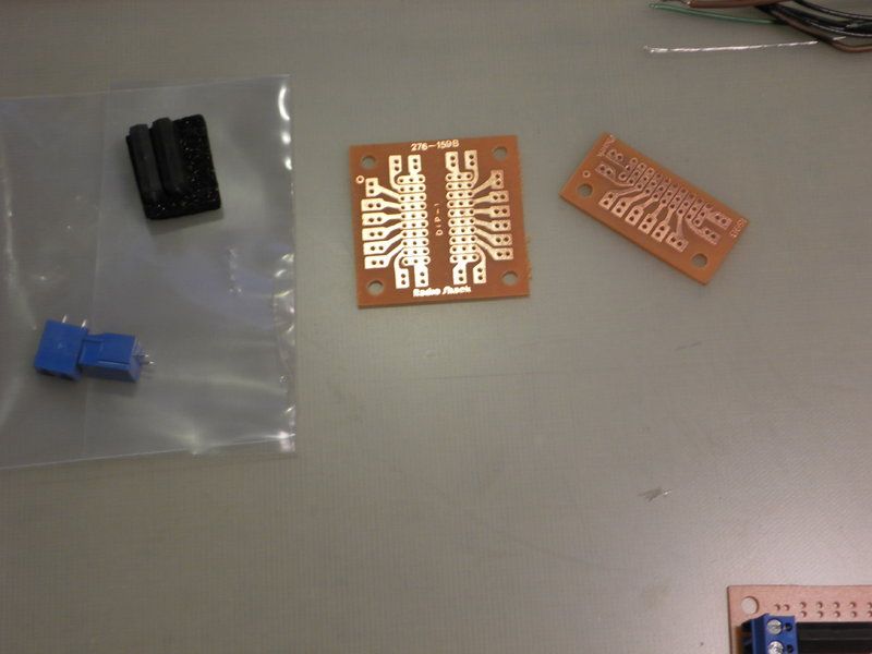

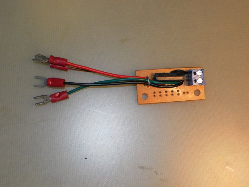

Since I'm using this relay strictly for noise suppression I configured it this way. Soon to see some scope pictures I hope.
Both sensor wires connect to the terminal block on the reed relay board. I brought the ground to the second pin on the terminal block.
Reactions: Titanium
So very close to solving the riddle of the AJAK and the ASC1, but the relay is not 100%. More research needed.
