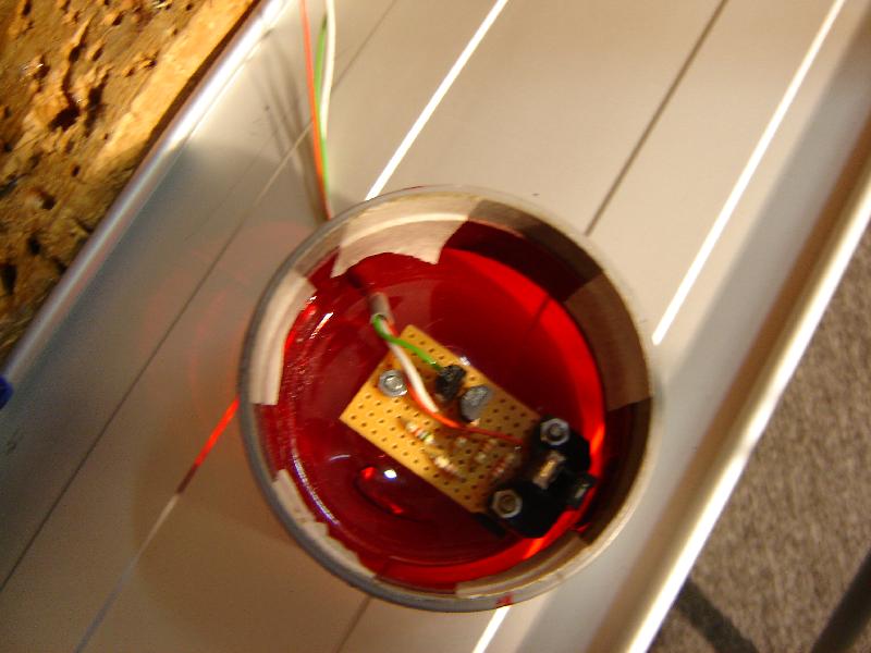

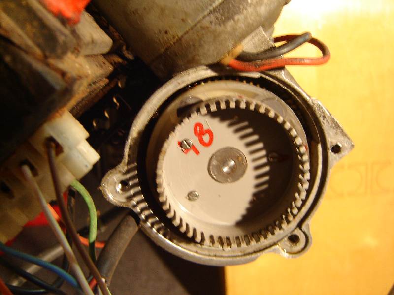

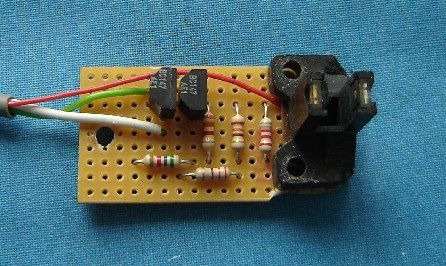

To drive a Ajak with Usals I replaced the reed-switch for a pulswheel with 48 slots (necessary to provide 40 pulses / degree polaraxis rotation) and a slotted optical IR switch .
I wonder , could such pulser be the solution for the problem with Ajak ?48 pulswheel.jpgPulser housing inside.jpgPulser housing.jpgpulser comp.side (2).jpg
I wonder , could such pulser be the solution for the problem with Ajak ?View attachment 100320View attachment 100321View attachment 100322View attachment 100323
Very nice modification!:clapping Can you provide any detailed info on the parts you used for this mod, schematic for pulse circuit, etc?:)

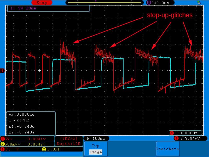

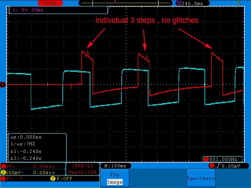

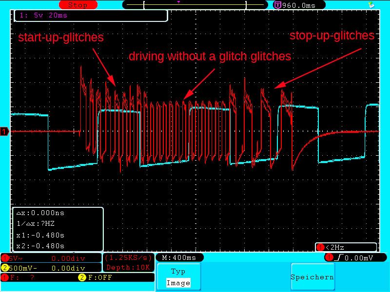

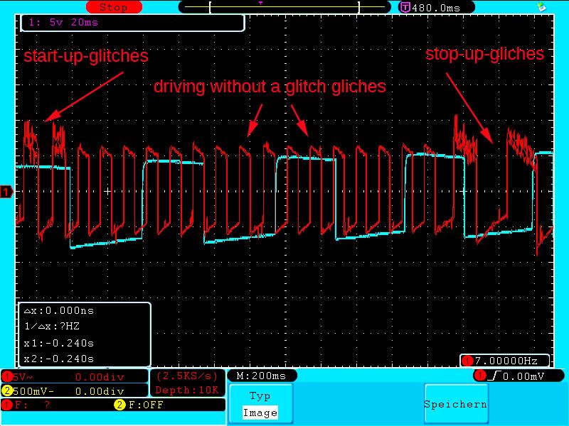

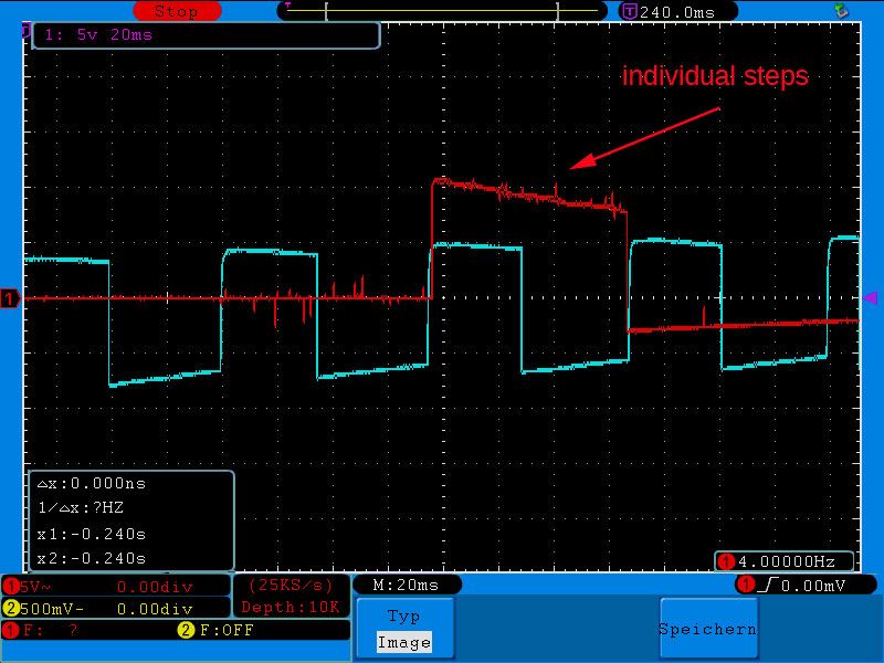

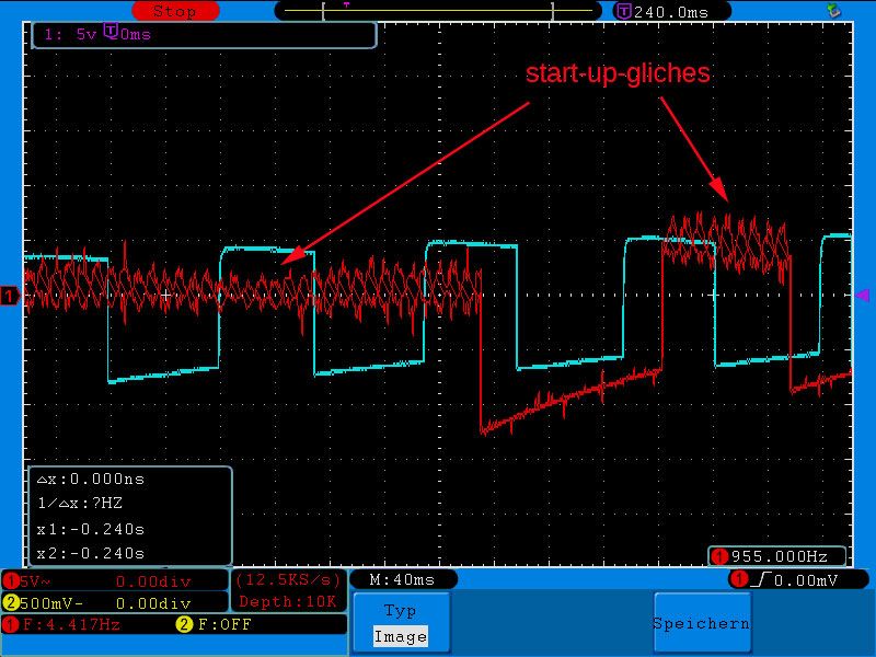

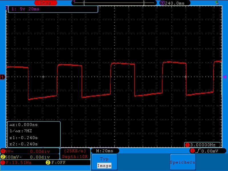

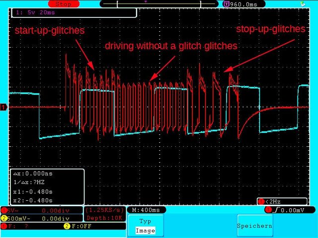

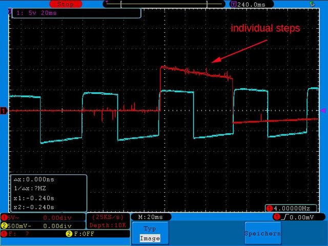

Hi,
after many tests I was investigating probably the cause of the incorrect counting of pulses. Look at these pictures in the annex you the oscilloscope. During the starting and stopping of the motor voltage is regulated. In the the interference caused the period of the scheme. The single step, the voltage is not regulated, but is maximum. These counts are without errors. You can see this on the screen step. You would have to test a software in which this rule does not exist. The V-box II or G-box also controls not the voltage at the start or stop. Still not counting errors occur.
Ponny
I have been communicating with Ponny about this matter and he had provided this data earlier on the week. For those that don't know, Ponny is a Titanium Satellite reseller in Germany. We are providing him test firmware next week with no ramping (power regulation). Since the issues cannot be replicated on our equipment, Ponny has been testing various firmware with his system. He is passing this information to update other members with our emails.
The firmware since 20140401v1 received sensor counts after motor voltage termination for a few seconds and works with our bench motors and Ponny's low current draw motors. Ponny pointed out in an email that this voltage regulation testing was noted on high current draw motors, but not with low current draw units. The highest current draw motor on my bench is 2.5 amps and Ponny is testing with 4 amp draw. This could be the difference in our bench testing.
