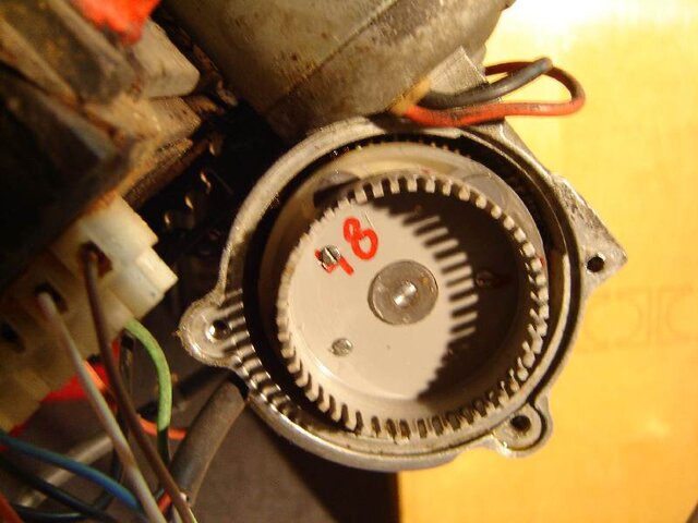

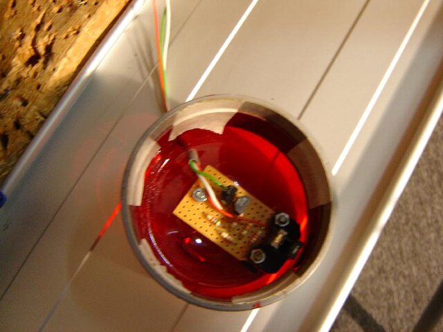

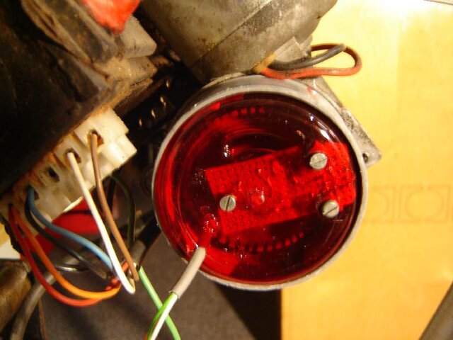

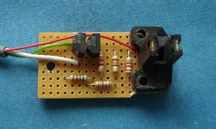

To drive a Ajak with Usals I replaced the reed-switch for a pulswheel with 48 slots (necessary to provide 40 pulses / degree polaraxis rotation) and a slotted optical IR switch .
I wonder , could such pulser be the solution for the problem with Ajak ?48 pulswheel.jpgPulser housing inside.jpgPulser housing.jpgpulser comp.side (2).jpg
I wonder , could such pulser be the solution for the problem with Ajak ?View attachment 100320View attachment 100321View attachment 100322View attachment 100323
Very nice modification!:clapping Can you provide any detailed info on the parts you used for this mod, schematic for pulse circuit, etc?:)
