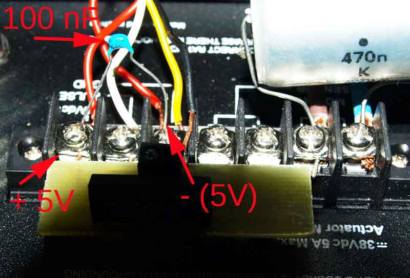

Hello
the pulse converter comes in addition to between + 5V and ground a ceramic capacitor of 100 nF to block off the 5V.
I'm about 50 times the position-0633 75° E ABS1 to + 0273 7° driven W NILSAT 201 without error. The counter excessive agreed 100%.
Ponny

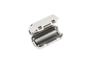

Hallo
Ich hatte immer noch einen Filter für die Motorkabel an die 100-nF-Kondensator. Ob dies notwendig ist, sollte sogar extra getestet werden.
Es ist jetzt ein Vergnügen in der Verwendung des ASC-1 ein.
Ponny
English Translate:
Hi there
I still had a filter for the motor cable to the 100 nF capacitor. Whether this is necessary, it should even be specially tested.
It is now a pleasure to use the ASC-1.
Pony
