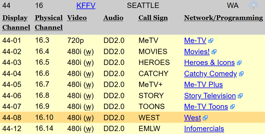

You live just 5 miles from the KFFV over-the-air (OTA) transmitter in Seattle with a METV channel mux . I receive a relay of this channel mux and it contains much of what's on the 101W Weigel channels. Wouldn't it be easier to receive this OTA with a simple antenna than 101W? Here what you can receive via OTA:
