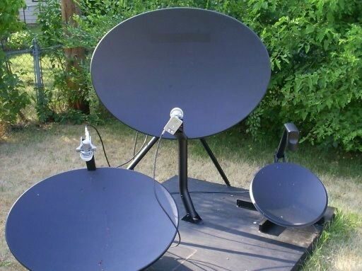

i have put a linear lnb on the prime star dish trying to git g11 here in rush springs oklahoma with pansat 2700a havent got it done yet
Make sure you are using the below angles, then if you think you are close to a satellite try a Blind Scan.
Best way to find a satellite is to enter a LIVE transponder from the satellite and watch a small TV at dish for signal QUALITY only as you slowly move the dish, pausing for 3 seconds every few millimeters.

been out working on this prime star dish got level of 90 quality none diseqc 3
there really isnt much on G11. Couple screens with color bars.
Is there a channel on there you were looking to get?
not much on G11. Next door on IA6 (93W) there are some news feeds and such
G10 (123W) has the most English channels
never did git g10/ku butfound amc 10/c amc 4/ku amc 1/ku amc1 c g11/ku pas 3r/c pas 9/c but no G10/ku have a megasat ms1075 ku band LNBF on a prime star dish with pansat 2700A
