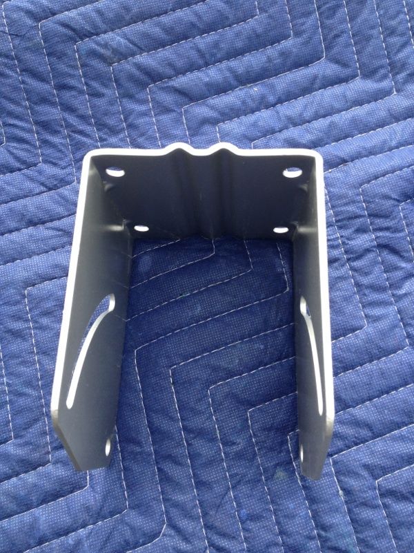

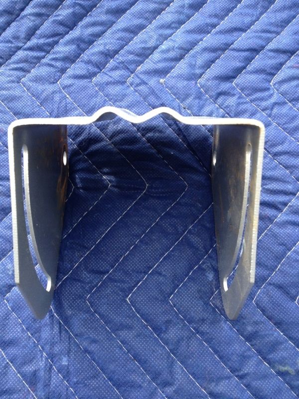

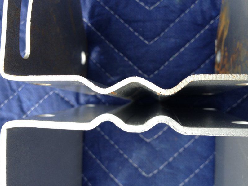

The bracket is better. Pic of 2100 then 6100.
Once I find the other tool box I will post the thickest of each bracket.
