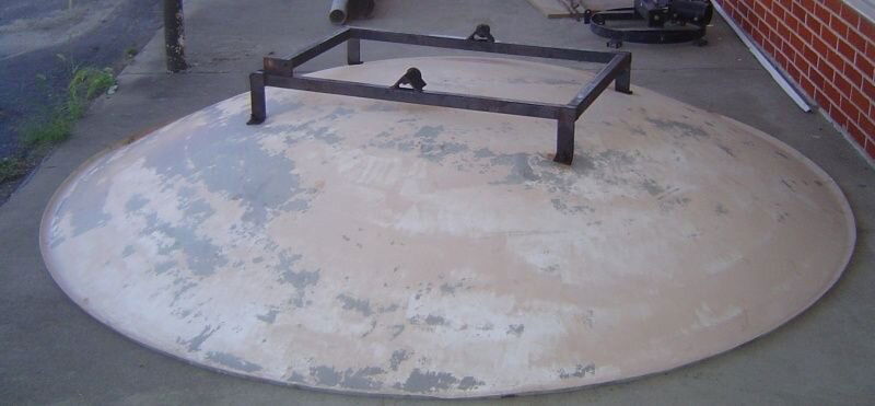

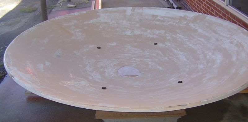

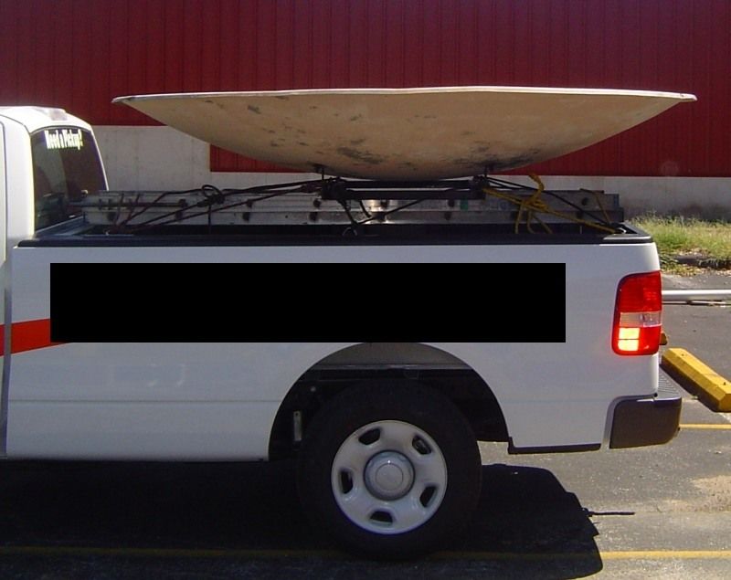

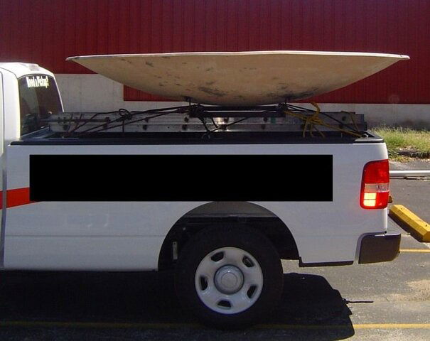

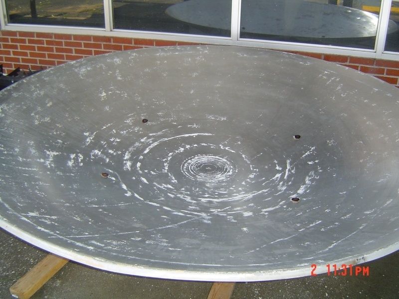

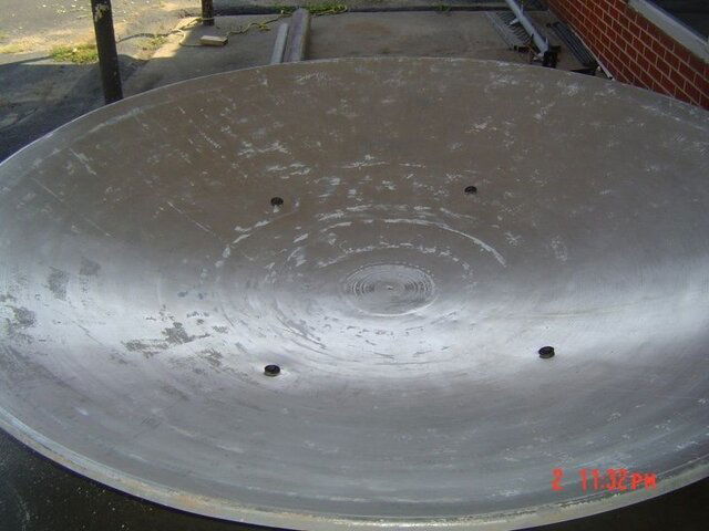

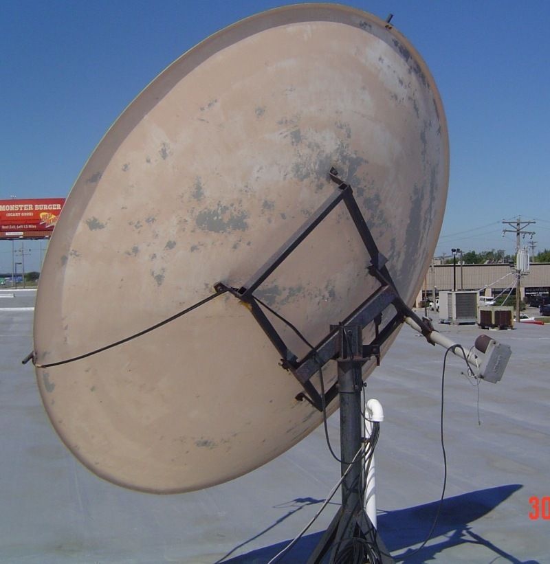

Here are some pics after we got it home today:

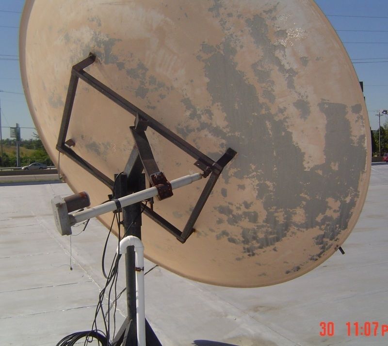

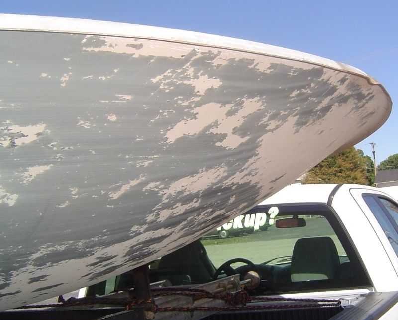

Like to never got it off the roof. It had sat so long in one position, the pivot pins at the top and bottom of the rectangular mounting "ring" were rusted solid. We spent an hour rocking it back and forth with PB Blaster, and inching it up out of the bushing sleeves. The sleeve on the bottom actually came out instead of the pin coming out of the sleeve. So now I have to get a gear puller and see if I can get that off, and polish everything back up and put it back together.

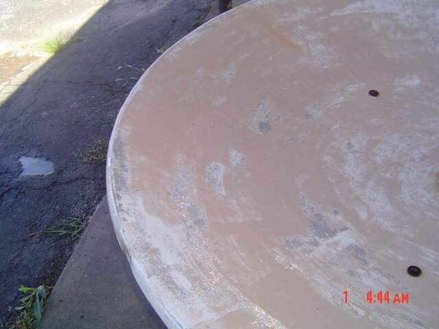

Still can't find any ID, and the last picture above is the section where the name should be like on Diamond Jim's Regency dish. I think what happened is that the original white paint started coming off, and the decal with it, and someone took some latex brown and applied it with a roller and brush just to get the shiny covered again.
As you can see from some of the pictures it is spun aluminum. It is pretty smooth on the front side, but I can feel just a tiny groove in between each ring on the back side.
I put the string on it after I got it home, and it all looks good. The depth is 14-7/8", and the diameter is 7'-6.5" which according to my online calculations gives me a F/D ratio of 0.44 and a focal distance of 45.2".
This is an extremely flat dish. The Birdview was a 0.42, and I thought it was flat. This one should have extraordinary gain if I can get past any side-lobe issues that may arise.

I got a product from Lowes today called Klean Strip. I was attracted to it because it was a spray on solution. Comes with a little sprayer bottle. It works pretty good, but I learned a lesson. Spray it on thick. I made the mistake of spraying it on until wet. That's not good enough. It has to be a thick layer.
That's probably why all the others are brushed on. I spent about 5 hours on it today. Spraying, waiting, scraping etc. That was on the front side only. I haven't stripped any paint since I did an old studio upright piano when my wife and I first got married 30 years ago. I remeber saying then that I would never strip another object, and now I remember why I said it.
I am not going to strip the back side. Just remove loose paint, and paint over it.

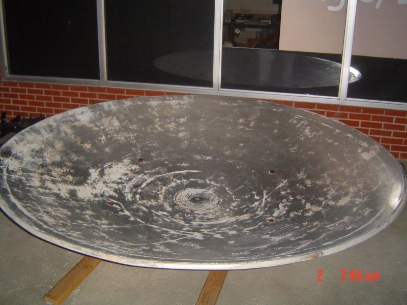

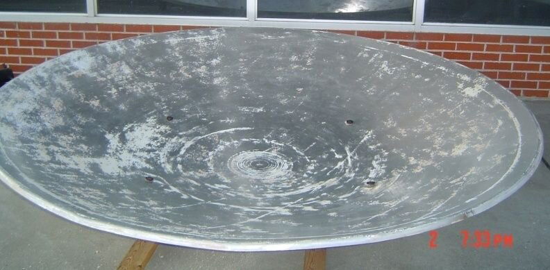

It is coming along nicely. It is almost dark now, and the picture doesn't do it justice. The dark gray you see is the bare aluminum, and is much brighter in the light.
The stripper doesn't bother the aluminum at all. I am going to give it one more coat in the morning, and hopefully that will be it.
Here is a pic:
Where it is bare, it is as smooth as a piece of glass except for the barely discernable ridges where the spun effect is. That's what I want is that smooth surface. Not that it will get any better signal, but it will look a lot better, and it will drain water a lot better.
Fred
Well I am quitting. I ran out of stripper, and don't want to buy more for the few residual spots that remain. If I had a power washer, they would have come off this round, and maybe the round before.
The few spots that are left will just be part of the new paint job, and never be noticed. They are at least as smooth as paint is anyway.
I took another shot this morning in better light before I started the final round, and then a couple after I finished. I tried to get what I see, but couldn't get the camera to cooperate. The dish is very bright and shiny in the light, but it won't capture on the camera very well.
Here are this finished product pics:
It is going to be a very nice dish. Very few imperfections in the aluminum at all.
Fred

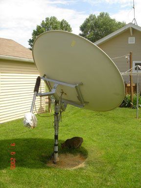

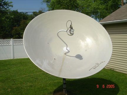

Fred,
Here are the photos that you wanted to see. You don't have to look close to see the difference between the two dishes. I hope this helps you out.
Thanks Jim,
After looking at the two pictures you provided, and the pictures of my dish, along with the 7.5' diameter measurement you PM'd me, it is evident that mine is not a Regency dish.
Now that I look at the mount on the back, there is a difference in them besides mine not having a button-hook.
Here's another pic of the back of mine for comparison.
Now just need for someone to help identify what it is I have got. :D
Fred
Fred,
Just for the record, the Regency dish were a light brown/tan colored. That is the origional paint job on mine. The silver spots on the lower left is some spilled navel jelly. I was using that to take the rust off of the button hook and I dropped some of it. I ask my satellite guy about it and he said let it go. That's been about 10 years ago and everything is still working fine. If you think that dish was white, it could be a Birdview or a Horizion.
