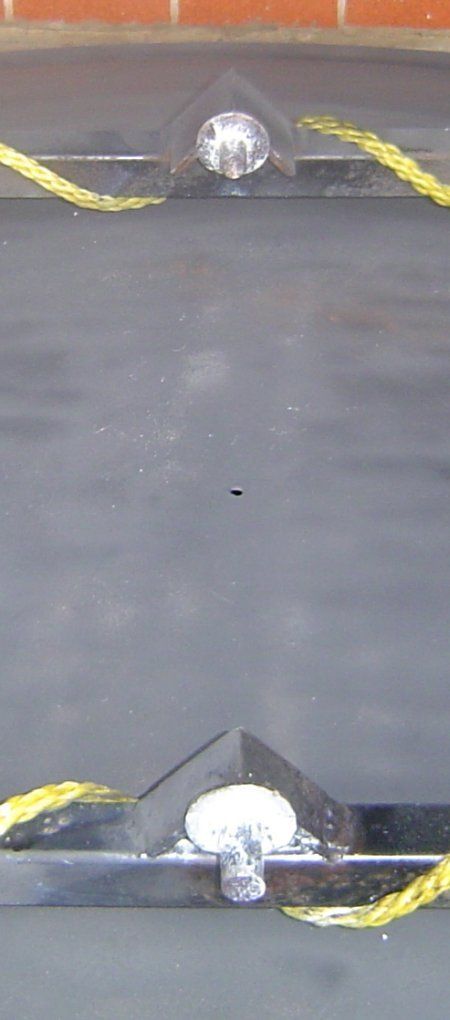

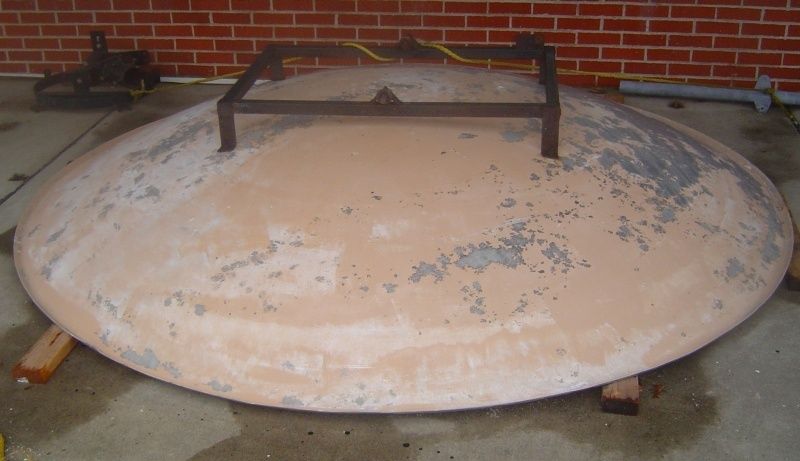

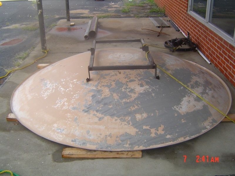

I didn't want you guys to think that I have been slacking off.
I have been in the process of painting and getting this dish ready to mount. It has become a lot of work, but I think it will be worth it when it is finished.

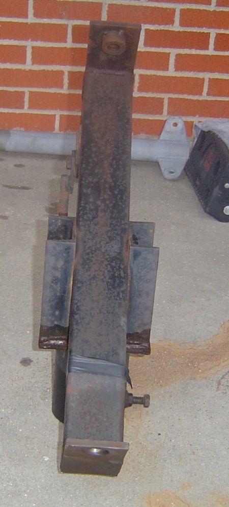

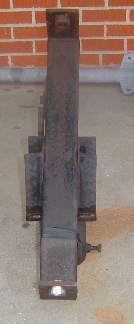

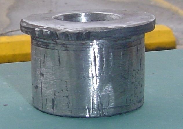

The biggest problem was with the sleeve/bushing that fits on the bottom pivot pin. When we took the dish down, the bushing was rusted/frozen solid onto the pivot pin. The manufacturer did not tack weld the bushing to the elevation bar like they did the top one, so we slid the bushing out of it's hole which itself was an hour long job.
So I had the job remaining to get the bushing off the pivot pin. I made 3 different attempts of about an hour each with my little Propylene torch to heat the bushing and try and pop it off the pin. You have to remember that the dish is now on it's face, so you can't put too much weight on it, plus, when using a pipe wrench, hammer, chisel, and other tools, you can't apply too much pressure, or you might warp the dish. You also have to keep the heat away from the dish or you might end up with an aluminum puddle.
I ended up having my machine shop buddy come down with his oxy/acetylene cutting torch. We had to turn the bushing cherry red and use lots of incremental tapping with chisel and pry bar to get it off, but it finally came off.
After cleaning it up with my dremel and cleaning up the pivot pins, it is almost good as new. I am going to take the elevation arm next door and tack weld the bushing to the elevation bar like it is supposed to be.
The back side is now painted, and the pivot pins are all greased up. I have before and after pictures along with the elevation bar with and without the bushing in place to show you what I have described above.
Here are the pics:
sleeve-bushing-2.jpg without-sleeve-bushing-better.jpg with-sleeve-bushing.jpg
back-after-paint-2.jpg back-after-paint-3.jpg pivot-pins-polished-greased.jpg

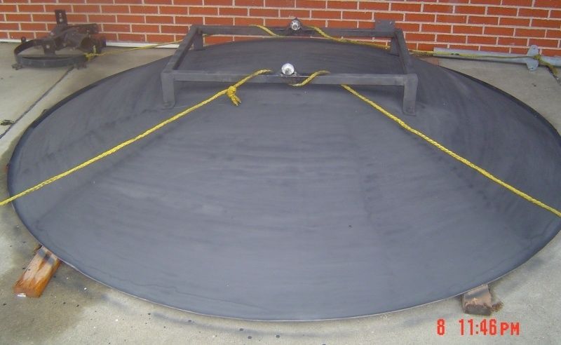

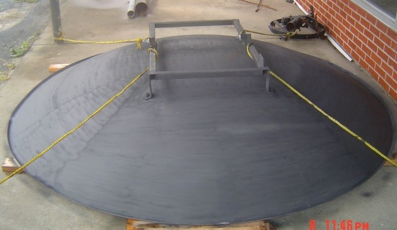

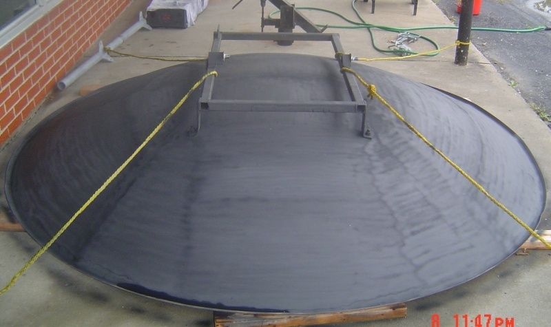

I used the Wal-Mart $.96 per 10 oz. cans of flat black for the back (took 20 cans). This is the first time I had used this brand and I wasn't too thrilled with the result. I have always used the $.99 10 oz. cans from Lowes and I have never noticed the striping effect that the pictures show.
Has anyone else run across this problem painting with cans?
I'll know if it was the paint or my technique when I paint the front. I will be using Rustoleum dark Charcoal Gray automotive primer for that.
I need to invest in a real paint sprayer, and start buying the paint by the gallon. :)
I'm now ready to start painting the front.

Well, while you are busy horse-trading, I have a few questions...
About those tie-down ropes on the dish.
Did someone repeal the law of gravity around there , and you were afraid the dish would lift off like an alien space craft? :rolleyes:
Or do you just have big enough gusts that you thought it might?
As to your dish-painting skills, . . .
I'd say you held the can too close or move it too slow.. or both.
However, it's covered, it's on the back side, and after 5 years of weathering, nobody will even care!
Heck, I already don't care! :cool:
Looks great to me!
You got me rolling on the floor Anole.
I thought maybe it was my painting skills that were the problem. I'll try to do much better on the front side.
And thanks!
As to the tie downs. Yes, when a thunderstorm rolls through here, we have had in-line winds of up to 60 MPH just a few weeks ago, and last year had 80 MPH in-line winds during one thunderstorm. The second reason I tie it down, was especially while the bright aluminum is showing is to let the scrappers know that it isn't scrap and that I have it tied down for a reason.
Once I have the front side painted, the tie downs will only be for the possibility of wind.

Looks good Fred...........you're really pulling out all the stops on this dish! If I had to make a guess as to the painting problem, I'd say probably just the lack of control available with spray cans.
I recently painted a new exterior door for my house. On the outside I used an inexpensive sprayer purchased from Lee Valley tools (here in Canada) http://www.leevalley.com/wood/page.aspx?c=1&p=20048&cat=1,190,43034&ap=1
It worked really well with some enamel paint thinned with laquer thinner. On the inside I just bought some cans of automotive enamel. It seemed like the spray coming out was so fine that between strokes, the first stroke had already dried and the 2nd coat didn't properly "meld" with the first one and it left lines in some places similar to what I see on your dish. With the air powered sprayer I had much more control. The paint was nice and even and glossy. For the price of the sprayer ('bout $50 CDN) it was well worth it, if you already have a compressor. Oh, and I'd also recommend a water filter on the air line. And it's easier on the finger than a spray can!
