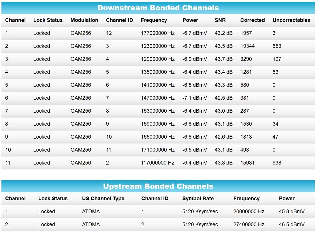

Knowing an engineer has given me a lot of knowledge. I get phone calls from him to try different things here for him. I'm way out in the sticks. In my image is a screen shot of my Arris modem status screen. When I have issues here that's where I go.
Initially with the 50meg package I saw 2 channels down that would increment uncorrectables in the order of tens of thousands every time I refreshed the page. Long story short. ISP sent field techs. Phone support didn't get it. I got new coax from the pole to the house. Signals levels were checked. But my 50megs was still in the 20's. I texted Isaac a screen shot of the modem status.
And within a few minutes after an "OH THAT" reply I was getting what I paid for.
