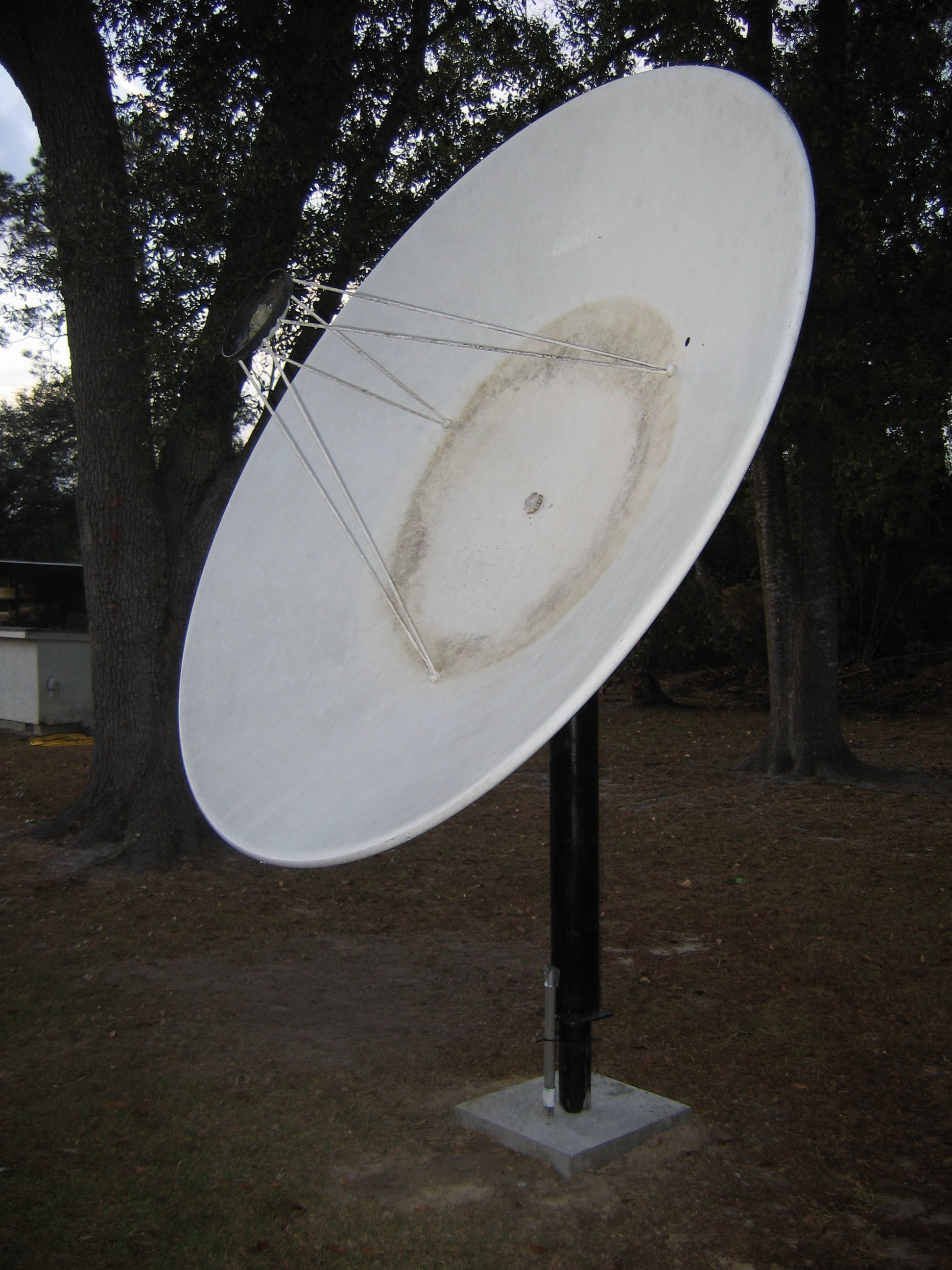

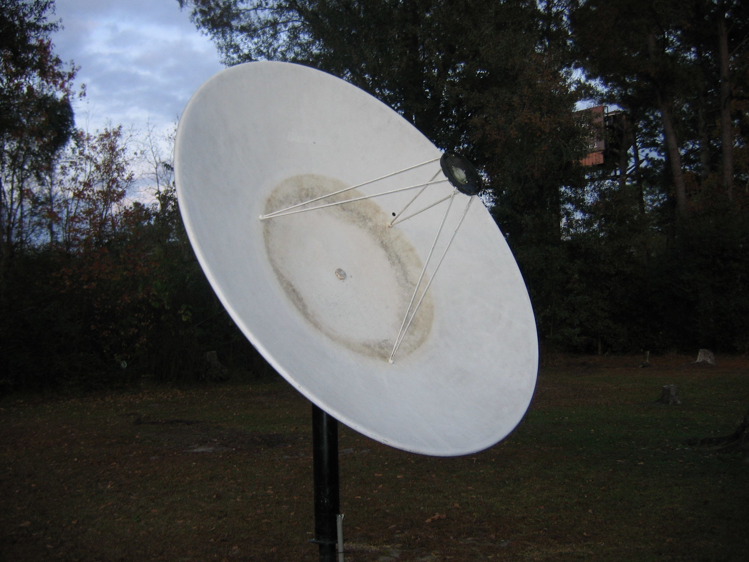

stogie5150's Birdview install
Looking good, stogie. I know a guy that is going to be doing this same deal pretty soon (I hope :D ), so be sure and post your details and pics.
Lots of details and pics! :)

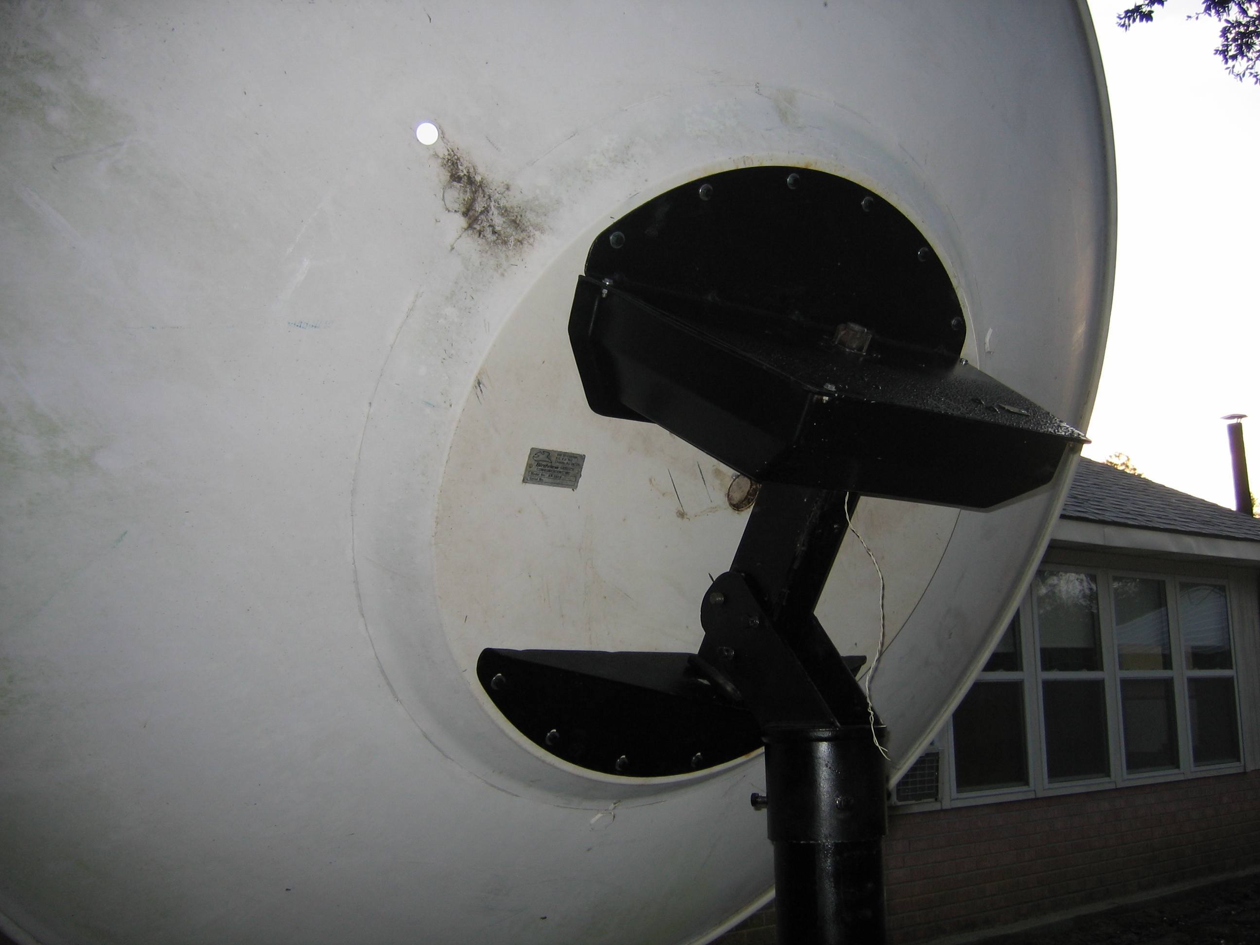

Well, now I have some cleaning to do....my nephew and I put it up in about 10 minutes....I have one boss with a bolt broken off in it, and one boss with no insert at all. :(
I have ez-outs though, but it being like it is I don't know if I want to fool with it, if I mess up the helicoil and insert, I don't have the tools to fix that....

I had 2 broken bolts in mine also, the 2 that are furthest to the right on the bottom, is that the same ones you are missing?
I drilled them out (no ez-outs) and was considering going oversize (1/2" instead of 3/8"), but am now leaning towards helicoils, both bosses are still in place in mine, we'll see.

Yep, that's the two. the outboard one is the one that is broken off, there are some threads usable, so I stacked up washers on the bolt until I could snug the dish up against the mount. The second inboard has no boss at all, its just a hole. Having extensive experience with aluminum and helicoils, fixing that is tricky, at best, even if you have the tools. If I had a TIG welder handy I could work something up, but I have no TIG welder handy, so if it works I'll have to leave it like it is. I THINK as long as the dish is tight against the plate it should be okay, someone please correct me if that is not correct. :)
If I had an idea what the bosses looked like and how they got them in there it would help, but I am sure that knowledge is long gone with the closing of the Birdview factory. :(

Is the hole in the dish smaller than the external boss diameter?
I thought that the bosses may have a shoulder, and possibly a fine "spline" (like an automotive lug bolt that you drive into an axle or hub), and they are a press/drive fit. :confused:
I assume the bosses were installed before the "ring" that they are installed into was installed onto the main dish, so they may have some sort of spot weld also?
I had also considered using some kind of expansion anchor if all else failed, and I had to have something to make it work.
You are likely correct that as long as the plate is flat you can do without a bolt or 2.
On the Perfed dish where you can see the the inside of where those bolts come through the backing plate. Two of mine were broken off, and when we tried to drill them out, the "boss" came loose.
The "Boss" turned out to be simply a square nut on the inside that was tack welded to the backing plate. The actual pressure of the bolt holds them in place. The tack is just a holder.
My welder simply welded a piece of all-thread to the backing plate in the hole and those two bolts are now studs sticking out with nuts on them instead of bolts going into the hole.
The welder welded mine with a mig and flux-cored steel wire. There is no reason why they held, but did, and still are. :eek:

Well, since the dish is aluminum...
that washing tub welded on the back side has to be aluminum ...
So, are the nuts aluminum as well?
How else would they be tacked to the wash-tub?
(I'm obviously wrong, so please clue me in)
If I can catch up with my machinist this weekend (may see two of 'em), we'll brainstorm and see if we can come up with a repair technique worthy of the Bird.
I'm thinking about some trick with epoxy, or those internal expanding wall anchors. . .

Wall anchors were the first thing I thought of, Anole. Problem is finding one stout enough. The wash-tub isn't very thick, perhaps .050 or so, MAYBE .090 at the most. So any type of big time pressure is gonna buckle that thin stock its made of. A screw in type of thing would work, but,like I said, its SO thin, there isn't much to hold onto. And mine is aluminum, also, as phlatwound said above. I thought about a nut plate of some kind, drill the hole bigger, and put the nut plate THROUGH the hole and rivet or screw the nut plate in place INSIDE the wash tub, with two screws/rivets, thus allowing a bolt to be installed. I am going to visit relatives tomorrow so I won't be around but Saturday I will take some closeups for y'all to look at. Right now a wall anchor would be a quick and dirty solution. I don't know how permanent or secure that would be.

stogie, the anchors I was thinking about are actually for masonry/concrete. There are 2 common types, wedge and sleeve. Wedge are used more for solid concrete, sleeve are typically used in concrete block, and would be more likely to work in your application....they are much stouter than "wall anchors" (if you are talking about sheet rock anchors).
Someone told me that there is an expansion-type anchor specifically for use in metal, but I have never actually seen one.

Sleeve anchor might work. Wedge won't, I don't think.
First pic is sleeve anchor, second is wedge, for illustration.
