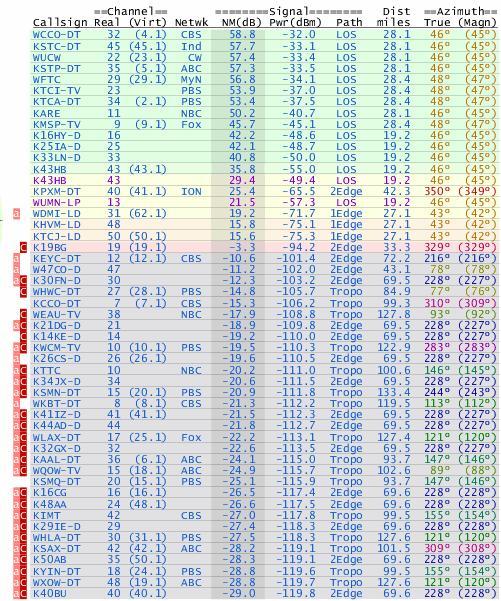

also to check your OTA options try tvfool
TV Fool
it allows you to plug in your addy or lat/longitude and shows all the stations that you could pick up and where the antenna needs to be pointed. Like as example here is mine.
As you can see pretty much all my stations are in the same area (45 degrees) and how strong the signals are at 40 feet above ground (which is how high the antenna is)
