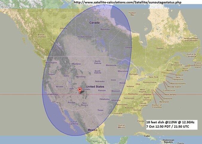

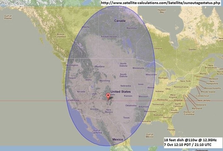

I have also made a tool at www.satellite-calculations.com/Satellite/sunoutagestatus.php which can plot the area affected by potential sun interference as it happens.
Does not work well in MSIE8 or older but as long as 60s or 30s updates is used it seems to work in most browsers.
Here is screenshots from 110W 7 October 12:10 PDT:
Here is screenshots from 119W 7 October 12:50 PDT:

Thanks for that, very nice work.
